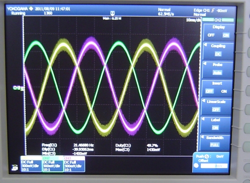

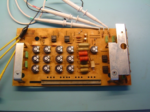

If you want the least noise then yuo simply have to trim the phase for each motor, the nominal value is never that quiet. Also i find that equal voltage on both phase = less noise and if you load the motor, (with thick bearing oil in my case) the drag swamps the cogging and smooths out rotation further.
Second that. See attached the fully adjustable sine wave generator and scope shot of the output voltages (after adjustment) of my 30 year old EMT 928. Yes, its not their top model but it does an excellent job. And the adjustment is really important.
On a side note, for large (three-phase) motors in industrial installations, imbalances between the phases translate to torque ripple - guess why the utility companies have introduced regulations for minimizing the imbalance 😀
