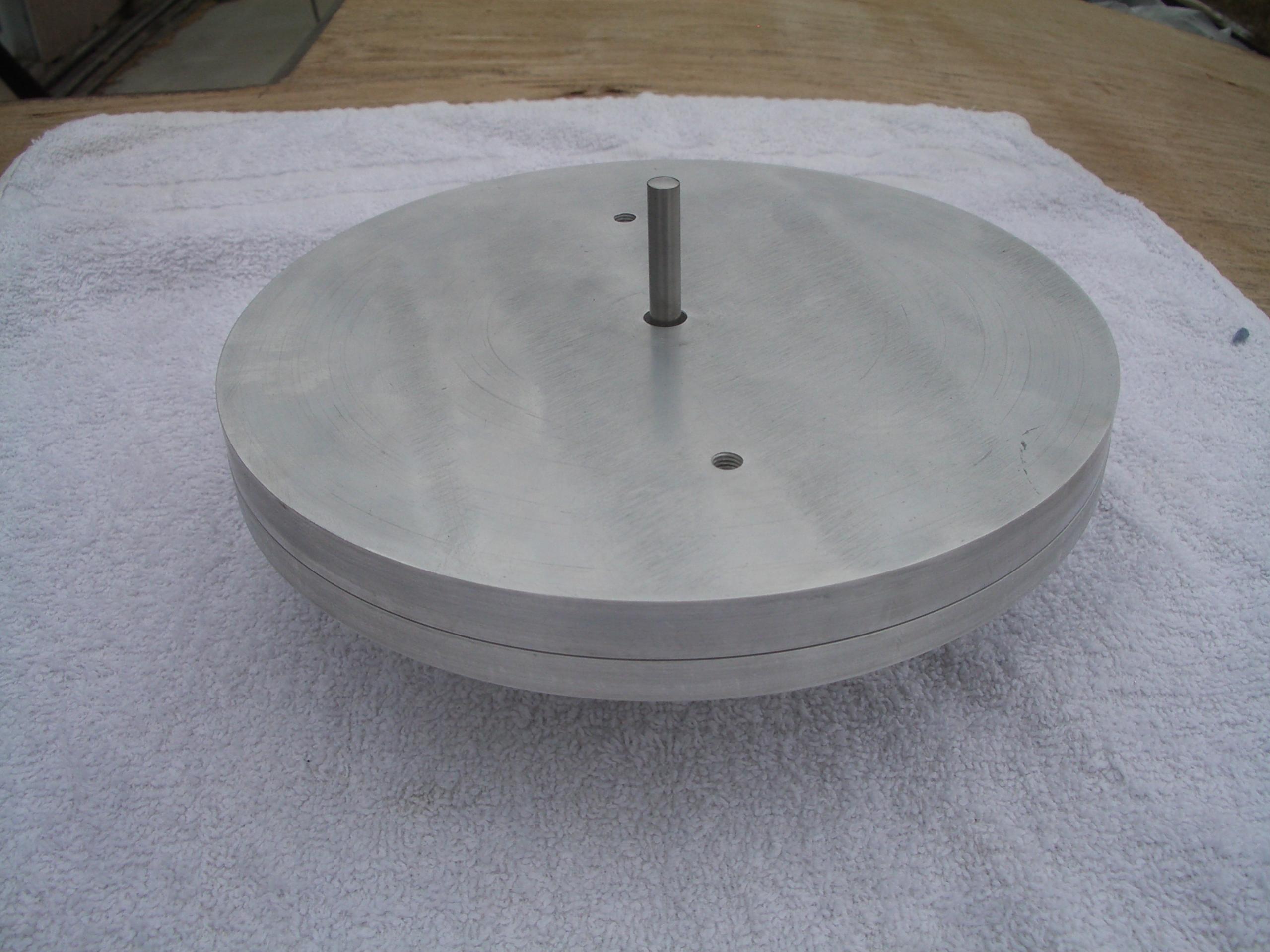

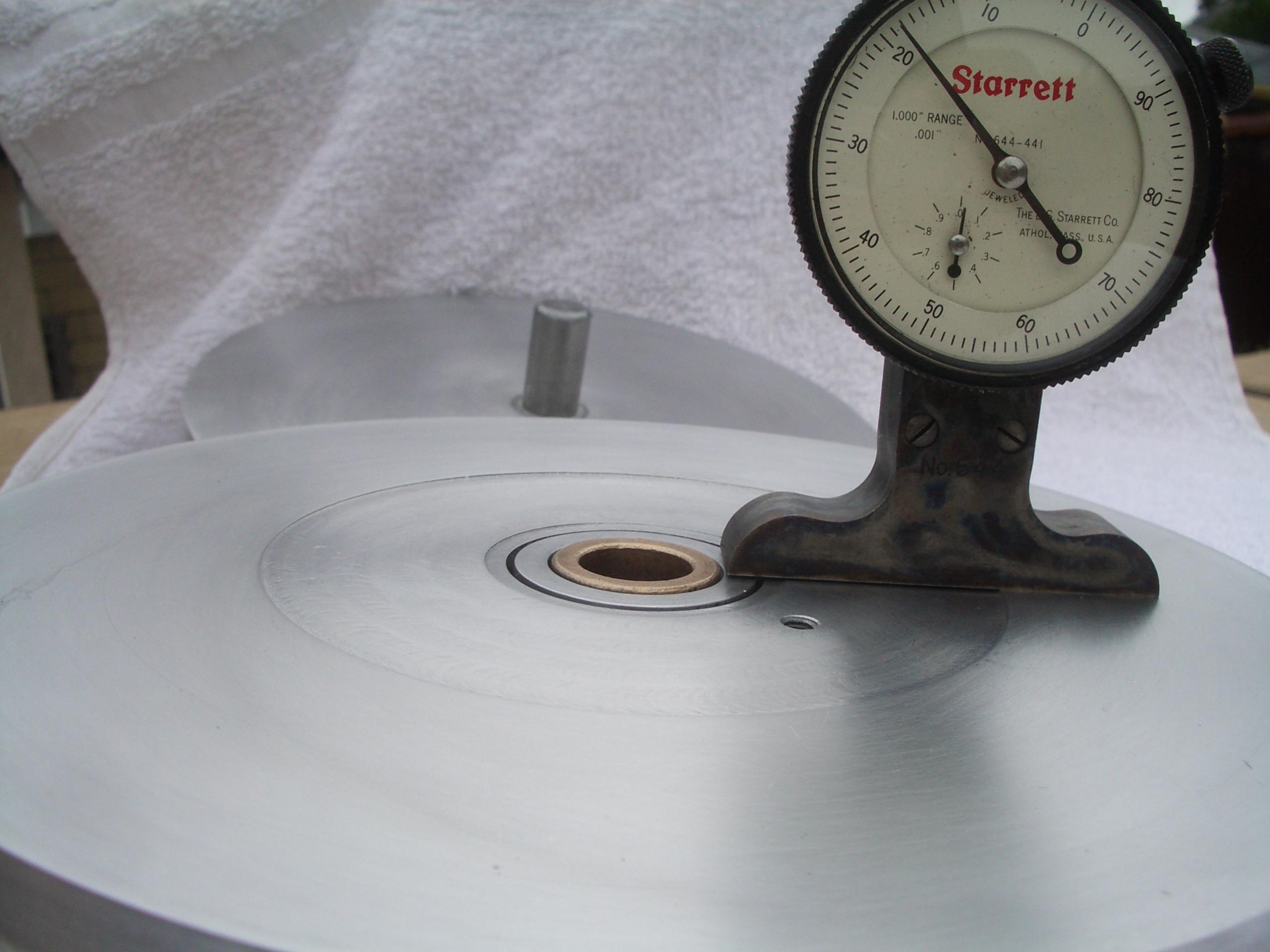

If you wish to do this the air trough is .020" deep
the area across for support is 1.95 "wide
and the total width is 8.200" across
All this needs to be hard anodized

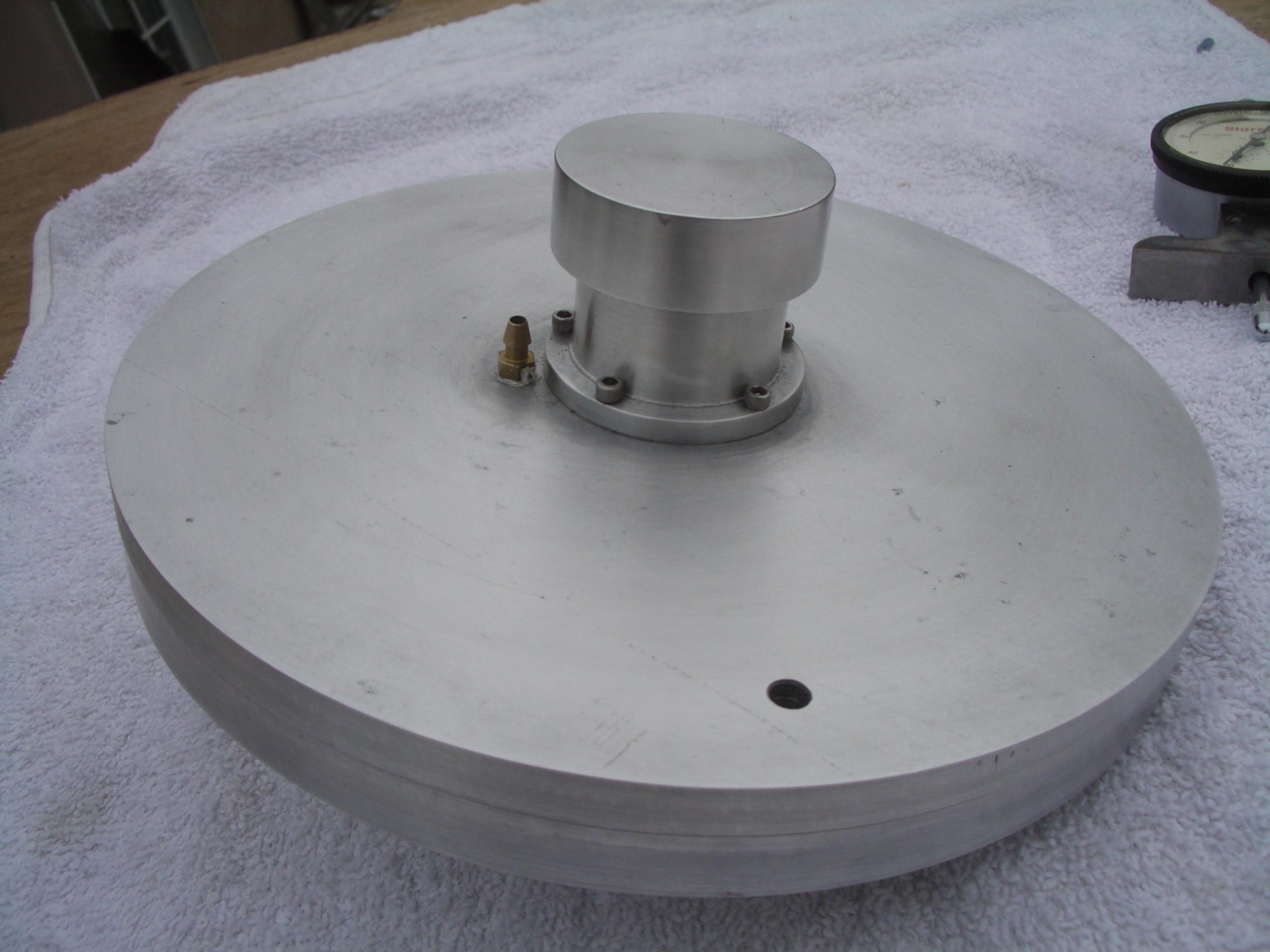

David,
Nice work and examples there. It does appear to be 0.018" depth from your picture though. What is the zerk fitting used for, grease? Most of the old pumps I remember where fairly quite, at least the old Silent Giant pumps that I remember but it would seem that you would have to make sure that the pump was running before the platter could spin or that it was stopped before the pump was turned off or you would have contact of the surfaces?
I took the picture slightly tilted and it slightly compressed, but .020" is actual dim.
thats not a zerk but the air entry point and yes, you need the pump on.
the Dimensions are not that critical and can be changed.
From time to time you can pick up air bearings from lathes on Ebay for a couple of hundred, bucks, sometimes with the encoders, sometimes not.
Many of those require 40 to 60 PSI + and have no concerns for noise performance. I would rather use the least and most quiet pressure available for DIY. and that means large surface contact area and 1 PSI or less.
