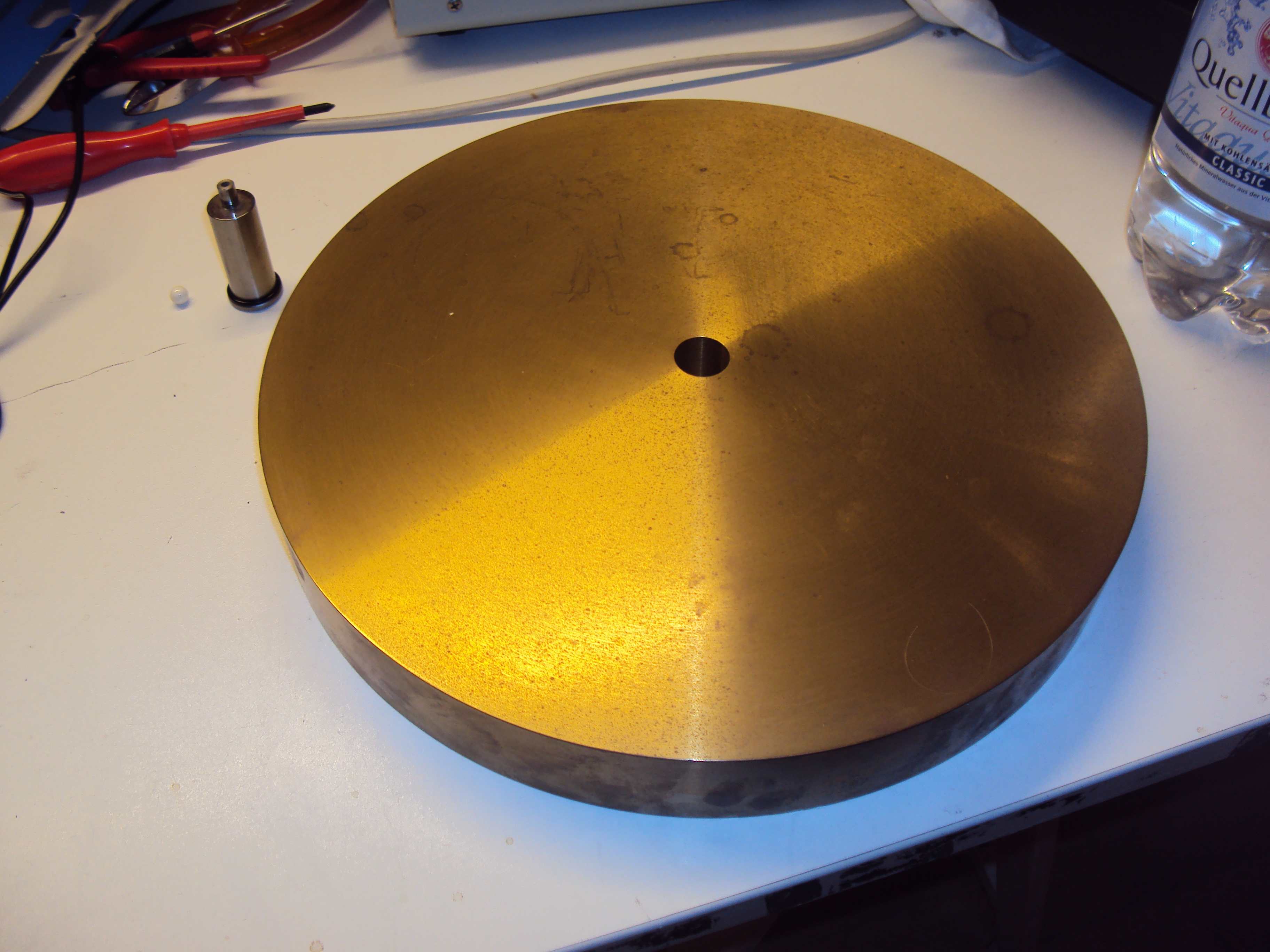

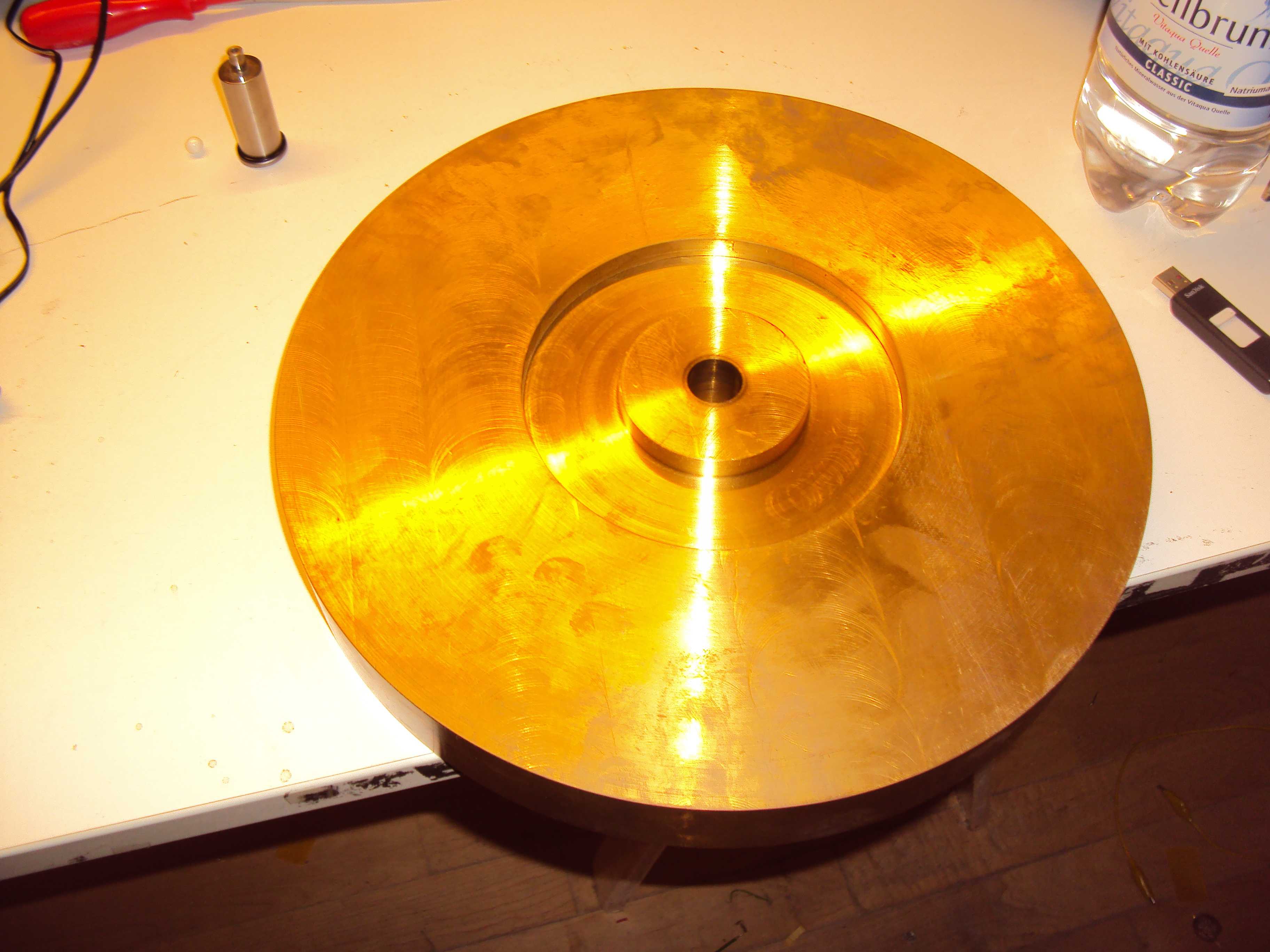

Here is the brass platter. It is 320mm in diameter and 40mm high.
This is not your wimpy aluminum, it weights a considerable 24kG.
When i stroke it there is only a very high pitched ping. I think that will go away ones it sits on the bearing and has a record mat. The mat could be made from POm or even PEAK but that is very expensive.

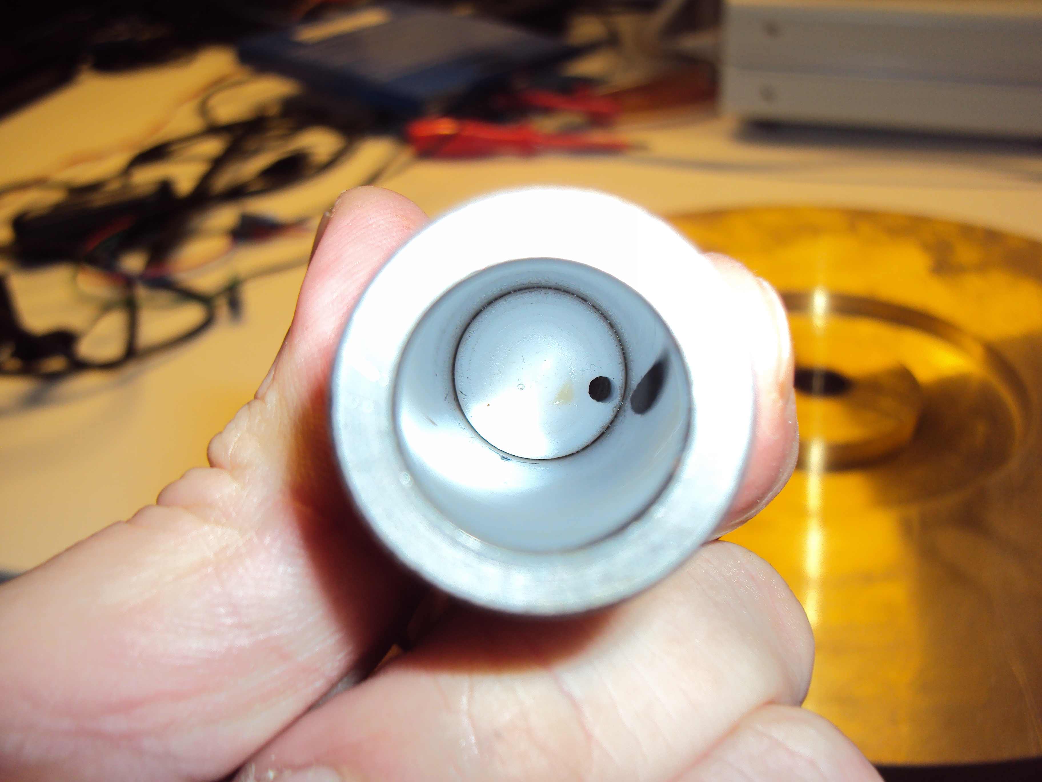

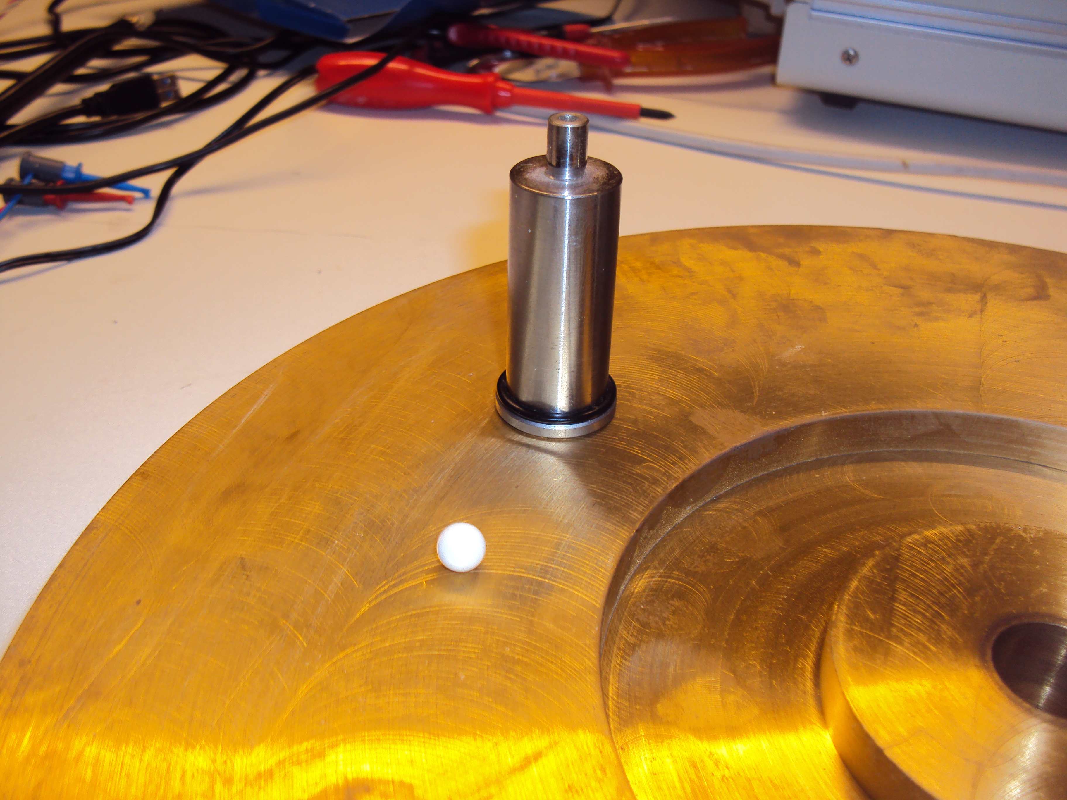

You also see the inverted bearing i used. It had a ceramic ball on a ceramic mirror and oil.
Ultimately it was too week and the platter was not turning any more.

When I had my 6kg platter with ceramic ball resting on a ceramic bearing run in, I measured the dip the ball had formed and calulated the pressure per area. Did it repeatedly, because I thought of a calculating failure first. The result was a presure of 3tons per cm2!! Interpolating to Your 24kg platter I'd expect a pressure of 10-12tons per cm2.
I doubt that any bearing would last long under these conditions. The bearing will run dry regardless of how much oil or grease you put in. I'm no mechanic but I'd assume that a hard-hard bearing combination won't suffice here and that a hard-soft combination of ball and mirror is preferrable for heavy platters.

Without seeing your drawing of the air bearing it sounds like you are calculating using the entire surface area of the platter as the bearing surface. In Joachim's instance the bottom of the platter is not flat but machined for the bearing assembly and has a large recess cut into the surface. I look forward to your drawings to see how you propose to accomplish this. I know we can just raise the air pressure to increase the force over a smaller area but wonder about the noise of the pump. Another question I have for anyone is the air pump itself. Wouldn't most of these pumps have a pulsating output, in a fish tank who cars if the air stream is continuous or pulsed, but for work in an airbearing I would think you would need a pulse-less air supply to not have the same problem of motion as the effect of an unevenly charged magnetic surface on two repelling magnets?
