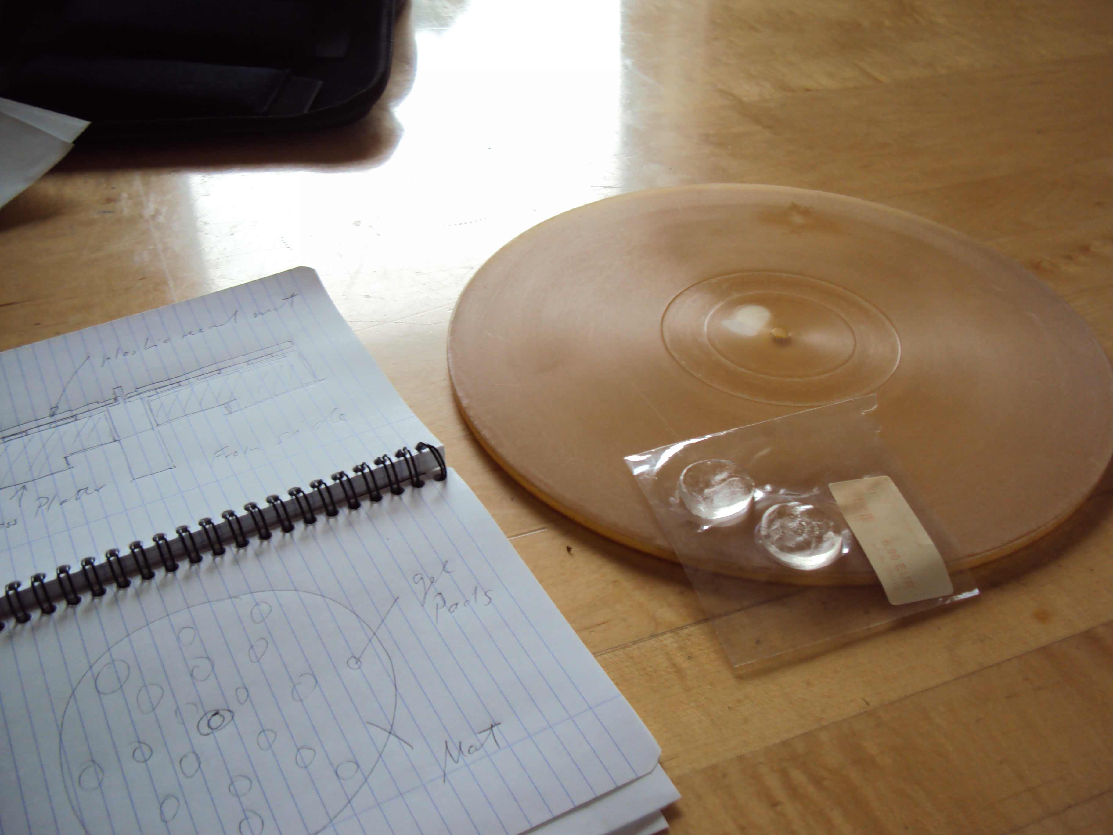

I think putting the record direct on the brass platter is not such a good idea.
TW acoustics does that anyway, they use copper for the platter though and that is a little softer. I talked to MiiB and he suggested a decoupled plastic mat on top.
I found a record mat that we had cast many years ago that can do the job.
I thought that decoupling with gel pads could be fine. These pads are used by drummers to tune the drum set. One maker is Slapklatz in denmark.
I will post a simple drawing how it can be done.

I did some really crazy experiments tonight. sq had send me a PM with a photo that showed a small diameter carbon fiber disk that floats 2/3rd of the record ca. 1 - 2mm over the platter so it does not touch it. That was the result of research a friend of him did that tried all kinds of platter mats. I thought that a CD has aprox. the same diameter and thickness so a floated a record on a CD. I used a clap to hold the vinyl down so that i had enough drag. The sound i got was interesting to say the least. Somehow the disturbance from scratches and dirt was less and it sounded a little bit darker and more sweet.
It also had an effect on the soundstage that is a bit hard to describe. Somehow it had a bit less height information and focus but it also sounded well fleshed out, say a bit rounded.
I am still at bit speechless how to describe it and i do not know yet if i like it better or worse. VTA had of cause changed too and i know that when i lower the arm rest i get also a somewhat fuller sound. Tomorrow i will try to raise the arm so that it is parallel to the record again. Maybe i can restore the focus and enyoy the quiet at the same time.
The effect is not drastic, i think the sandwich platter ( steel, vinyl, graphite, decoupled spindle ) of my SG1 is well optimized already. Ultimately, with the CD in place, i found the sound a bit artificial so i replaced the CD with a felt disk of the same diameter and aprox. the same thickness. The sound i got now was very natural. The slight artifice was gone. Tomorrow i will raise the arm and do some photos.
