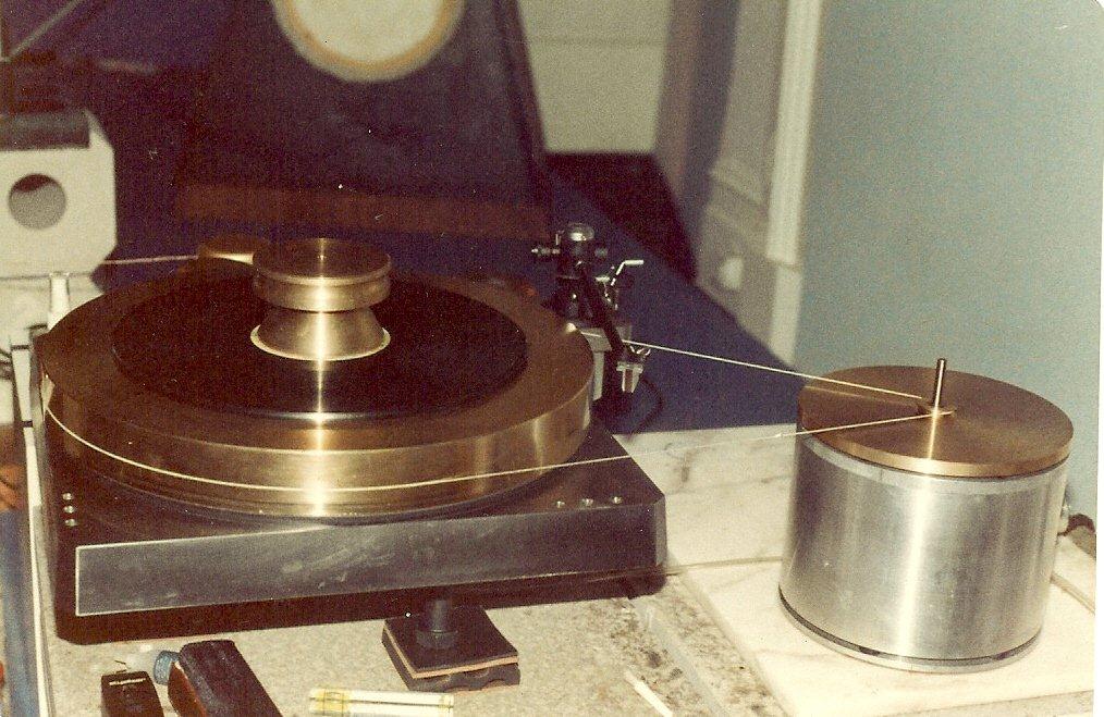

To take that mass from a standing start up to rotational speed must take an extreme amount of torque to just get it moving.
You 'hand-start' them (most string driven heavyweight platters)...before turning motor on.

As does this. The platter is pure graphite with an enormous outer mass ring. The whole platter literally floats on a bed of air, the only contact being the drive string. [The original arm was a pantograph parallel tracker made from pure graphite and held together by needle and gemstone bearings. I have a olour slide somewhere but cant find it at the moment]. A few of these TTs were made by Be Yamamura.
The second pic is of a simple air-lift version to test graphite as a platter material. The motor position seems unusual.
FWIW, concept a bit premature. Testing has only been done on Hurst AC motors.

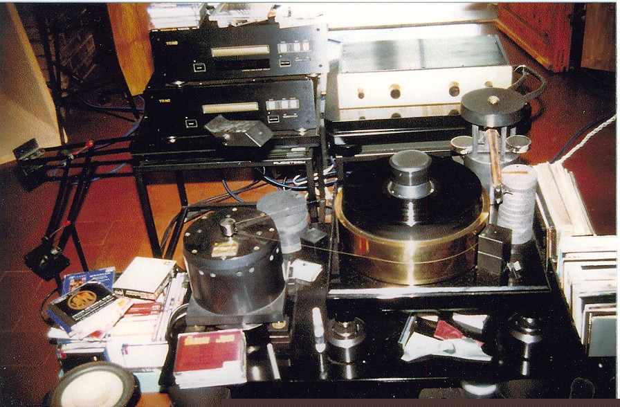

I was not able to thoroughly test. However, I would hazard a guess it was the lurching and lagging of the motor that averaged the speed not slipping. The drive belt a string, run 33.4-33.5 by itself, now that I think about. The drag belt was latex, it might have been from a VPI. The motor was a 300 rpm hurst. The platter was no more than 7-8 pounds made out of maple.
Anyway, here is one of the prototypes.

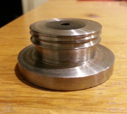

Today i set the VTA straight and it happened what i expected.
The soundstage develops very similar now to what i hear when i do not use the felt pad to lift the record off the platter. I like the resulting sound, again a bit less annoyance from scratches and a somewhat more mellow and round tone.
It is too early to tell but this is a method worth investigating when we do not want to put the record direct on the brass platter.
Dirt cheep and easy too.
Tomorrow i will post some pictures.
