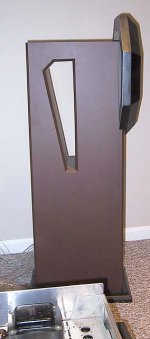

The frugel-horns are slowly progressing. The next iteration is gesting in my head, CAD program & spreadsheet. Martin & Ron have been quiet of late, but they are at least as busy as i am.
We can say that the alpha 1.3.0 horn is a decent sounding build, the next iteration will be quite a bit different (and hopefully won't fall flat on its face). We have found that the current drawings work at 130mm and 140 mm wide inside (Martin says they don't model significantly different). Here are pics of a 140mm wide version with octagonal supra-baffle -- we've also tried square, and when i get to it, a star shaped one is just too intriging to pass up....

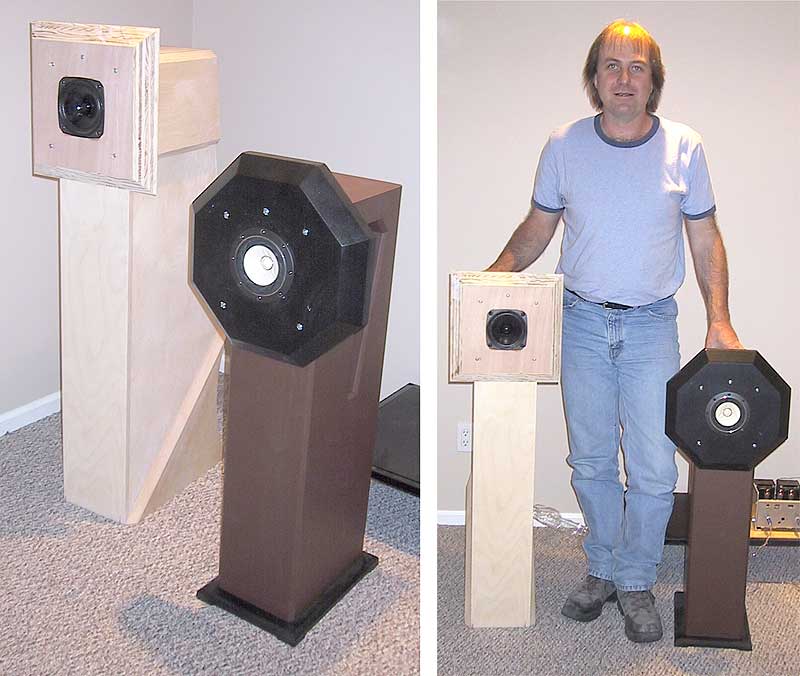

Our reference is still the RonHorn A126, but in the room we set up for Frugel-Horn development they tend to overload the room, and the Frugel-Horns -- even at this early stage -- come close.
In this size comparo, one can see why WAF (and a set of corners) might dictate the Frugel-Horn over the A126.

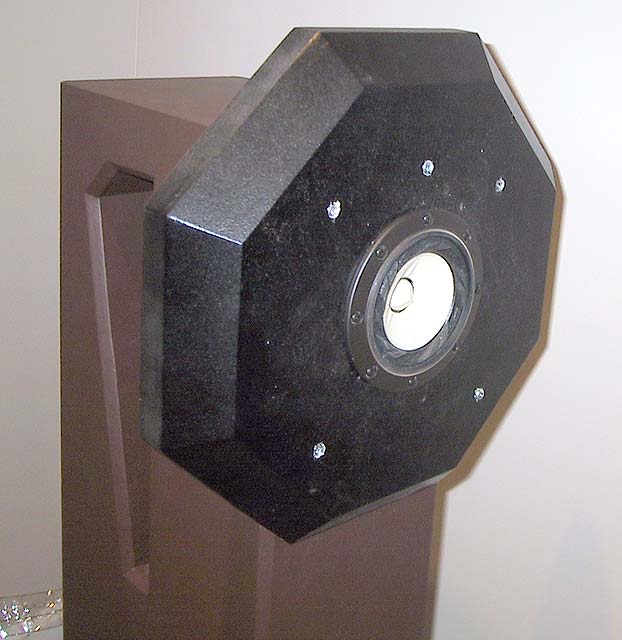

doorman said:Is the "big stop-sign" laminated mdf?
Plywood -- the supra-baffles are where i think we can see some creativity expressed.

Now who's that handsome dude standing beside some very nice sounding speakers?, why it's me lol!!!
Many thanks to Dave and Chris for letting me come by and have a listen 🙂 . First off I'd just like to comment that I'm new to the fullrange single driver sound, I have a pair of fe108ez's that I bought but have yet to build a home for them. The sound of both the Frugels and the A126 horn was to me, amazing. I wish I could still be in the room listening and exploring the sound more but mostly just having fun enjoying the music. Between the 108 and 126 driver I prefer the 108 in both horns, but the 126 sounds really really nice also. It was such a great experience for me to be able to hear these wonderful creations and meet Chris for the first time and see Dave again. Dave🙂

Thanks for all your hard work all.
I cannot believe how small they are. The stop sign makes that much of a differance? it kinda kills the WAF but adds a DIY tweak feel and sure to create comments from the average joe.
gexter said:Thanks for all your hard work all.
Gex - it doesn't need to be octagonal ( I was just feeling creative that day) - in fact square or a GR rectangle would probably give better results. Yes it seems to help quite a bit filling in the gap between the baffle step frequency roll-off and the low end horn/room lift
As an aside, note that Ron C has commented recently on the Fullrange forum the purpose of the prism shaped deflectors he's incorporated in his A126 design."
The deflectors make no difference in this application as the primary reason behind the deflectors is to keep a reflected energy from returning back to the mouth which will cause extreem ripples in the FR curve (we have enough of those anyway). Any rear firing horn which is tight to a wall,or worse a corner, will reflect a great deal of energy back to the mouth, which returns up the flare and ends up fighting with the either positive or negative pressure along the trip back to the filter chamber. Thus the deflectors.
