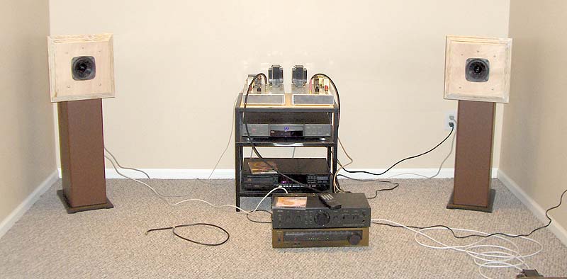

planet10 said:1st pictures with square supra baffles.
It looks even messier in the flesh, and yes the room needs some serious treatment
I'm sure the baffles make an improvement, but the WAF, for those of us without a dedicated room, doesn't look promising.
How are they without 'em? Don
