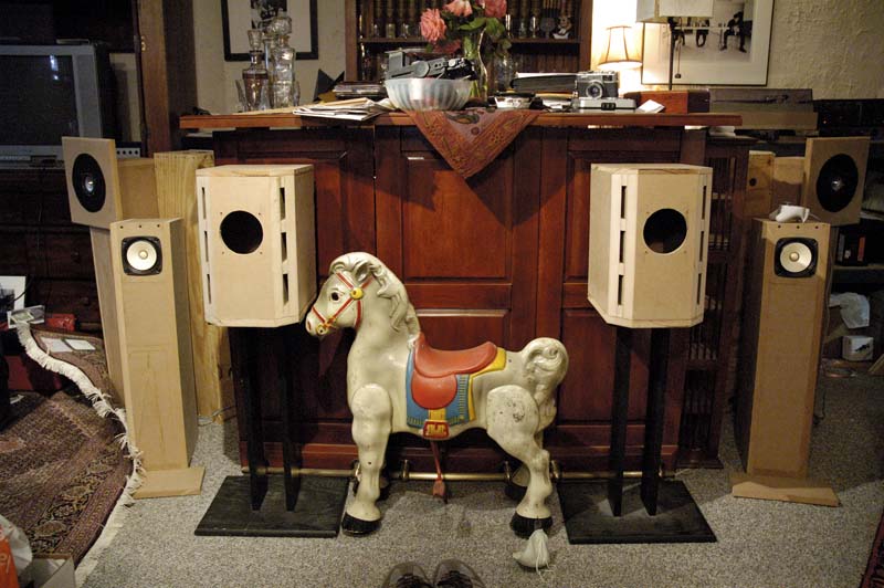

Ok, my Bass is severly thin. Any thhoughts? Compression chamber too big (1.6L). Not set right in the corner. Ok, one other question, since this is my first set of BLH's. If you don't have them in a corner will you experience zero low end? I put them in the corner and it improves but still feels a touchthin to me. I don't have enough corners for this! Ron, help me! 🙂
On a lighter note, I attached the why my GF is irritated with my hobbie picture. This is the middle of our living room right now. Yes, that's four, count em four sets of speakers. Hmm, I need the drivers for the Fonkens. This is not counting the set of 4 foot tall Polk's (100 lbs. a piece) around the TV. In the house now, we have 7 sets of speakers.

Harderror said:my Bass is severly thin. Any thoughts?
They are corner horns. Out in the room as pictured they just won't work. To get any bass you need corners (or at least a wall with some of Ron's reflectors (i post his drawing here -- i can never find it on the web when i'm looking for it)).
And in the corners placement is critical. Moving things even a bit makes a difference, We have ours assymerically placed which works well. They will never go really low (Ron says 50 Hz is possible in a corner with the as yet upcoming reflector) but 60-70 Hz is probably more in keeping with the alphas. What there is thou can be really well defined with lots of finese.

Thanks Dave! I put them in corners and have been futzing around with the placement this evening. Much better. How is your experiment coming? I am having reasonably good results with the 1.6 litres. Are you finding the same or do you have some other ideas about volume? I am going to cut some different size blocks tomorrow and try each one for about an hour each and see what comes of it. I will post the results.

Also, make sure you add to your queue the addition of a supra-baffle. Somewhere in the neighborhood of 12" across (circle, stop-sign, square...)
dave
How should I make the baffle? Any curvature to the face? As in lathed? Or flat stop sign style? I will build it tomorrrow if you post the info. Thanks Dave! You have been a great help! I might measure them but on the other hand, I am more interested in getting them to sound right, not to measure right.
