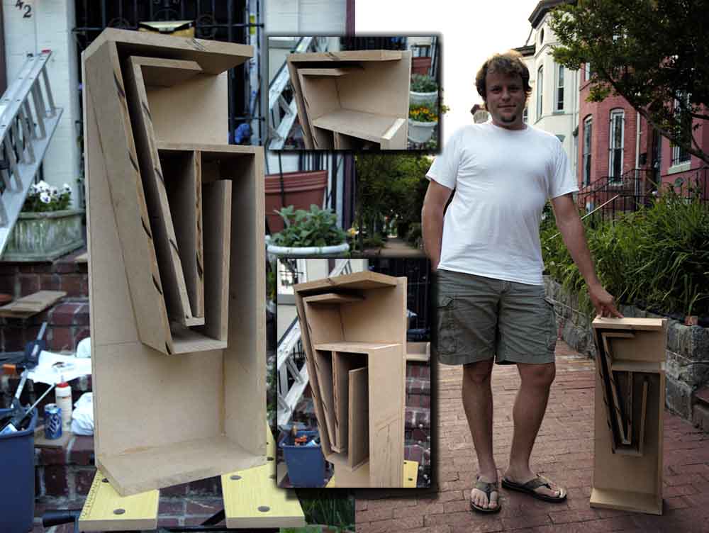

Ok, I have them together. Only a few things left to do. I will start posting impressions this week I hope. Only things left to do internally are cut the divider to alter CC and the last taper board for the horn (I am having to build a jig to get the 60 degree cut out of my table saw. I had to cheez it up with a montage photo. 😉 so here it is. As I said I will post follow ups this week.

That 60 degree cut!
Tom: if you're able to get your hands on a tenon cutting jig, this cut is relatively easy. Set the blade to 30 degrees and cut one end horizontally, then clamp the piece vertically in the jig for the second cut.

It never really soaked in just how small this thing is, but Tom's pic really puts things in perspective. I just checked and my Fostex horns for the 108 are 10cm taller, 16cm deeper and 4 cm wider.
I can't wait until you guys tell us the optimum setup for the 108, because 1. I can shave off some height and increase the depth and use them for surrounds which go in corners anyway and 2. I can build an extra set to take out of my room and slip them into the house without complaint.
