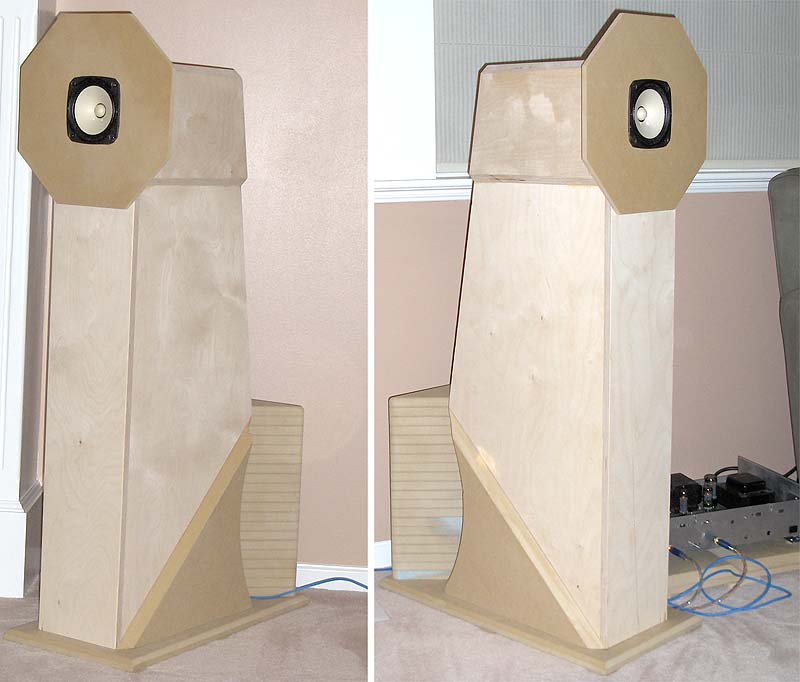

Harderror said:How should I make the baffle? Any curvature to the face? As in lathed? Or flat stop sign style?
Some room to experiment here. And compromises to be made.

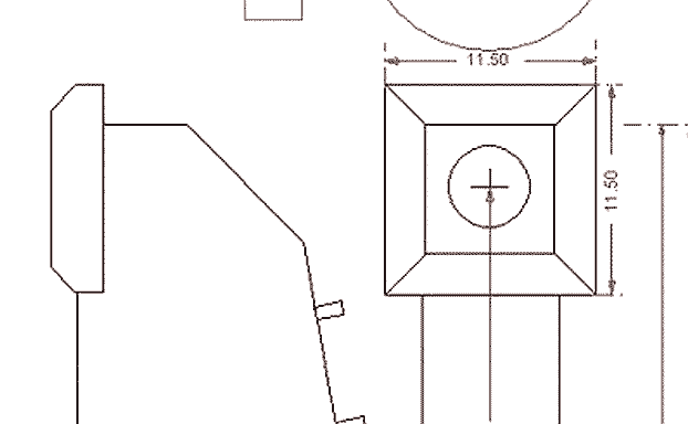

The idea of the supra baffle is to push down the point at which baffle step starts taking affect to where the gain from the horn starts lifting response. The width determines where BSC starts, but the shape plays a big role in the ripple of the edge diffraction.

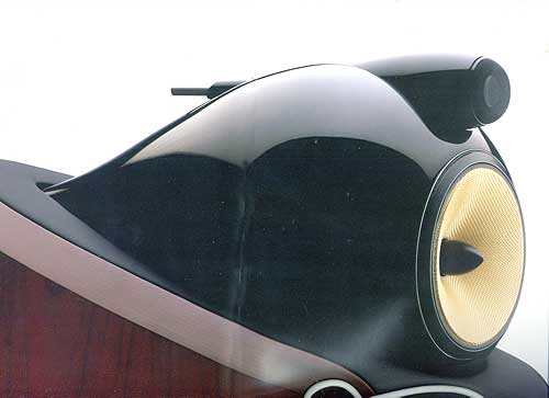

The shape of the mid chamber in the B&W Nautalis i probably a good example of what an optimum shape would be (you can be sure a lot of serious R&D money went into this shape). I'll post a pic in the next post. In Olson this would be an enhancement on the sphere.

Note that after the Sphere probably the best shape is the square or rectangle with large 45 bevels and a section going straight back from there. Ron's supra baffle for the A126 fits in this category, and our latest stop sign does as well (with a 45 thru 1.5" of depth with a further 0.75" trailing edge) but gets a tad closer to the sphere. Do note what happens without the trailing edge (see the half sphere)
So how far do you go? Depends on resources (time, wood, skill, & money) & aesthetics -- there are some huge possibilities for artistically rendered shapes.
How big? Part of the juggling comes in with the size of the CC... the smaller the CC the more HF stuff comes out the back of the box... if you look at the FR curves of the FE126 or FE108 you can see that ideally this point is somewhere between about 200 & 300 hz so with a bit of fudging somewhere in the neighborhood of 12" (300mm). And -- within reason -- as deep as you can make it.
Also, should I mount the driver on the baffle and attach that or should I have the baffle flush with the speaker? If I mount the driver on the baffle that will increase my cc as well, this is probably good.

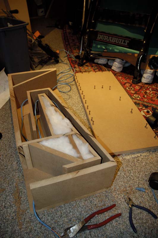

Harderror said:Ok, here is how I made my CC. The panel is just pressure fitted int o place and then caulked to seal it and stop any vibration. This is obviously for testing only, but, it seems to have worked quite well.
Tom, we're pretty much on the same page - if you're happy with the performance once the 126's are installed and fully broken in, you really need to try in baltic birch. Just watch Dave's posts for further refinements.

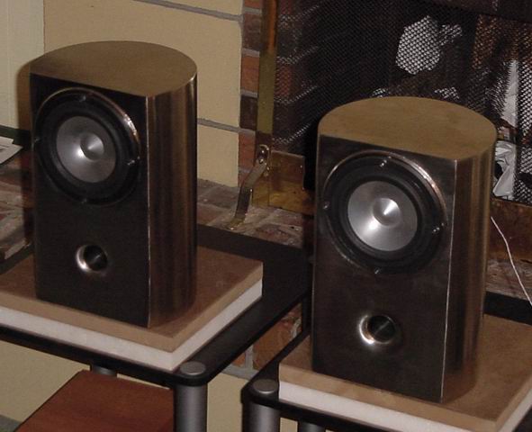

Awesome! I was hoping I'd come across this information again. I first saw it early last year when I was trying to determine what would be the best shape to use in fabricating my stainless steel enclosures. I originally was going to go with the sphere but after some consideration opted for an 8 liter vertical cylinder. The Jordan JX92 works extremely well in this arrangement with astonishingly deep bass and that with no BSC.
