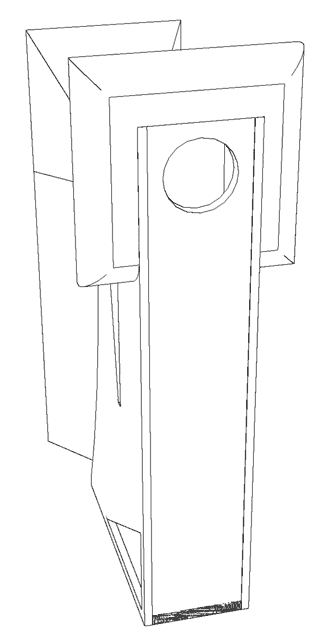

When do you think revision 1.4 will be out. I am interested in the development of the deflector.
My other post seemed to disappear so I am posting again.
gexter said:When do you think revision 1.4 will be out. I am interested in the development of the deflector.
Later this week... Ron & i have finally found a way to communicate & we are just detailing the deflector.
dave

Dave,
I understand the goal creating a DIY design of similar proportions to Ed's The Horn, and as I understand his is quite finicky about placement. Builders are going to know whether they have corner or wall placement, so it seems that instead of a separate deflector shaping and directing the rear wave should be an integral part of the design. Couldn't this be easily accomplished with 2 or 3 variations of the final segment(s) and horn mouth, making the cab a complete speaker?
johninCR said:understand the goal creating a DIY design of similar proportions to Ed's The Horn, and as I understand his is quite finicky about placement. Builders are going to know whether they have corner or wall placement, so it seems that instead of a separate deflector shaping and directing the rear wave should be an integral part of the design. Couldn't this be easily accomplished with 2 or 3 variations of the final segment(s) and horn mouth, making the cab a complete speaker?
There will be 2 or 3 versions* but all will still be optimally placed in a corner. To do a wall supported horn you really need to go all the way to the throat which means a whole different horn -- and Ron has already provided us with the A126.
*(basic horn in rectangular box, and then that box with add supra-baffle or add curved rear mouth or add deflector or a combination of these options)
With the deflector in place, placement will likely still be finicky, but liekly a bit less.... B
dave
update: Ron has OKed my take on his rear treatment -- i just need to get the drawings banged into shipable form. Note this alpha 1.4.0 version will not invalidate the 1.3.0 many of you have (WAF), but it will improve on it (Ron estimates "around 10-12 Hz lower Fc as well as a much cleaner low and mid bass response."). I'll try to get a teaser up today.
planet10 said:I'll try to get a teaser up today.
Many more renders here:
http://www.planet10-hifi.com/alpha140.html
dave
