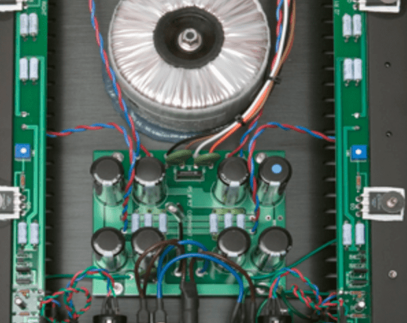

nope production unitThe original F6 looks to have used resistors like the 5W KOA resistor shown above.
Ah, 0.7 Siemens - that’s low. Looks like FQH44N10 is the one to go for…nope, no go
