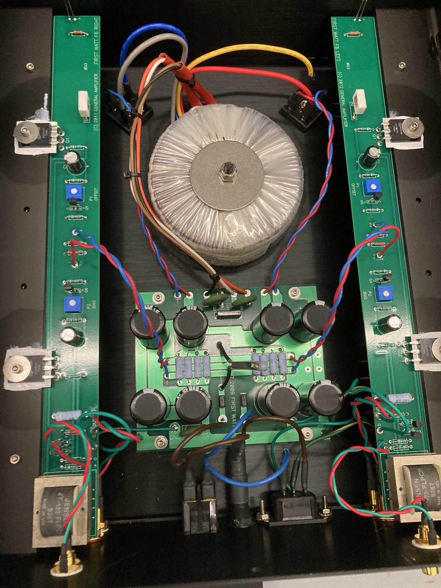

I took a video that shows the cold power up behavior of my right channel F6 Diamond board. The two small meters are across the source resistors (left is 0R56 and right is 0R47)the larger Fluke is monitoring DC offset.
Input is shorted and chassis lid is installed just after power up (no rear panel). Regulated +/-28VDC rails and 1.7A bias current.

I’ve been playing around with transformers and a variac to dial in the rail voltage. The regulated psu needs about 1.5V max dropout to stay in regulation under all conditions throughout the yearly ups and downs of the power grid. The F6 Diamond is running at 1.75A bias current, any more than 1.5V drop and the regulator heatsinks get a bit too hot for my comfort zone.
For this scenario and 120V mains (measured), I need a transformer to deliver 25Vac under load at the psu input (Synchronous rectification used here).
The Antek AS-3224 delivers that perfectly when loaded with F6D board.
25Vac
31.45V at the first cap
30V output after adjusting regulator
At this voltage and current the source resistors are hot!
R1 and R1* are acceptable but, R2 is very hot running at 80°C+

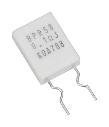

Guys, how about using 5 watt current sense resistors?
IIRC the KOA BPR series has a wide range of values, e.g. 0.22R, 0.33R, 0.47R, 0.56R that can be used.

Good call Zman, I would have used the KOA 5watters, but only had 0R1, 0R22 and 0R68 in the bins. Time to Add 0R47’s to my Mouser cart, they will be swapped in before the F6D leaves the bench 😉.
