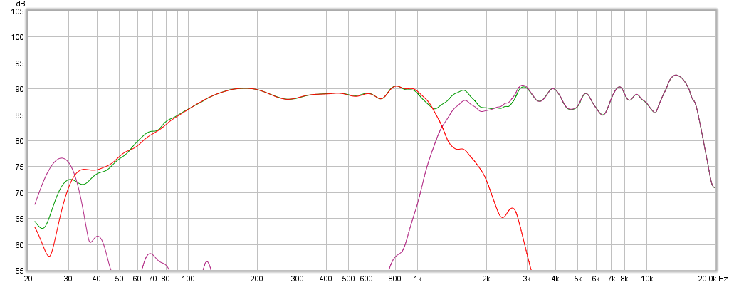

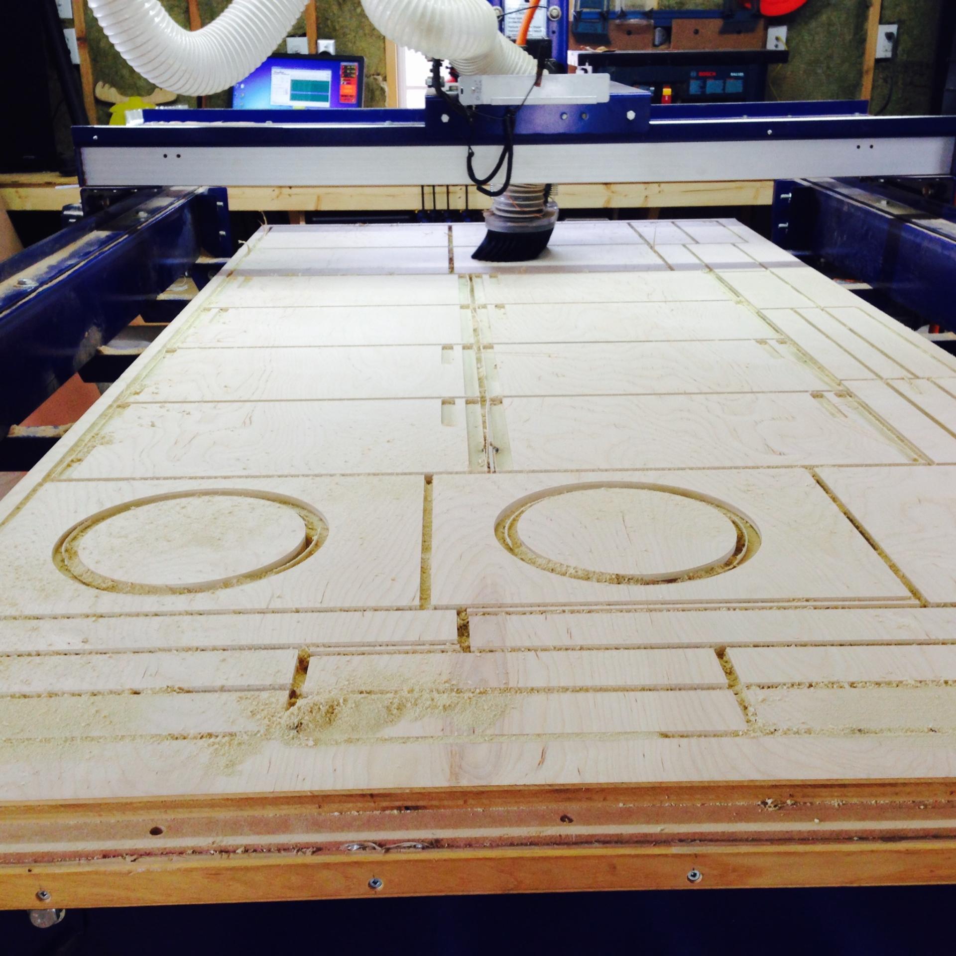

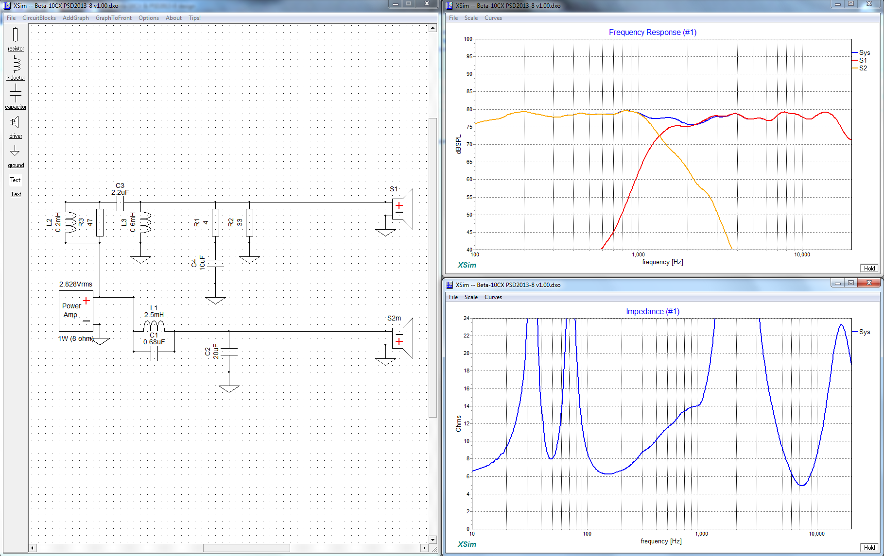

I never received the Eminence XO's to play with due to travel and other issues. However, I did have a custom XO developed for the Eminence Beta 10CX + Eminence PSD2013-8 compression driver.😀

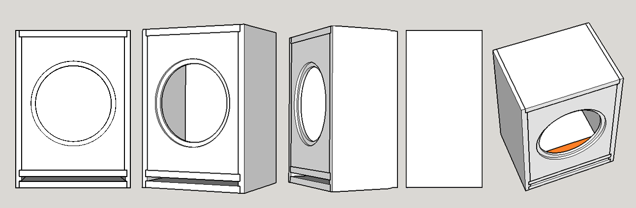

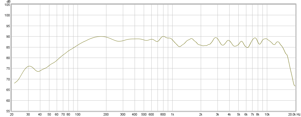

I am slowly working on the enclosures, health issues have made the build go sloooooooooow (aging sucks, but the alternative is worse).

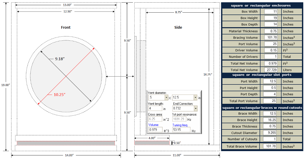

Do you have a dimensioned drawing?

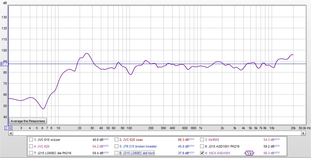

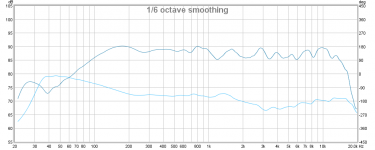

This is my 10CX with ASD1001 using the 2.5k Eminence off the shelf crossover in a sealed car subwoofer box (I think around 0.75 cf). It was measured in my lounge and is crossed by the AV amp at 80hz (was the easiest way to power and measure it), so you can ignore everything below around 200hz. I used 1/6th smoothing.
For off the shelf stuff it doesn't look too bad I guess.
hi Gary - that looks pretty good - the values on that xover IIRC are 2mH/10uF lowpass, 3.3uF, 0.35mH highpass. How much high frequency padding are you running? (for those who like to experiment, two 6.8uF caps in series with battery biasing can be used to examine charge-coupled networks)

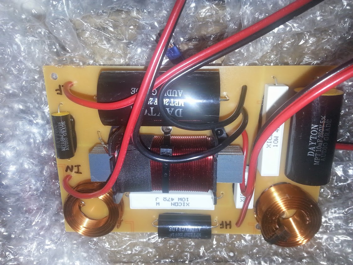

Picture of XO:

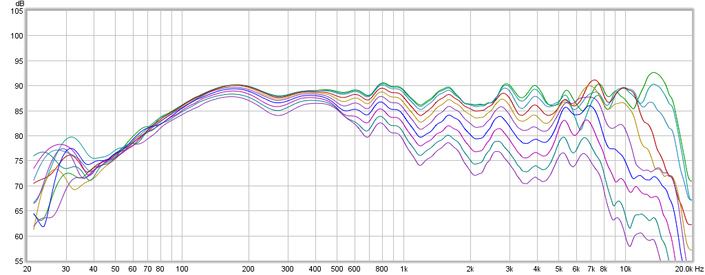

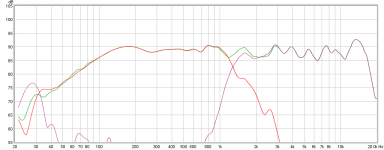

Measurements of the 10CX + PSD2013-8 w/custom XO:
1) 0-90 degrees off axis, 10 degree increments

***Measurements and XO designed by mtg90 at AVSForum
  • Response and phase at 20 degrees. (On axis REW has a phase tracking issue and adds 360 degrees o.png

That looks very nice. Have you measured with the tweeter inverted?
