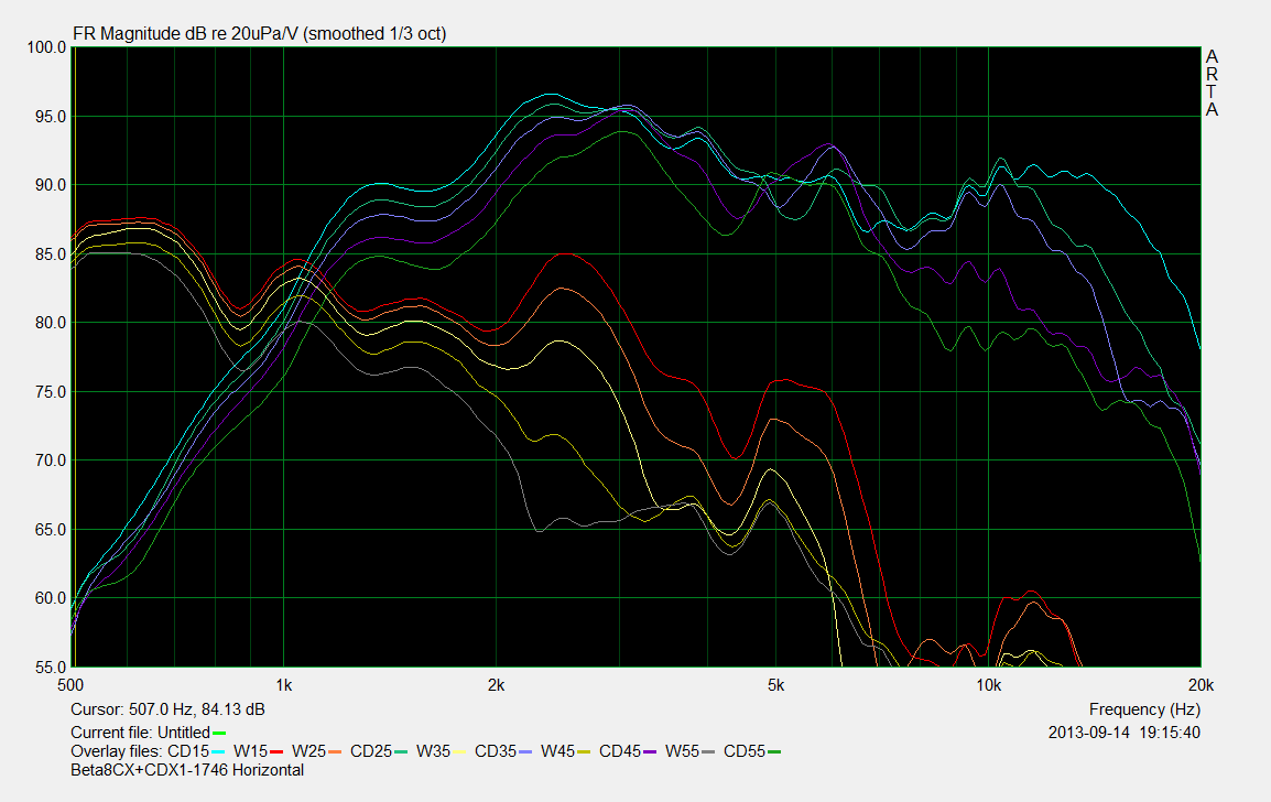

Here's a Beta-8CX set of horizontal measurements I just did, in case that interests anyone. The CD is a CDX1-1746. These are high resolution measurements and gated, but I smoothed to 1/3 because I was trying to look at directivity and didn't want it any messier than necessary. The driver is recessed 1cm beyond flush. It kinda looks like the woofer makes a better horn than the horn...

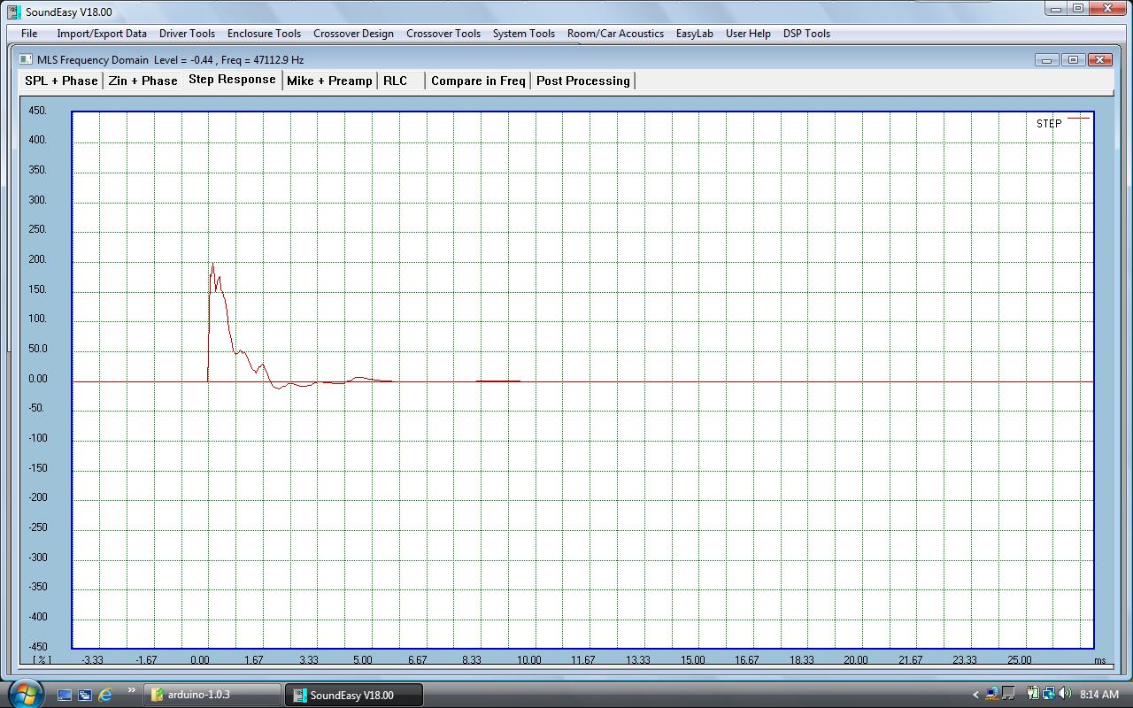

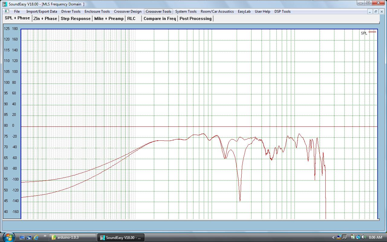

I have been playing with the discontinued 8" CX2008 and the Beta 8CX mated with APT50 and DH200E. I like the drivers a lot. Attached are some measurements made with SE. Crossover consisted of 10 ohm resistor & 2.2 uF cap on tweeter, driven by electronic crossover with B4 @ 2 KHz on woofer and B3 @ 2 KHz on tweeter. Measured 22 deg off axis, at 20", no smoothing.
Drivers are CX2008 and APT50.
They are in a reflex box, 0.8 cu ft. Sound is very nice, spooky imaging. Satisfying bass, not quite enough, but OK.

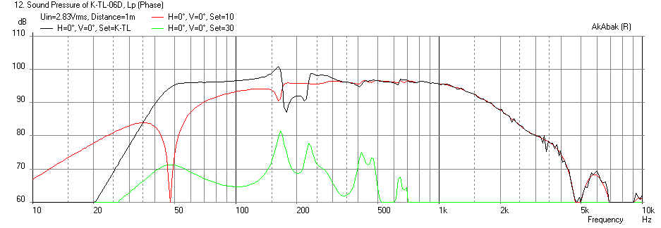

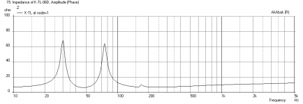

What software do you use to sim a Karlsonator ?
AkAbak ?

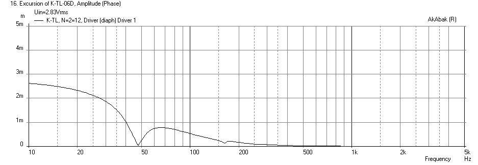

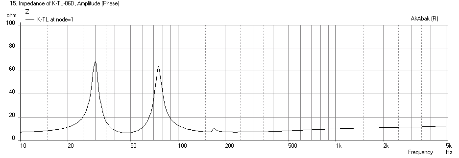

Yes, I use AkAbak and developed a way to approximate the response of a Karlson aperture through a series of rectangular ports which approximate the shape of the Karlson aperture function. The rest of the cabinet is modeled as a series of interconnected waveguides and chambers. More info is in the Karlsonator thread in the Full Range forum. Here is a sim of the Beta 10CX in the Karlsonator in a large room so no wall reflection effects, also no high freq CD installed.
SPL vs Freq
371291d1379253825-eminence-beta-cx-10-what-have-you-done-lately-karlsonator-beta10cx-freq-1m-no-walls.png
Impedance
371293d1379254057-eminence-beta-cx-10-what-have-you-done-lately-karlsonator-beta10cx-impedance-1m-no-walls.png
Cone Excursion
371294d1379254057-eminence-beta-cx-10-what-have-you-done-lately-karlsonator-beta10cx-displ-no-walls.png

Did you get the Beta 8CX horn to sound anything but harsh? I can't seem to. Tried all kinds of things, still nasty. I haven't tried a different compression driver yet, though. Using a Celestion 1746.

Well I'd be interested to see any measurements of the HF you'd care to post (with enough details to try to duplicate, hopefully). I do still have a box with the 8CX hanging out on my shelf. I was planning to leave it until I feel like buying a fancier 8" coax, but I'd be up for giving it another try with the 8CX too.
I was able to pin down the problem to bad performance 3-9kHz or so, and it did not seem to be anything fixable with EQ (passive, DSP, anything). I also confirmed the performance of the compression driver was fine on other horns.
