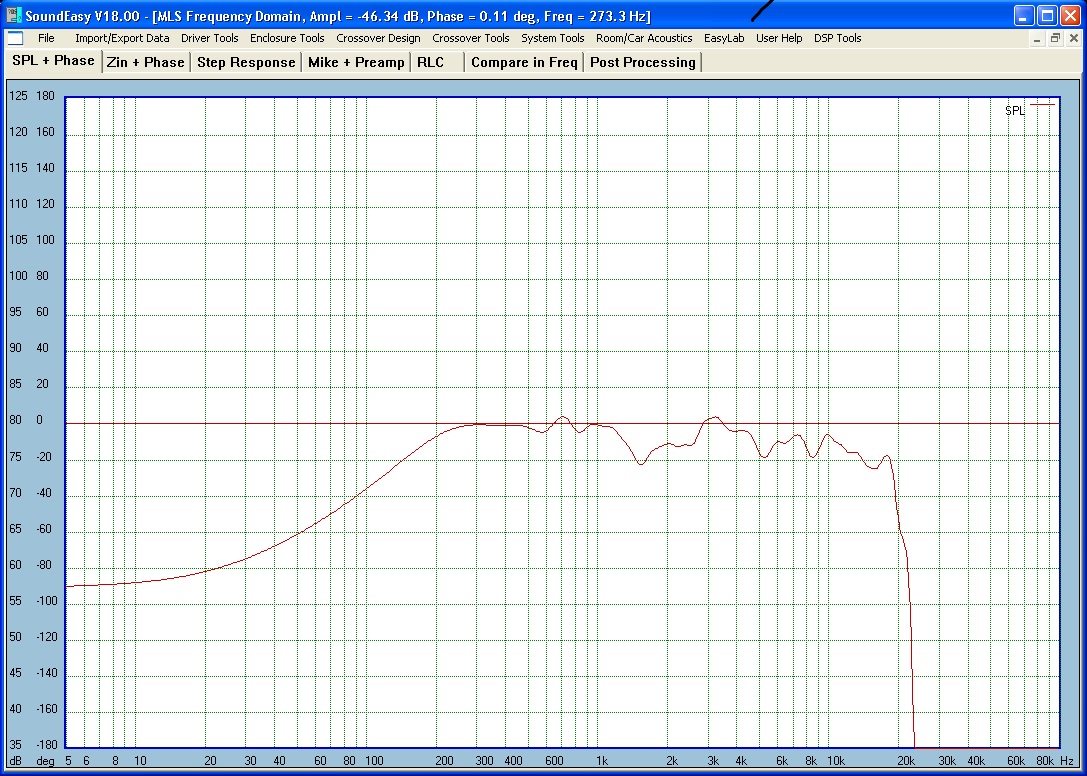

Sorry about delay in posting results.
The first important thing that I have found about using these drivers is that the ASD1001, at least in the Beta8CX, has a rising bottom end.
Net result is that a 2nd order HP at 2.5 KHZ nets a 6th order response with -6dB at 1.5 KHz or so.
The second important thing is that the Beta8CX has a hump in response at 5-600Hz. This gives a forward character, obscuring everything else. Deal with this hump, or wonder forever what is wrong with the bass and the tweeter.
An OK, but not optimal passive crossover can be built with the tweeter padded -6dB, 2nd order Q.5 at 2.5 KHz, 1.4 KHz Q.7 LP on the woofer.
Use a parallel resonant notch on the woofer to deal with the hump. 3ohm//104uF//1mH for about a -2.5dB attenuating Q=1 Fo=500Hz response.
Zobel the woofer for best results.
My measurement axis is 30 degrees.
On axis The mid treble gets some roughness and the top octave peaks at 20K.
They sound very good to me.
Lively, no practical limit on dynamics. No harshness (see important things one and two above).

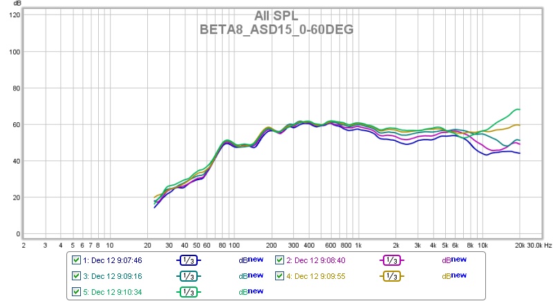

Thanks, do you have any graphs with more axes? I wanted to see if the Eminence compression driver looked any better than the Celestion I measured (see post 6 here). No filter makes that stop being harsh to my ears, which I established by process of elimination to be 100% due to issues 3-~8kHz. (note the lack of directivity in that range in my graph, although I'm not sure if it's that or resonant behavior in that range, or both).
I think your woofer response issue sounds like a combination of your cabinet and its intrinsic response, but I never got to the woofer beyond eliminating it as the source of harsh sound, so I'm not sure. I figured if the ASD1001 looked significantly different in that range, I'd pick one up, just in case.
The ASD1001 has the same characteristic - wider dispersion in the 4-8K octave than surrounding. That is apparently a characteristic of the horn + cone, not the compression driver. Agreed you cant fix that with any filter. I don't listen to these on - axis, but at 15-30 degrees off toe out.
The graphs that I attached are at 0,15,30,45,&60 degrees using an earlier crossover implementation. The old crossover does not affect the 4-8K region.
Agreed. And it was worse before I beveled (1.5" bevel) the sides of the baffle. My baffle (ignoring bevel) is 12 X 15.5, with the driver C/L 7" from the top, centered side to side. The mids without the shallow notch filter sound clean, but forward.
The 4-8K dispersion issue does not bother me personally. It, and a number of other issues are for sure there. Especially when I delay the woofer and get the drivers in time alignment, I find them subjectively exceptional.

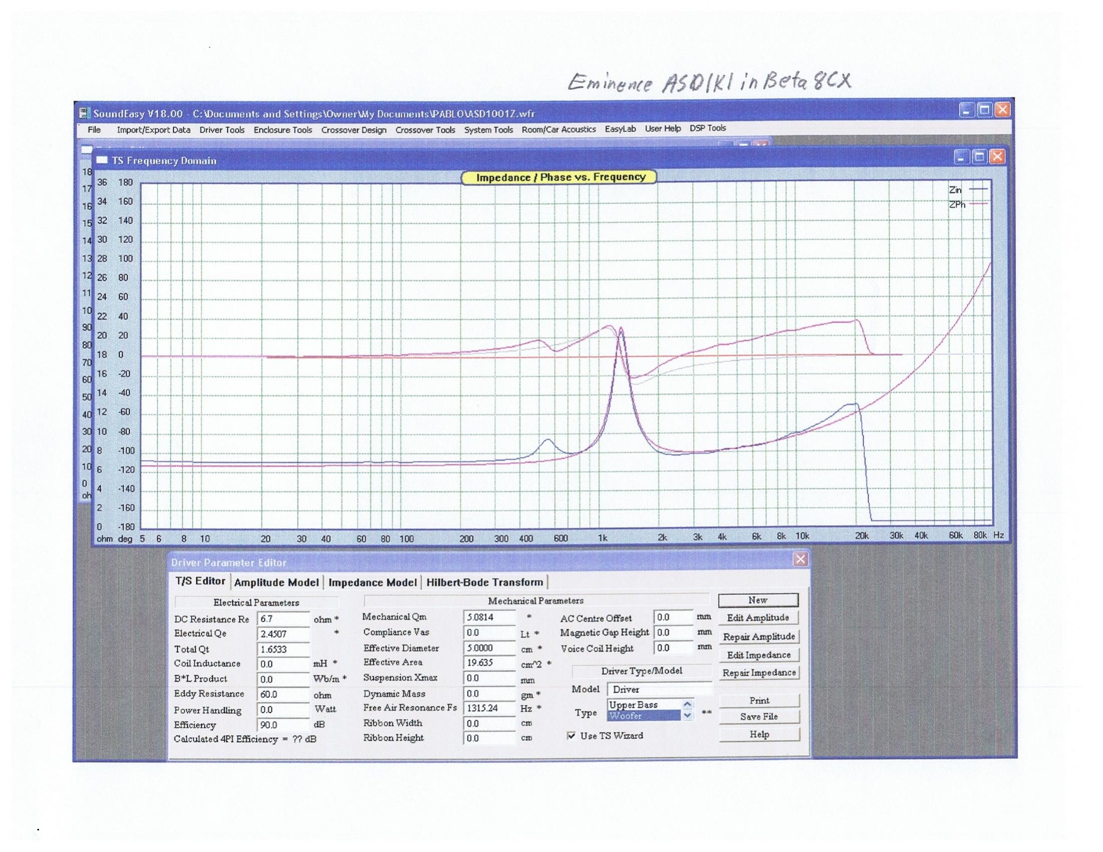

And the ASD1001 has a really healthy impedance rise Fo 1350 Hz.
Without a conjugate to damp that resonance passive xo's that I have tried sound really bad.
This does not show up at all as a problem with active xo's and a 100uF blocking cap.
I have not yet found a passive xo that I like without using a conjugate.

the inexpensive denovo driver should be more capable than asd1001, which is one of the worst iv heared even with a 2k5 12db crossover.
I dont know about the denovo, but the ASD1001 is pretty bad with parallel passive xover unless you deal with the very healthy resonance at Fo (1350 Hz) with a conjugate.
Add the conjugate and its much better, but not as good as when used with active xo.

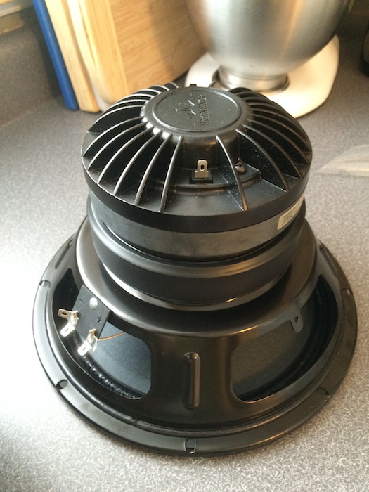

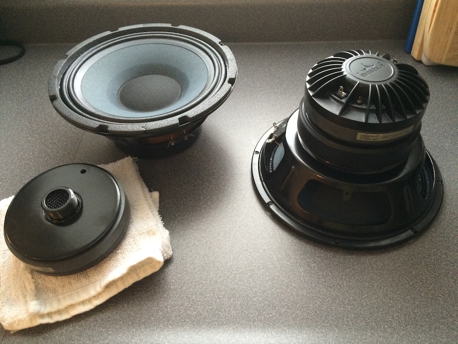

I'm about to start a Beta 10cx/ PSD:2013S-16 build and am currently gathering the parts. Unfortunately I will not have new test equipment until Nov 7. Until then I am stuck in XO theory land.
Does anyone know if it is possible to add a delay to a passive XO? I am going to keep the XO external so I have options.
Some pics for fun.
