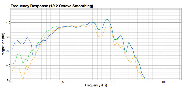

An outdoor ground plane measurement attached (the variation in lowest octave are because of the wind). Green curve is 12CX in 100ltr reflex tuned to about 40Hz, Blue 12CX in same box and reflex ports plugged (so not really closed but close...) and ugly yellow 10CX in 50ltr reflex tuned to 50Hz.
If you pack the 12CX to sealed 50-60ltr you get quite same bass as the 10CX in reflex but with 12CX's better midrange, directivity to lower frequency and sealed enclosures better impulse response.

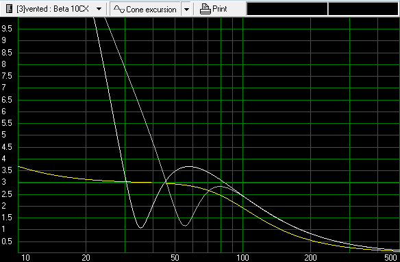

The reasion I wanted to go ported is for the reduced cone movement at low frequencys. I also like the upper mid-bass punch that 10" drivers give. Have used EAW quad 10's quite often doing special effects for Theatre productions. 12" drivers don't give the same tactile feel for some reason.

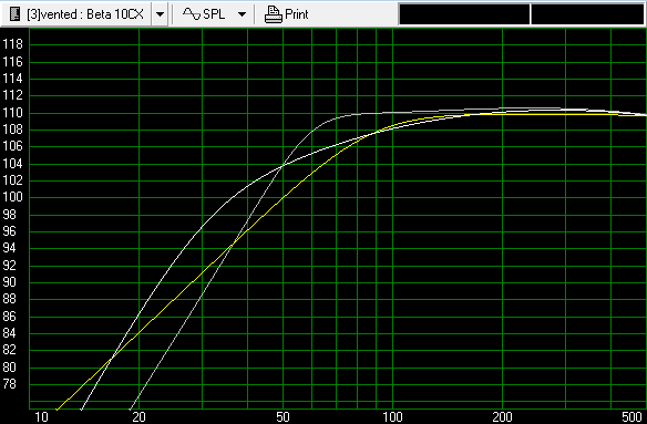

Here's a sim in 55 liters @ 25W:
white = 10CX tuned 35Hz
grey = 10CX tuned 55Hz
yellow = 12CX sealed w/ heavy fill

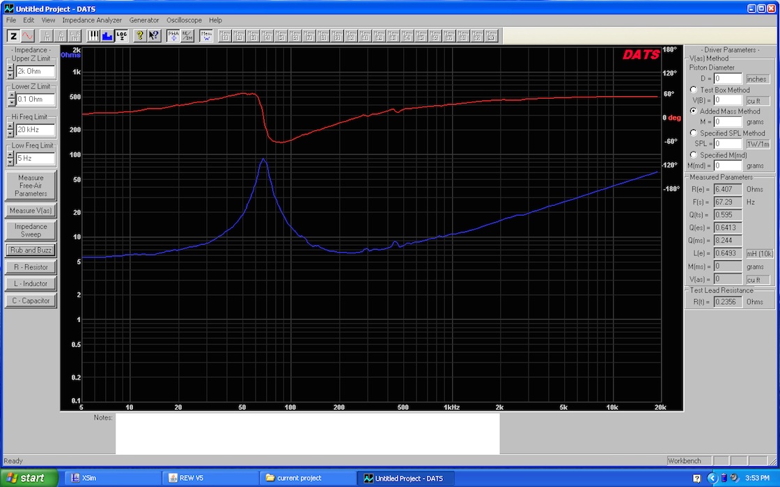

Thanks, I've got the same sims using the same program actually 😀 I'm waiting for my replacement test leads to come in from Parts Express so I can measure the actual drivers in test enclosures... should be here on Nov 7.

I am practising using XSim so when my test leads get here I'll be more experienced with the program.

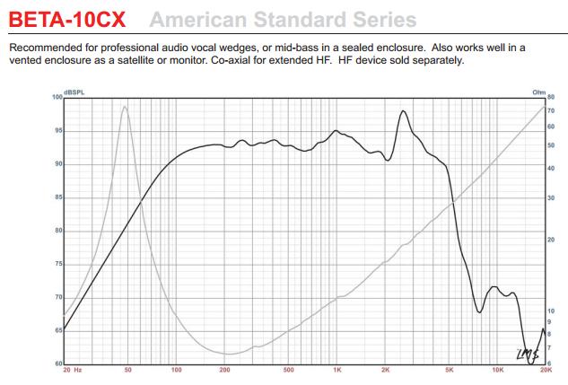

Why are you getting a deep notch at 550Hz with both 10CX and 12CX?
The notch is not there with Eminence plot of the the 10CX.

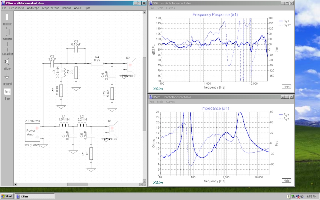

A bit of maths and theory:
At a XO of 1500Hz I need the woofer to be ~ .5ms behind the CD which at 1500Hz is -270deg. If my theory understanding is correct 2nd order on the CD, 3rd order on the woofer should get me quite close.

These are ground plane measurements and the notch is a reflection from ground (about 2m mic distance and 17-19cm from woofers midpoint to ground). These measurements were only to look the bass (below 200Hz or so...). So it is not a backwall reflection. 12-inchers prototype was 50cm deep, by the way 🙂 .

What you are describing is not a ground plane measurement. A ground plane measurement would have the microphone laying on the ground.
Sorry, of course the mic was laying on the ground. My bad... English is not my native language and seems like thinking and writing at the same time was too hard 🙂 .
Anyway, that notch is a reflection from surroundings. I don't have a totally even surface, only grassy back yard of my "tool shed".

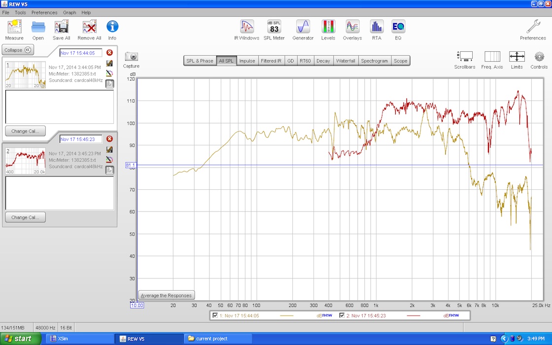

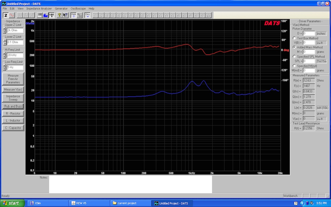

It's not all that ugly. It looks like th cone had a major breakup around 2.6K. That's going to be hard on the ears, especially since you can't get out of the come much lower than that. The horn won't let you.
You may need a trap on the cone.
