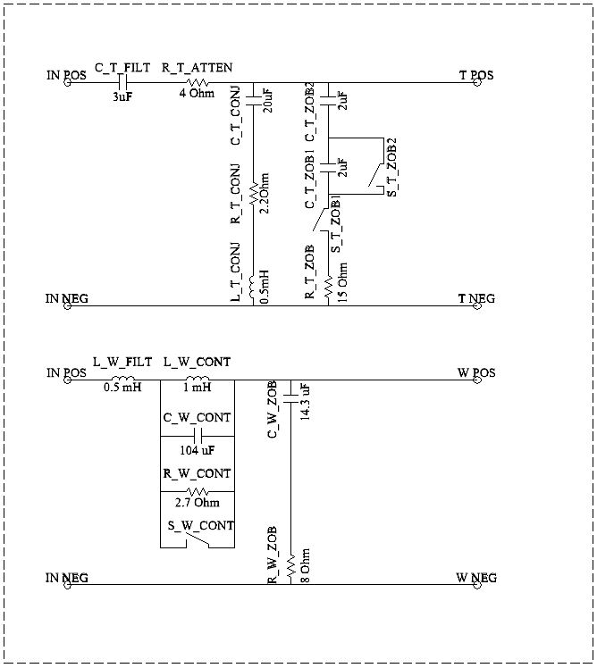

It has been some time since I posted results. Here is my latest passively crossed version. There is a zobel on the woofer, a conjugate on the tweeter to null the fundamental resonance, single attenuating resistor on the tweeter, and first order electrical filter on both the tweeter and woofer.
Hi rkondra,
Can you put up the crossover diagram with the compensating parts and values.
The first order crossover is interesting. Wonder how the main driver sounds with that ?

Hello Ashok,
Though this xover uses a single filter element per driver, it is definitely not first order acoustic. Much more so than the CX10, the Beta 8 has some response issues up top, and the tweeter roll off is far from textbook, but the net result is OK for me.
The xover schematic is up. I placed two switches to adjust response externally. The woofer switch defeats a contour that deals with a midrange prominence. The two tweeter switches alter the tweeter zobel, effectively attenuating the tweeter.
I almost always leave the woofer contour in - circuit. The midrange prominence makes the speaker a little shouty, masking the bass and treble.
My reference axis is 15 degrees. (L&R straight ahead, no toe - in) With the tweeter zobel switch S-TZOB1 closed and S_T_ZOB2 open this yields a flat measuring and correct sounding response.
My center channel is at 0 degrees, where closing both switches on the tweeter tames the top octave + on - axis rise. With switches so arranged, I do not get any image spotlighting with all speakers active.
The sound to me is completely satisfying. Best overall that I have heard. The on and off axis response is in phase throughout the crossover region with > 20dB null with tweeter polarity reversed. I have become sensitive to small phase anomalies in the crossover as result of playing with speakers too much, and these are spot on. Sibilants have no ch ch, no spit, just right. Sensitivity is really good, and they will play cleanly with no sign of distress as loud as I care to listen (105 dB or so) with mid power amplifiers.
I have heard HI FI speakers with a little nicer this and that, but they would all melt while these are loafing.

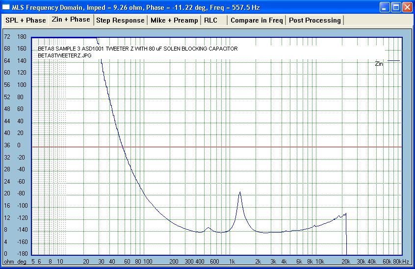

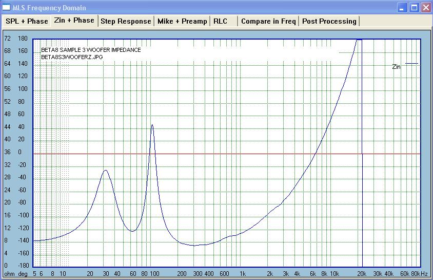

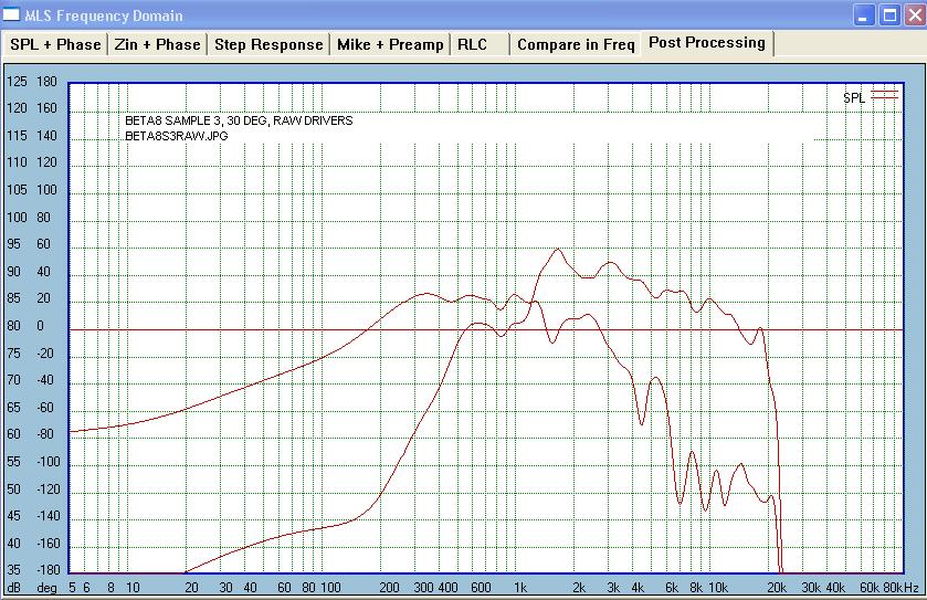

I am looking forward to seeing what you get. The shout I mentioned is a low Q thing centered about 6-700 Hz. Not really a peak in the driver response, but more like two things creating a slight (2dB) hump. First is the diffraction loss that, with my baffle, begins around 300 Hz and drops below, and the Beta 8's natural suck out at 1Khz. These put together net a rise in the octave or so in the middle.
Subjectively, this makes the speaker sound loud, without much kick in the bass or excitement in the treble. The contour network sets this right.
You should be in much better shape with the CX10. Just watch that tweeter - it has a really healthy impedance rise at resonance, and a smooth but pronounced rising response with dropping frequency.
