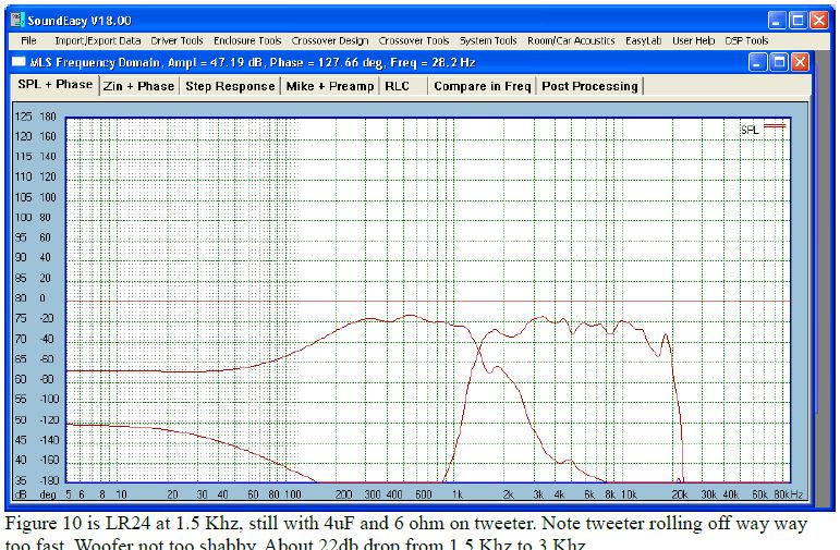

I have crossed the ASD at 1.5 KHz, but active only, and it works just fine. Passive crossovers with both the ASD and the D220 need to deal with the z rise at resonance to have a prayer.

Time delay 290 uS.
For the crossover,
Passive 6 ohm series resistor & series 4uF cap along with active LR 4th order at 1.5KHz.
The passive components level match with the Beta8CX, and flatten the response of the ASD as well as protect the tweeter from DC etc.
This gives acoustic about -48 dB/octave, -6dB @ 1.5 KHz, and flat response in tweeter passband at 15 (a little up on top) and 30 (a little down on top) degrees.
