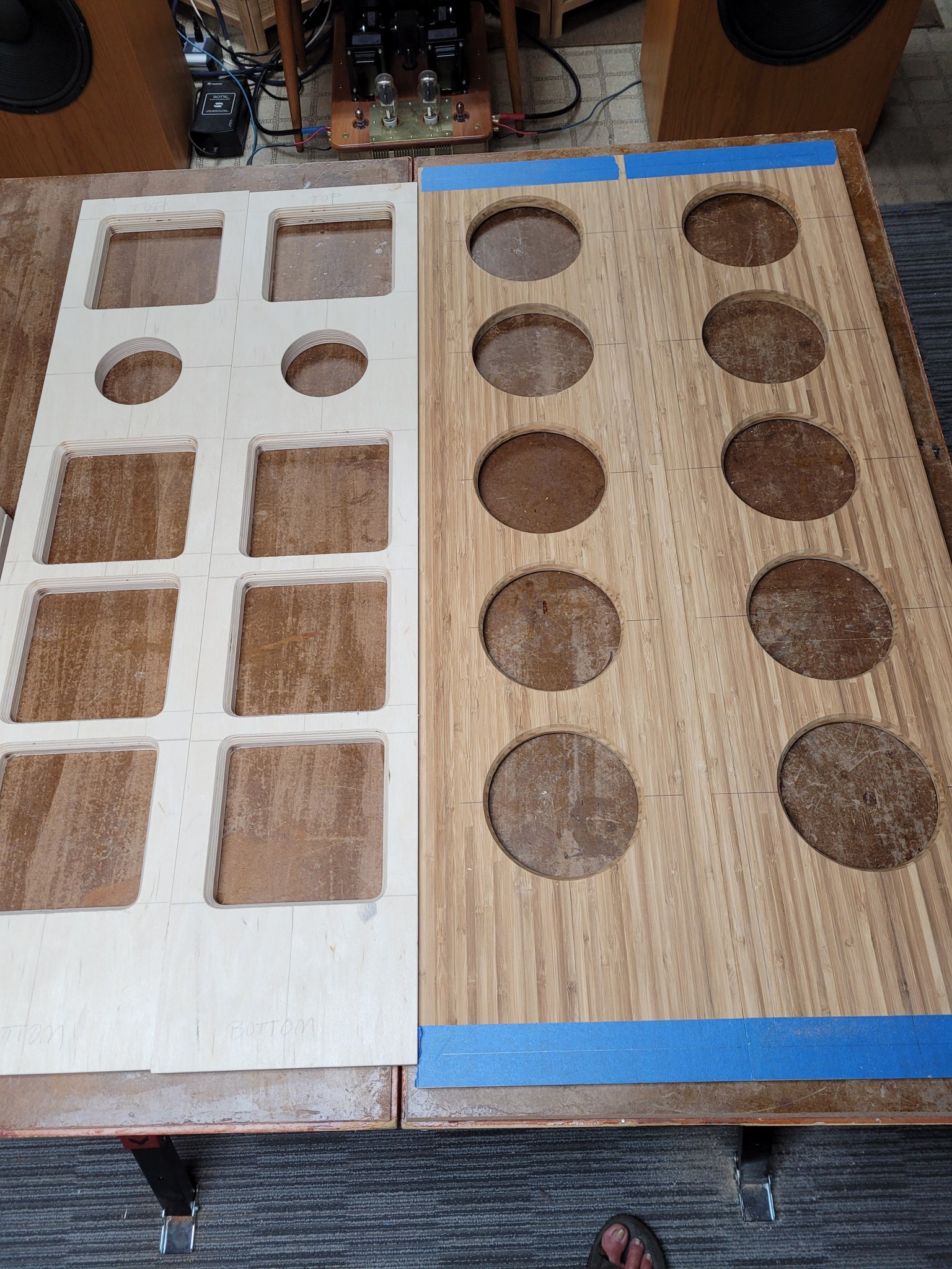

Progress report on my ULD build. Just finished with cutting and routing out all the panels. The cabinet is 1" bamboo plywood, except for the front baffle, which is 3/4" bamboo plywood. The sub front panel is 24mm baltic birch plywood (2-12mm panels glued together in a press) as well as the tweeter stiffening panel. The main brace is a laminate of 6mm baltic birch ply on the outer surfaces and a 1/2" MDF core. I was actually surprised that an unscientific rap on this composite (identical sized) was a higher pitch than 24mm baltic birch. I didn't weigh it, so don't know if it is stiffer or just less massive.

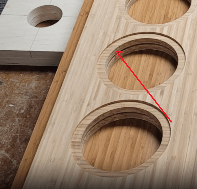

Are you going to do a round over / chamfer on the insides of the cut-outs for the drivers?

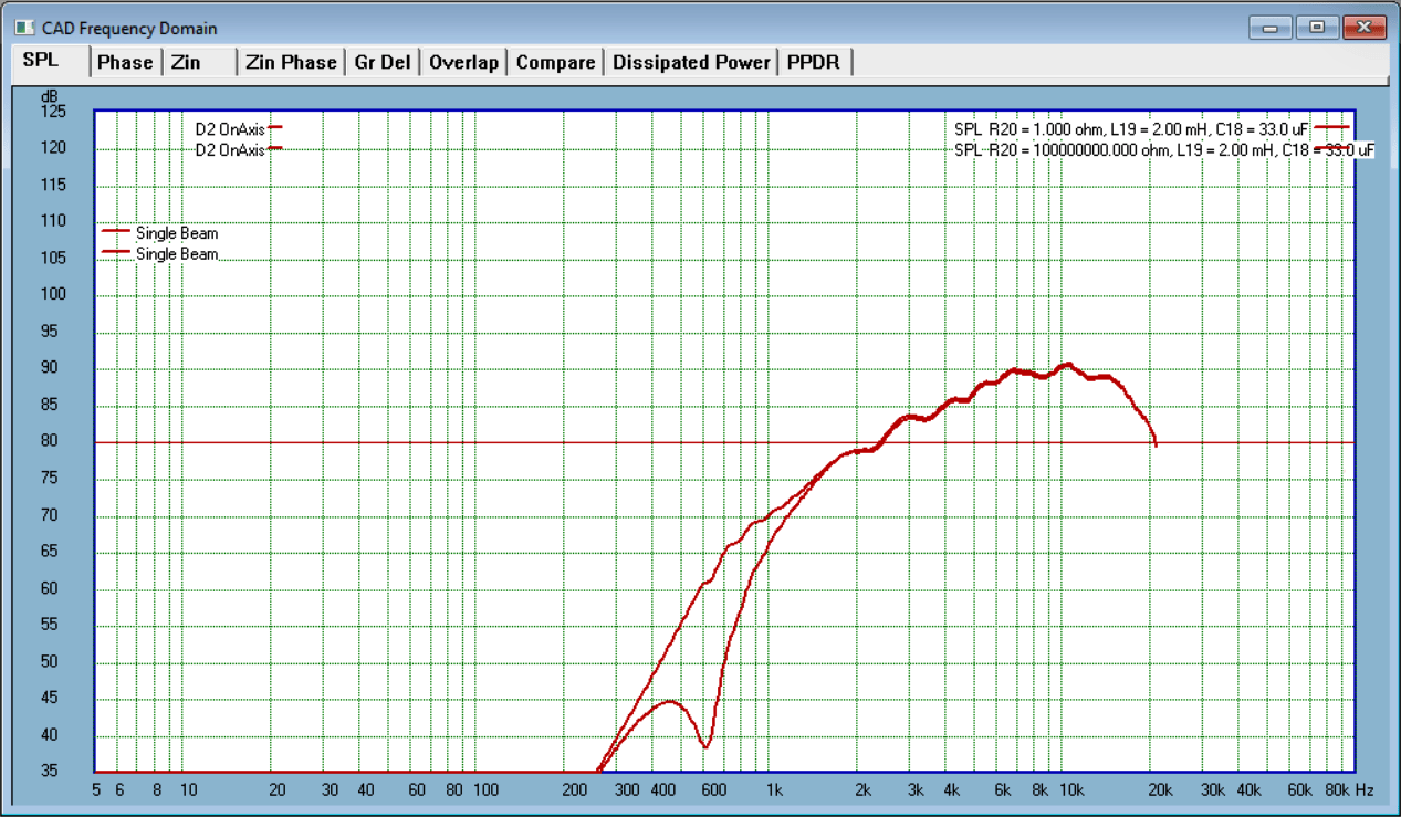

I use the 15° off axis as the waveguide was designed for that with that tweeter, so they need to be thought of combined single unit. But electrically this is 1st order down to 1500Hz, the effect of the LC null is shown below. Greater power handling and lower distortion and basically minimal amplitude near the resonance of the tweeter. I want the dome to hardly move. The waveguide also means the capacitor value is close to a third of what it would normally be, that too lowers distortion, increases power handling. Those are the major aims here, but keeping it looking like 1st order (electrically at least) near the crossover frequency.

dmcgown,
Good and timely question. I have been approaching routing on the bamboo plywood cautiously. I used a solid carbide spiral bit for the driver holes and rebates which worked well but only have straight chamfer bits. Concerned about tear out. Of course it is the back side of the baffle (who cares about the cosmetics). So I may do a test on a scrap piece of bamboo plywood to see how it goes. Fortunately, I was too busy today to begin glue up, so I will give a try to chamfer the holes. Maybe Planet10 can chime in, this is the first time I have worked with this material.
Zman,
I chamfered the baffles as well as the front sub panel using a 30 degree chamfer bit (didn't have a 45 deg 1/2" shank handy). That leaves a bit more material on the flange in way of the mounting holes. Interestingly, I had more fuzzing (tearout) on the BB front sub panel than the bamboo plywood baffle, in fact the latter was clean with no tearout at all, to my surprise and relief.

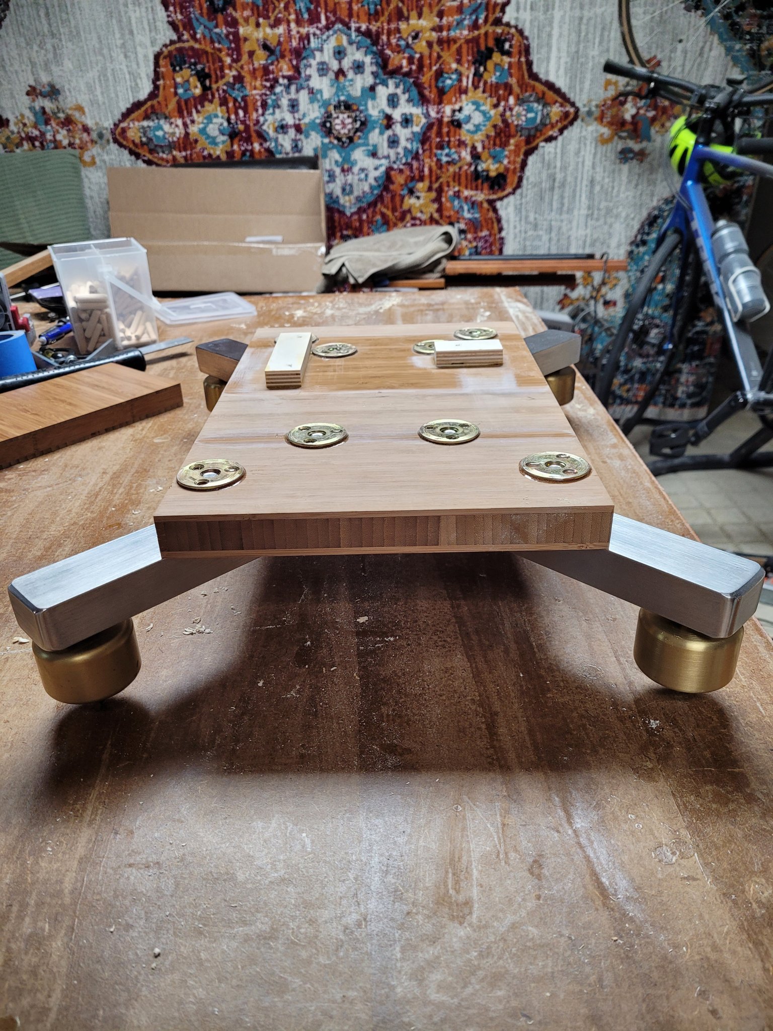

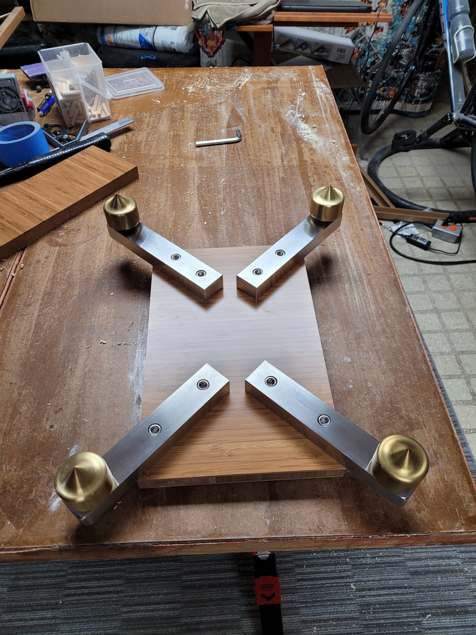

One more question, do you plan to elevate the speakers from the ground? IIRC it has been suggested by Joe to lift the speakers by ~10cm, and there's been a number of builder anecdotes that indicate an improvement in subjective listening impressions/experiences after doing that.
Zman,
Another good question. I fabricated some heavy outrigger feet using 1"x1-1/2" solid aluminum bar stock that are coupled to the enclosure base via 3/8"-16 socket head cap screws into nut inserts that I epoxied into the bottom panel. I had to carefully layout the placement of the holes to clear the baffle depth and the braces on the back panel, and both the panel and aluminum bar was drilled to suit. I am using (for now) Mapleshade brass footers with 3/8"-16 threads that are 2" (51mm) high, together with the jam nut (6mm) and thickness of the bar (25mm) gets me to 82mm height. I can always install a longer piece of brass threaded rod with a 25mm standoff between the brass footer and outrigger foot to extend the height, but this is pretty close to optimum. I can also use the ISO Acoustics Gaia feet should I choose to (I already have the Mapleshade footers).

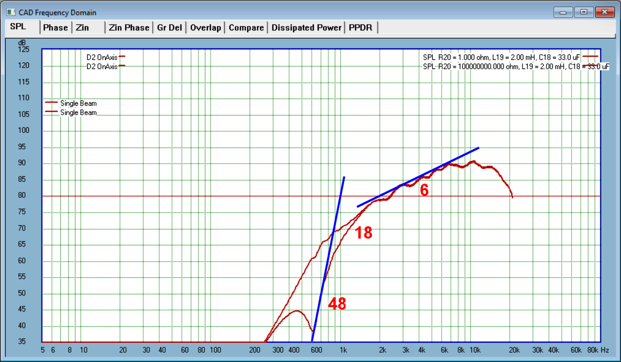

For those interested and for what it is worth, below is the result I get here with the tweeter null starting 1st order (6), then 3rd order (18) and finally 8th order (48), all quite gradual. The idea is simple enough, as far as possible, as little motion as possible at Fs. Note that the result with the null is roughly 1st order to well below 1KHz. The difference however, at Fs is a good 20dB and hence 1/10 movement of the dome. But around 3KHz Crossover, it is definitely 1st order, but we all want the lowest possible distortion and that is what the null is all about.

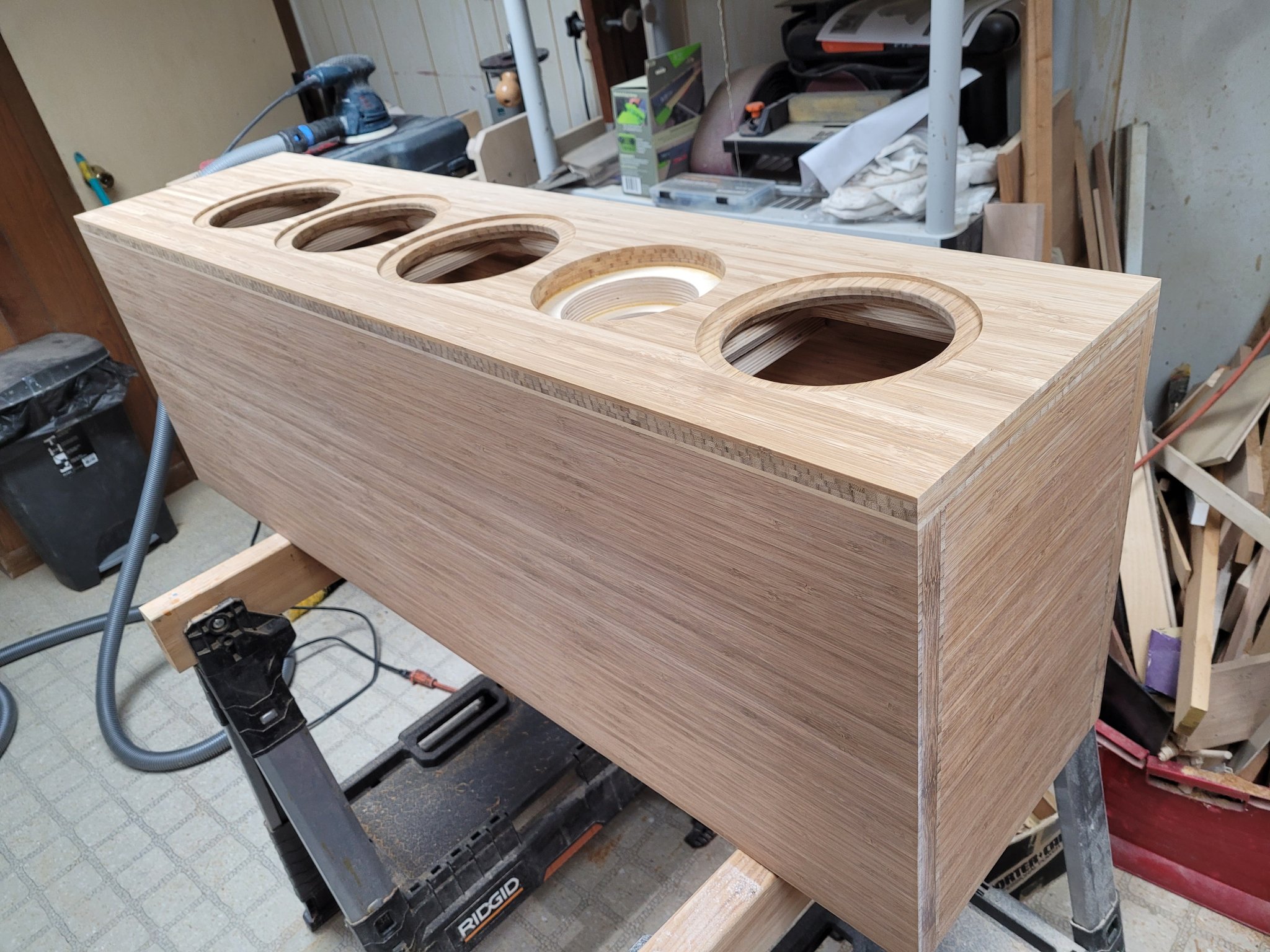

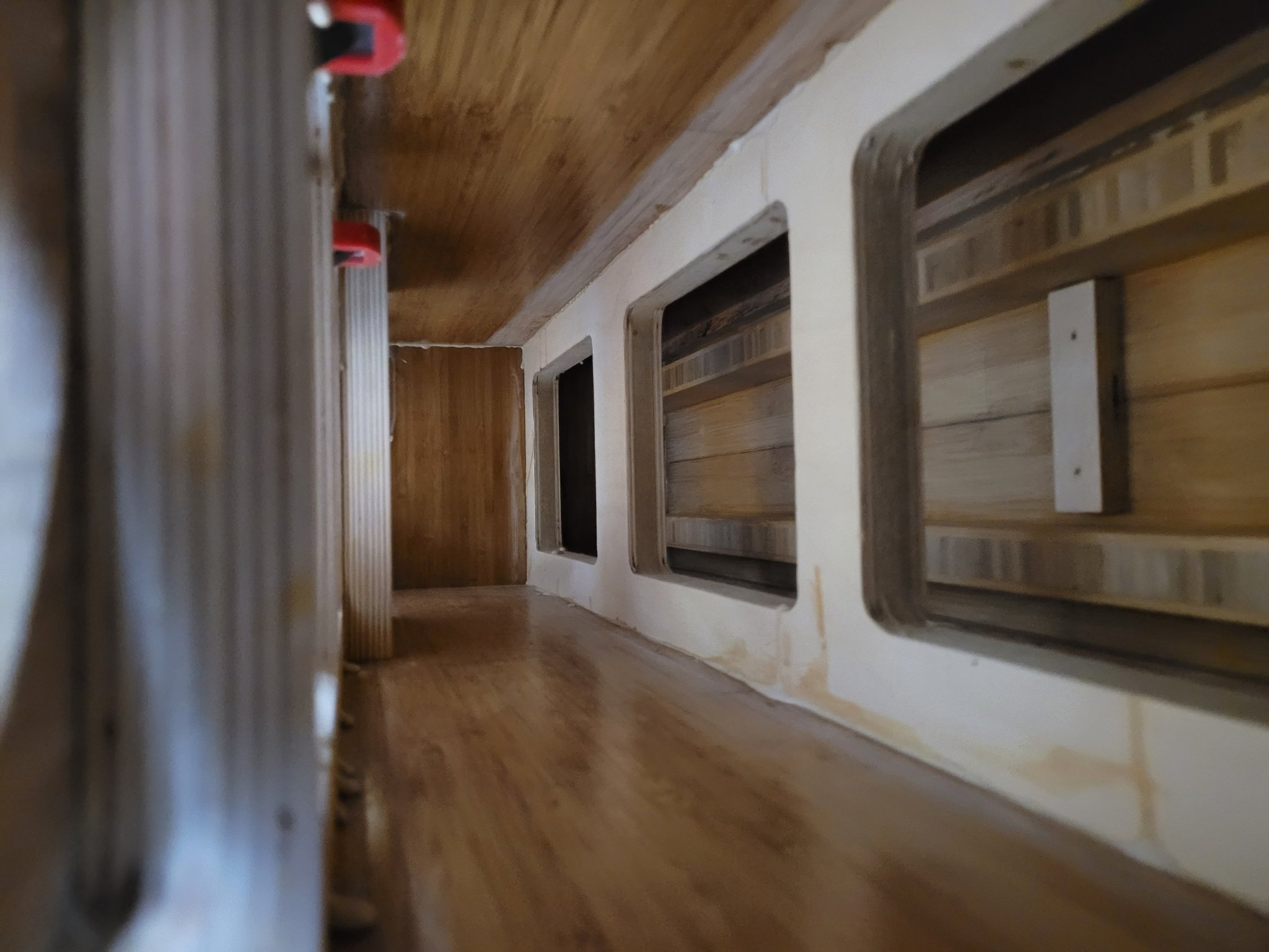

More progress on the first cabinet on my ULD build. All assembled and glued, I put a lot of care in fitting all the parts together prior to glue-up so everything fortunately fit perfectly with tight glue joints. Once the glue dries, then I will flush trim and sand the original finish off the sides (a really plastic looking gloss finish which fortunately sands off pretty easily). I kept the original finish on the inside surfaces except where I sanded to bare wood for the glue joints. Included an inside cabinet view just for fun.
Assembly of the second cabinet will probably in the next day or so.
David
