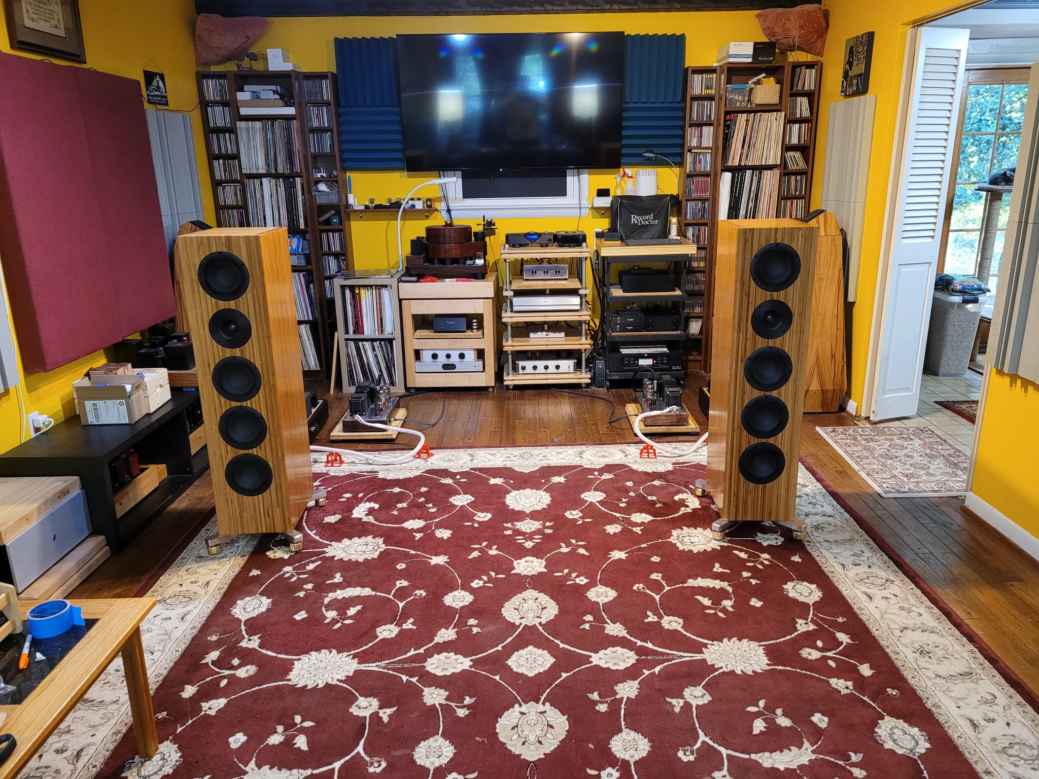

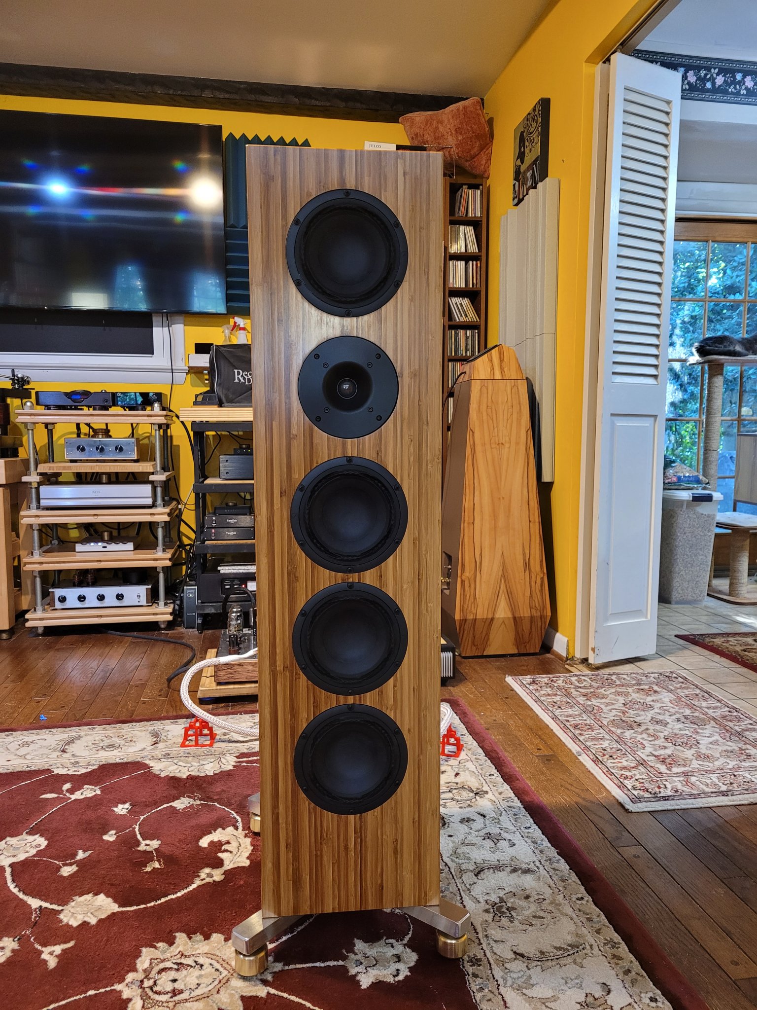

Just completed the build and they are in the system! Only an hour on them and they are incredible compared to MFC Elsinores. Just more open, relaxed and detailed. Really disappear.
David

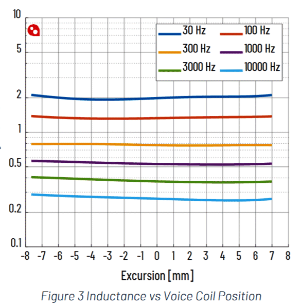

The Purifi approach to the motor is very different to anybody else. I has quite low inductance, but not as ultra-low as SB variants including the MW16P. But they are more constant with pistonic motion of the cone away from the rest position. So excursions means that the inductance is constant low for any particular excursion.
For more information on the Purifi drivers, if you are patient and hard core addict as some of us are, the video is nearly two hours long and the interesting things come in lumps here and there, so patience will be repaid. I think you putting in the time might be worth it to you:
This what the inductance look like in the Purifi driver at different frequencies.

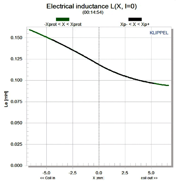

SB takes a different tack. even lower inductance but not as flat, it looks more like this:

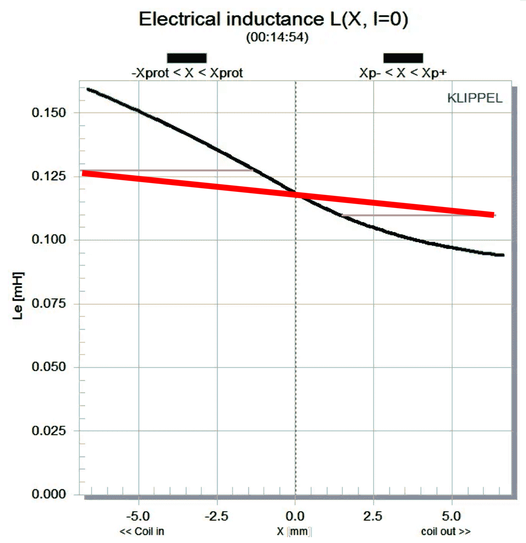

Inductance goes up as the cone goes in and inductance goes down as the cone goes out. That also indicates that BLi force is not linear with position.
But since we have four drivers, that means for any set SPL, the inductance gets flattened out to look effectively something like this:
So this makes all the Elsinores much superior to a single driver.
And: When we use Purifi drivers, even the Purifi's own results gets flattened even more again. But it is worth that all the versions of Elsinores do this and that even SB17 variations do well as they all use the same motor and has very low inductance.

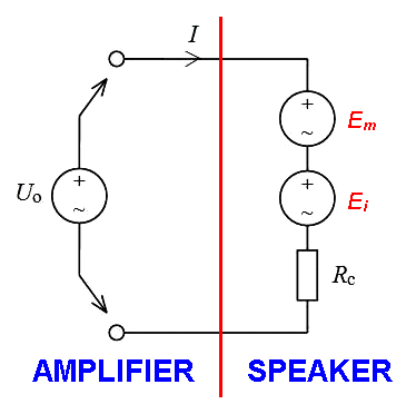

In the video link above, this factor is linked to AM type distortions. But it is the current that is being effected since many of the imperfections of the driver (and we all know that there are no perfect drivers) and the Force - BLi indicates that the i - the current of the amplifier is being AM modulated.
What if we could make drivers without any inductance?
Then there would be no difference between voltage-drive (common) and current-drive (uncommon, but does lower i induced distortion). Also, there are questions as to how well the amplifier that is charged with keeping voltage controlled, is able to control i induced distortions. This is something that is begging to be looked at and has not been. I am hoping to do something about this, a paper that will discuss i induced distortions in amplifiers. But I digress.

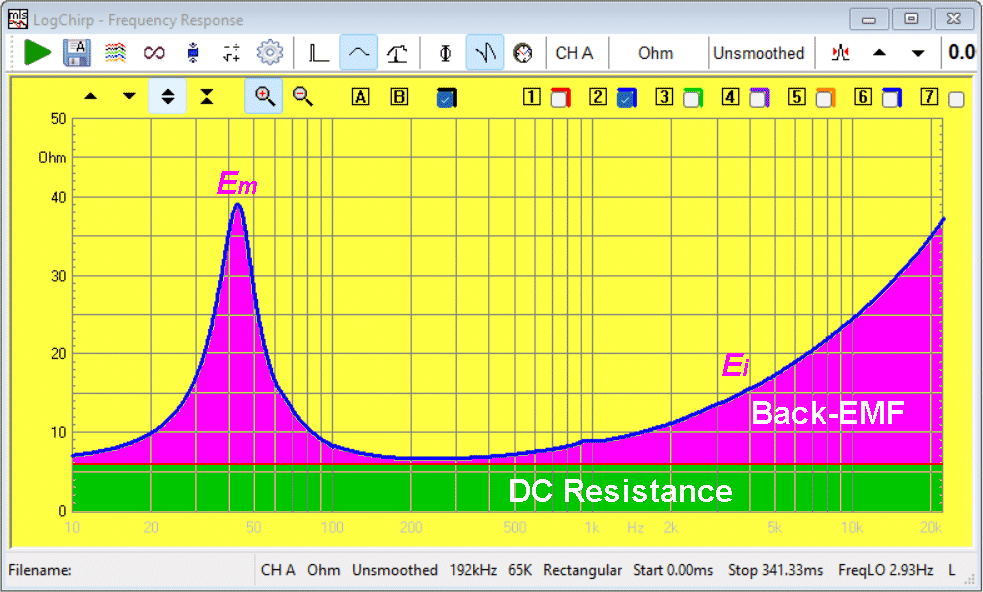

Ultimately, what causes inductance is just as Faraday explained, that current through a coil produces a voltage and this voltage leads to distortions (I am glad to find an increasing number of people who now also understands this); it is also called back-EMF. It is this voltage that tries to oppose (back-EMF is an opposing force) current with rising frequency, which creates the final impedance of a driver (typically measured in free air)
Ei is controversially both a voltage (a back-EMF) and an impedance that can be quantified in Ohm (I have gotten attacked on this point), but the above proves that this is correct. Opposing current is also implied in that it is called back-EMF. It is current that is being opposed and the inverse of that is impedance and hence Ohm'age.
Anything above the DC resistance show up as added Ohm in the impedance plot. The DCR is very stable, but with music the Ei part of the impedance is fuzzy and not as shown a nice clean straight looking line. It is not stable with excursion for a start (the Purifi is much more stable here) where it will go up with the cone going in and down with the cone going out. The Em is the motional back-EMF and here is less of our concern here. But an interesting discussion can be had about that too.
So you have motional back-EMF Em and you have Ei and they are all in series with the Rc resistance of the voice coil. But here we are concerned with Ei being a source of i current induced distortion of the BLi force. The Ei fuzziness needs to be kept in mind and be designed for.
If only we have perfect drivers with zero inductance, but alas Mr Faraday tells us that we can't.
I am a bit reluctant to bring up too much of this stuff, but I seem to get drawn into it and it is fascinating (and maybe even addictive) to ponder over these things and understand mechanisms that lead to distortion.
But it does show that there is a lot of underlying theory behind the operation of the Elsinore designs.
