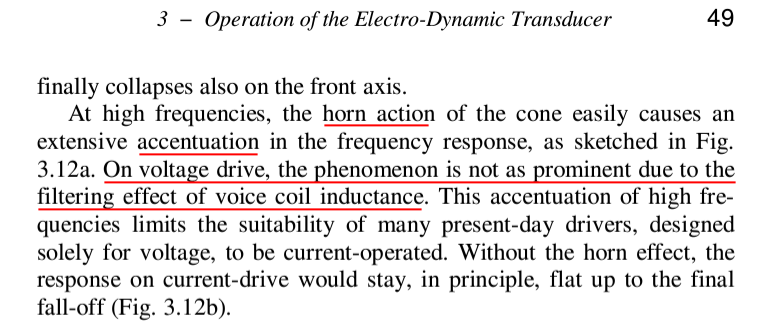

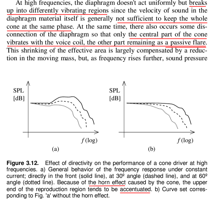

On Page 48 of the above link, see below. Read it slowly and carefully), there is a lot going on.
Note the reference to the flare above the reduced area of the cone ideally should cause the centre of the cone nearest the voice coil and then the outer cone will become stationary. That means that the out cone becomes a horn for the inner and closer part to the voice coil part. What he says makes sense. In our discussions we came up with the fact that we had differences. One is that I am into finding ways to achieve current drive based on a ratio that he agreed with and it is 5:1 - this ratio is not a magic number, but if you can isolate Ei (inductive) part of the voice coil by 5:1, then you have achieved the minimum requirement for current-drive (and its benefits). I can do that without resorting to current-drive. He says the only way it can be achieved is by using current-drive. But there is agreement on what current-drive is suppose to achieve. And I credit him with alerting me to the fact that what I had been studying was in fact a 'horn effect' and I give him credit for that.
A cone that has very much less horn effect is the ULD driver we use in Elsinore ULD:
Much shallower cone and it has an additional feature, behind the cone and around its perimeter, it has a mass loading ring. Applying Newton's Laws we now means a significant reduction of velocity around the cone's edge as we approach the horn effective frequencies. This reduces the radiation surface area above 1KHz. This further reduces the horn effect but you can still some of it and there is then the drop as you would expect. This mass loading by Purifi must have been something very deliberate. This is of course a 'soft' fibre cone.

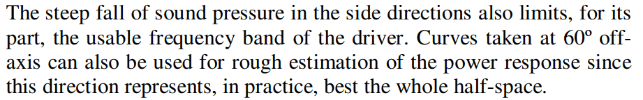

Below is the continuation after the clip I posted earlier. It should give you better context of the previous clip.
So he is actually complaining about that horn effect "accentuation" making it a problem when current-driving.

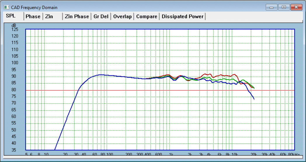

I see the horn effect as somewhat benign, if that is all that it is. If only an acoustic effect, a kind of internal diffraction of the driver, not assoaciated with any nasty (note qualifier) resonances.
I have developed a way of dealing with it. If the problem is only simple one, then I usually will usually design for the off axis (usually 15°) which takes off a big chunk of the 'accentuation' and certainly by 20°. Since I am looking for a driver where I can use a single inductor, this horn effect may even make it able to use a bigger value inductor. May is the operative word here. That kink I referred earlier may also come into play and prevent the inductor value getting higher and the kink may become to accentuated. But it may lead to a considered BBC dip. So it is a balance trick.

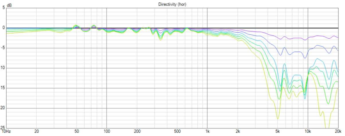

Above 15° off axis.
Above, family of On, 15° and 30° off axis. Use toe-in of the speaker to get the FR balance you need.

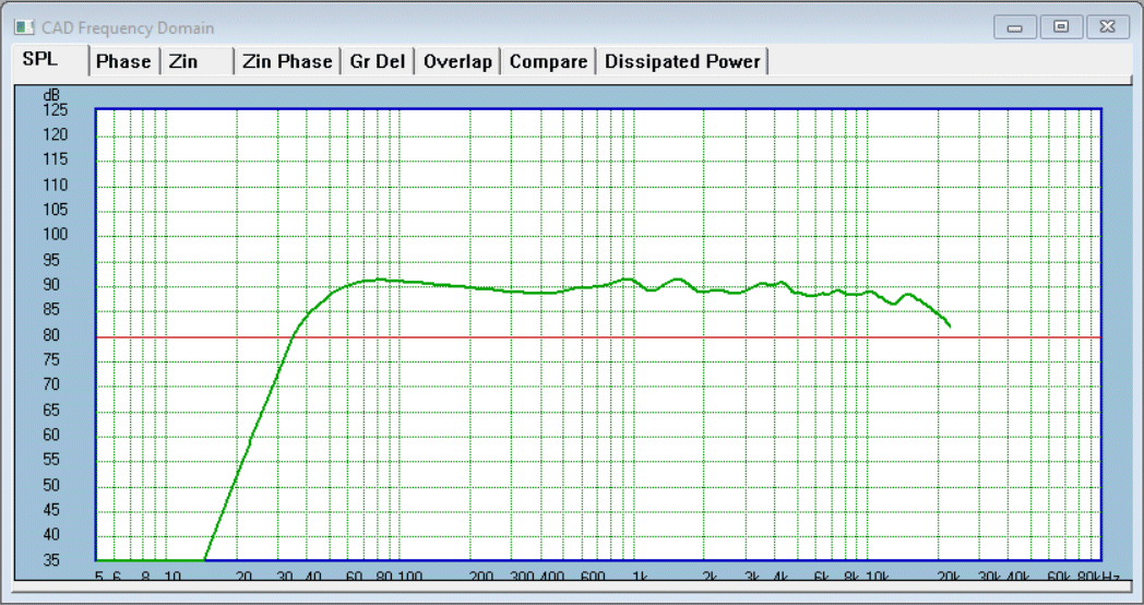

My reason for doing the above, and it takes a leap of faith to do it that way, is that I want a large series inductor do do current-drive like things.
Then I finish it off by EQ'ing the current seen by the amplifier.
Allen, please, trust me on this, the benefits is in the sound.
Doing it with LR4 crossovers (so easy to do in SoundEasy) and you get nowhere as good sound. I believe that I am getting the sound of current-drive, but without the downsides and a speaker that is totally amplifier friendly. Could it be that this is about making the amplifier sound better because you are isolating the amplifier from the speaker, and particularly those Ei current modulations that pollute/corrupt the force-factor that is related to the current of the amplifier. That is bad for the design and hence designing away from that results in better sound.

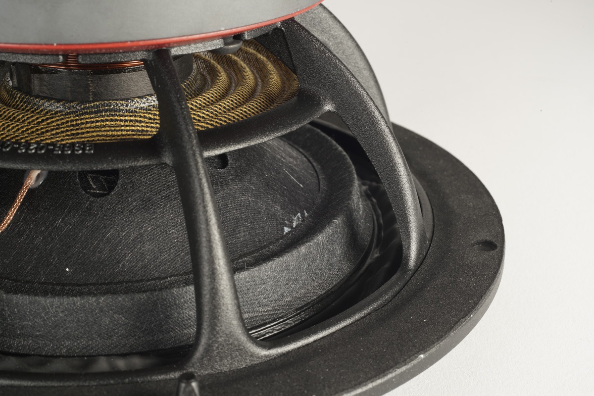

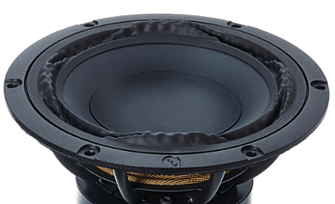

Just found this picture I must have taken as I found it on my computer. It is interesting as it clearly shows that mass loading 'skirt' around the perimeter of the cone. BTW, the cone is a lot heavier than other drivers and yet achieve good sensitivity (and efficiency) because of a very power motor (magnetic circuit) than other drivers.
Do we know this? Such a device could conceivably be used to brace against a non-axisymmetric compliance of the surround?that mass loading 'skirt'
Possibly. I do think that it did more than one thing, so I would not argue about that. I know that they relied on computer programming because of the number of variables. Change one thing and you change others, some even unpredictably.
You are excluding the contribution of the rubber surround. The surround makes up 20% + of the area of the driver. The surround is a large soft floppy piece of rubber.![]()

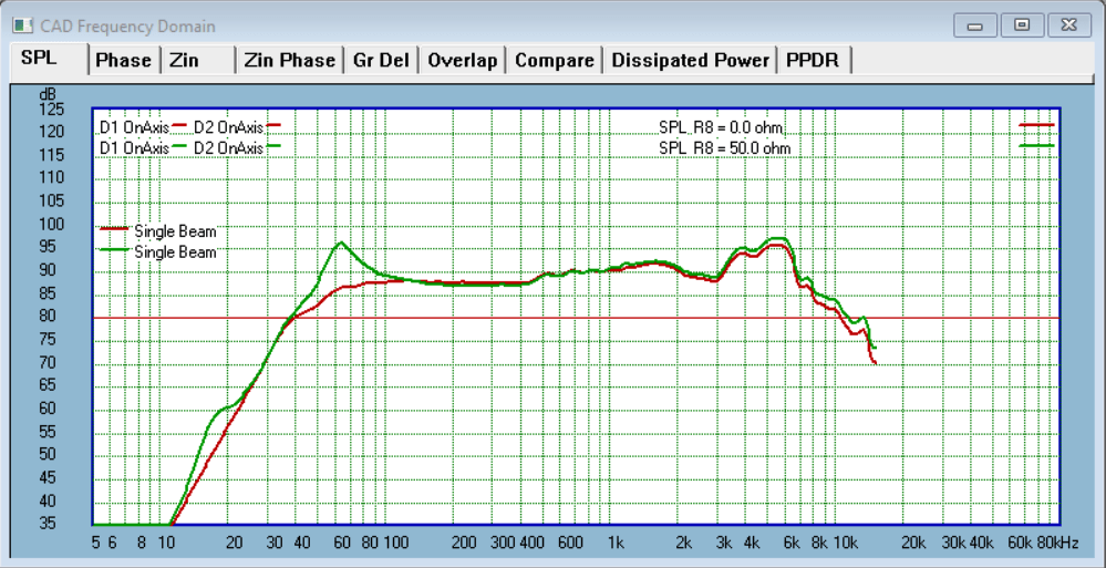

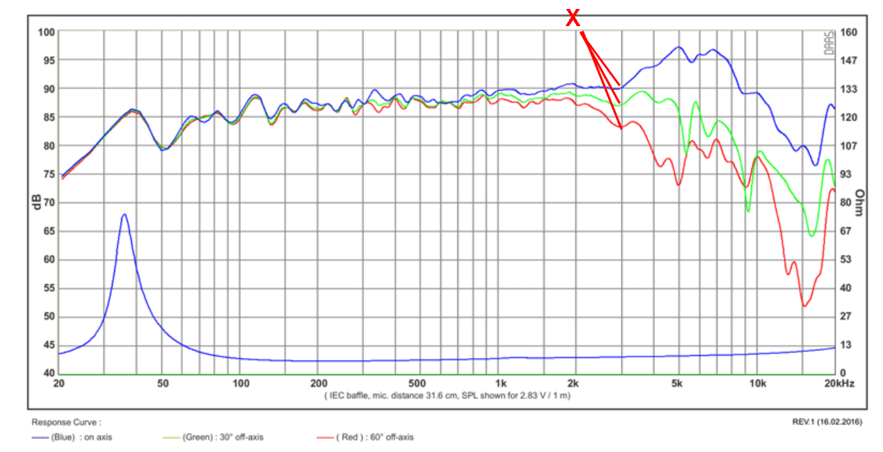

[Above is our MFC polycone and SB's measurement.]
See that "X" and I see one behaviour below and above that frequency. Note that dip? Very common, especially as this driver has very low inductance. The cone may be pistonic up to 1KHz or slightly above, but that kink is not 6dB down means that the cone has already started to flex and bend modes are happening (in theory the radiating area should reduce). I think this is what Allen says that it does not mean distortion even if the cone is not longer pistonic. Or else by that kink the response would 6dB down (Allen knows about Roy Allison who said a totally stiff cone would roll off 1st order). So in the MFC cone I see that it is predictable up to that 3KHz kink and ideally it should roll of controlled above 3KHz.
There is much interaction between the rubber surround and the stiffer cone.
If you are claiming adhortative insight into the behavior of the driver include the contribution of the surround.
Thanks DT
True. In the past I have made this point myself.
But the Purifi driver is the subject and I am sure you know that is quite different. It does not have an ordinary surround. It goes close to sum zero, hence 0% and not 20%. So that mass skirt undoubtably work together with what Purifi calls their "funky surround."
Adhortative? That's not a common word, but no, I don't think I was being that.

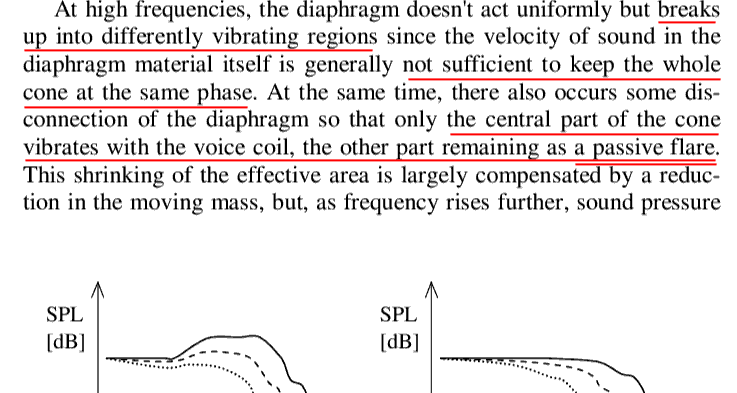

Uncovering more about breakup from Esa Meriläinen's text..
He refers to 'phase', where the whole cone is breaking up and taking part in the resonance, perhaps with the edge bending back and forth out of phase with the middle. The primary issue there being inconsistent polars..
He is talking about two things though, the second being 'some disconnect' of the outer cone.

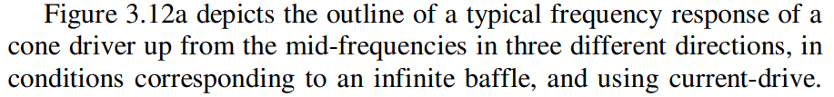

Esa's text leading up to that states Figure 3.12a shows results using a current source, so the top end is electrically inflated relative to the common case.
..and implicates the wider radiation determined by cone behaviour is one factor he uses to determine the upper usable frequency.
But it does not and many now assumes what they see above as breakups and resonances in the cone. That is not necessarily the case. Something else could well be happening...
Perhaps, but sometimes two things can both be right? As we get from the inner cone we have low mass that, as we get to the outer side of the cone, the mass also increases. That means that the outer part of the cone will deaccelerate according to Newton's law. This reduces the radiating area above a certain frequency and also helps of axis response. But I know that explanation is simplistic as there are certain to be cone bending modes, radial or circumferential bell modes.
But Purifi's mass ring around the perimeter does work and you can see it in measurements where even 30° off axis has less roll-off that I have seen in any other driver. But it also makes the Purifi cone heavier at almost 20gr, quite a bit, and it's sensitivity (the "W" version, not "X" version), but the motor is very powerful and keeps the sensitivity high enough (the "X" is much lower). It just shows they did it their way.
Esa is saying that it is only a problem when current-driving?

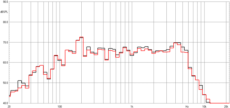

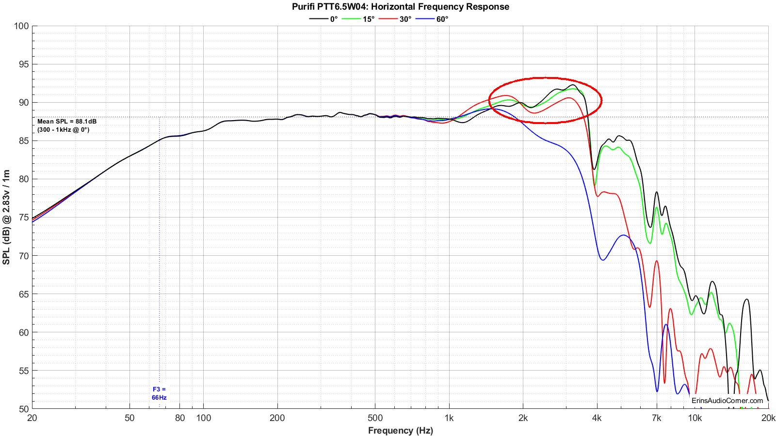

I have a good story to tell, so why not tell it. This is a subject that I have been interested in for maybe twenty years.
Below, this is a relatively recent measurement of a Satori 7" driver in a vented box. The Red is normal voltage (real) and the Green is current (simulated) to see the difference.
Yes, there is an accentuation. But it is still very there with both voltage, which makes my point. The accentuation is electrical, the horn effect is not.
BTW, note that 3KHz kink. It is very common.
Looking at the on and off axis (the above is on axis), I have drawn certain rational conclusions. Around 1KHz there can be a discontinuity is some drivers.
(Many years ago I measured a very expensive 6.5" Audio Technology driver worth $500 and it was definitely an outer surround problem at 1KHz.)
But that Satori, between 1KHz and 3KHz the response is not dying as if its cone was completely stiff (a la Allison). So there is definitely some bending here, and yet the response of the cone is dropping at 3KHz and would keep dropping, except above 3KHz something else is happening: The horn effect takes over that the response rises and peaks 5-6KHz. This change from cone roll-off to horn, that is what causes the kink. It is especially noticeable on axis - the above is indeed on axis.
But being an horn acoustic effect, when you look off axis and the CSD (waterfall plot to other readers here) shows that there is no serious underlying issue. To me, and my interpretation, that the peak is not a cone resonance, rather an acoustic effect due to cone shape, and it certainly has an obvious horn shape as only the inner, closer to the voice coil, is radiating the primary sound and the horn is secondary.
Summary: Between 1-3KHz we are looking at the cone area reducing and above that, the horn effect takes over, whether voltage or current.

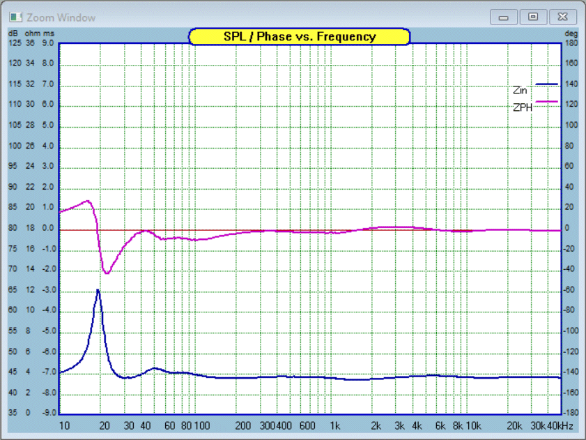

Even If the "horn effect" is not electrical it would be reflected in the impedance plot, which it is not.
There would also be discontinuities showing up in Directivity Plot if the cone were flexing as you say.
I am going to use the word 'reflected' in a slightly different way, please bear with me.
I do believe it is 'reflected' into the electrical impedance. But that does not mean that it shows up in an impedance plot as you say.
In my opinion (and I am not the only one) all the electro-acoustic-mechanical deficiencies of the driver gets reflected back into voice coil and modulates the Ei part of the impedance. Since all parts of the impedance are in series then the overall impedance changes.
I know that Esa Merilainen in his own words had said something similar. I would welcome his comments here, if that is possible. These Ei modulations is what current-drive is supposed to fix. If the driver was perfect and no deficiencies, then current-drive would not fix anything. But reflections back into the voice coil is a large issue.
But if doing a measurement plot, sweep frequency or whatever, it won't show up there. It is too static?
