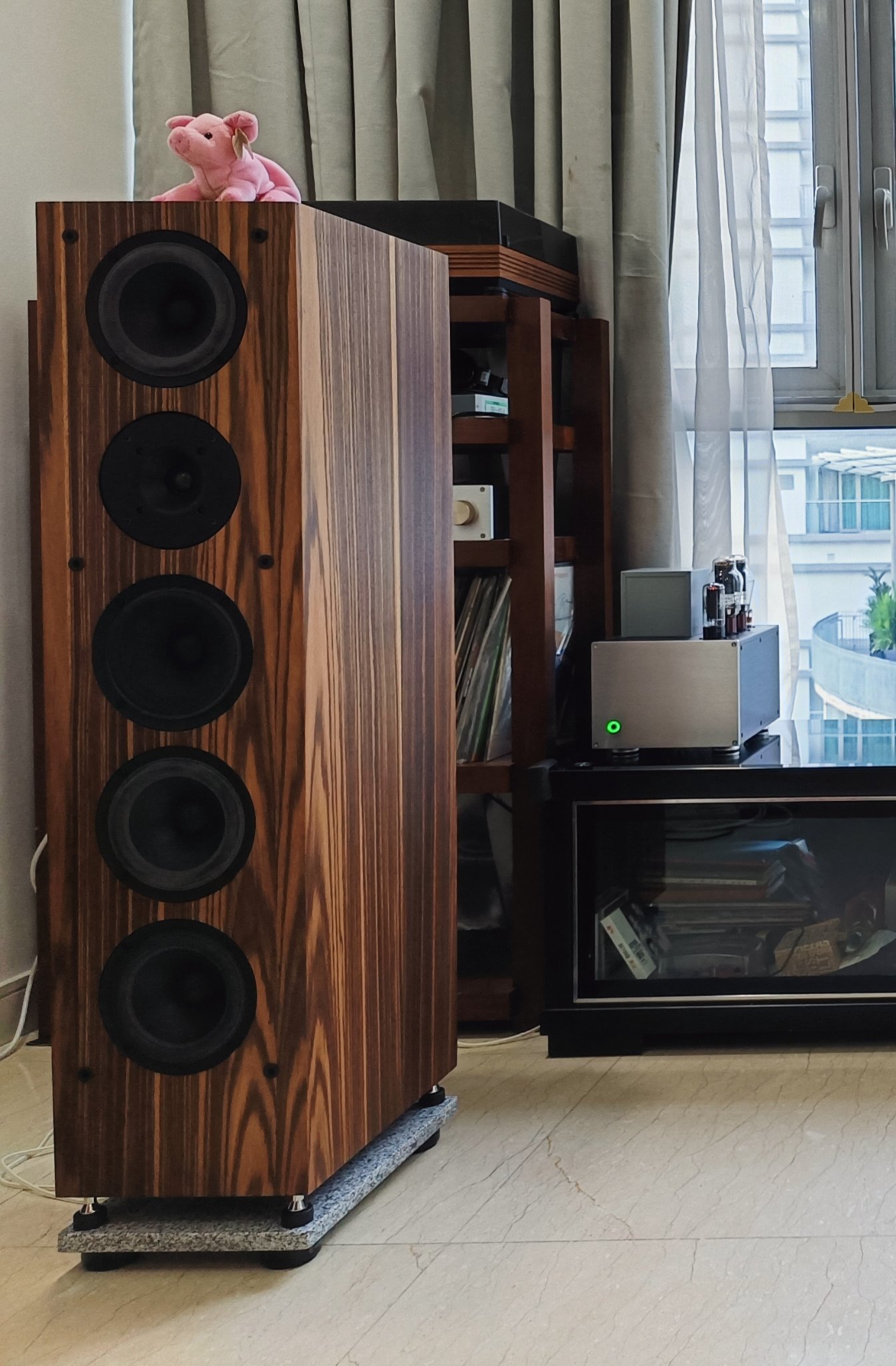

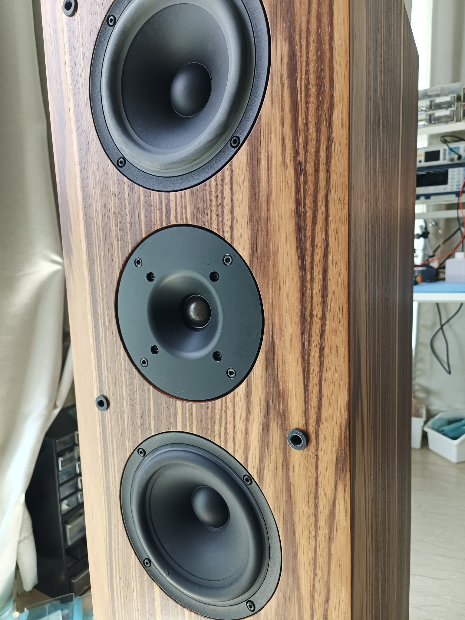

Hi, just to share my recently completed Elsinore. This build is version MFC, mainly because I collected the parts since 2017 but I only managed to complete it recently. It uses the earlier waveguide sourced from Joe, made from what could be HDPE (I stand corrected), the material is dense, sonically inert and the throat fits the tweeter perfectly. I highly recommended getting this!

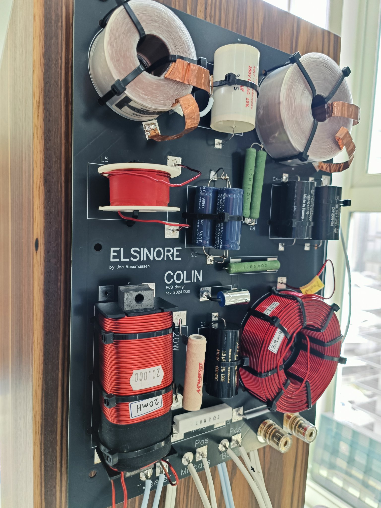

I made a few deviations, for example the crossover is mounted on the rear baffle. Initially the crossover is wired p2p, but I eventually made a custom PCB for aesthetic reason. The baffle is veneered instead of ‘the standard’ gloss paint. I believe this does alter the character a bit however the matte veneer finish is easier to maintain. I’ve also added protection screen which is normally not mounted.
What I find the most interesting aspect of the design is Joe’s philosophy to crossover design, this is refreshing but regretfully many debates I believe are coming from keyboard warriors. I adopt hands on approach-just build it and try. First I omitted the resonant compensation for the woofers, it sounds like any normal bass reflex, warm round notes, the port tuning is not sluggish or distorted but pleasant enough to be enjoyed. When the compensation network is wired up the bass is tighter controlled, each notes have dynamic contrast which is most discerning on acoustic bass like ‘Spanish Harlem’.
By mistake I initially wired the tweeter with wrong polarity, nothing sounds discerningly wrong except a bit dark sound. However after correcting this, there is better low level details at low volumes and a deeper soundstage. I can give my thumbs up to the ‘Renegade Tweeter’ theory.
From my subjective comparison with commercial speakers, the Elsinore can stand heads on with 10-20K USD range. But where this design stands unique in a class of its own, is the true ability to produce deep bass and control from low powered tube amp. To my knowledge no high end speakers are made for tube amps anymore (aside from the horn, but that is another direction in sound). This puppies have no problem producing bass notes from Metallica with speed and musically.
I’ve been reading on the design since day 1, only to lose track on the more recent upgrades to Purifi drivers. Special thanks to Joe for generously sharing the fantastic design and making it accessible, and his tireless decade of refinement from the original design concept! Joe, if you are ever in KL Malaysia please drop me a message for free beer.

Congratulations on competing your build - the speakers look beautiful in the veneer you have chosen.
My understanding is that gloss finish or matte - it will not affect the sound of the speakers. 🙂
IIRC Joe's waveguides are made of a material called Acetal / Delrin; I agree, the units feel solid in the hand and the finish is very nice too.
Reactions: skyraider

First: WOW! What a beautiful build. Love the grain.
Some time ago I ran some simulations in 'SoundEasy' that revealed, backed up by real numbers, that any change in dB-SPL was directly linked in to any change in the current through the voice coil. They, current and SPL, were locked together. Now it is no hard to figure out that those compensation networks, each one is tuned to a frequency. It goes without saying that when the summed impedance is made flat, that there is far more current going through the LCR compensation network at that tuned frequency, than current going through the voice coil. In fact many times more current. Now I will just leave it there by raising the thought, as to what that does to the dynamic stability of the system and that the bass tightens up, becomes more tuneful and noticeable better dynamic contrasts. Maybe hint that 'SoundEasy' thinks it is dealing with a nominal driver with perfect behaviour, when in fact the driver is not like that and that it is one thing to point out how things ought to behave and how they actually behave. Stabilise the current and you will hear a difference. I encourage others to try do the same.
So thanks to pointing to that area, and that it isn't just about getting a flatter and prettier impedance curve (which some have said and yes it does look pretty, lol). There is, I believe, underlying stuff going one that it yet to be fully appreciated. In the meantime I just tell people, as far as possible, make the amplifier produce the same current into all frequencies and the Elsinores pretty much does that from 25-30 Hertz and up.
So I hope you will have many happy hours of listening and that I might also add, as you change equipment, and we all end up spending more don't we, then the Elsinores will step up with those changes. Also, later you have the option, even if it is not cheap, to try using the Miflex, a lot cheaper than going to the Purifi drivers. Cheers.
