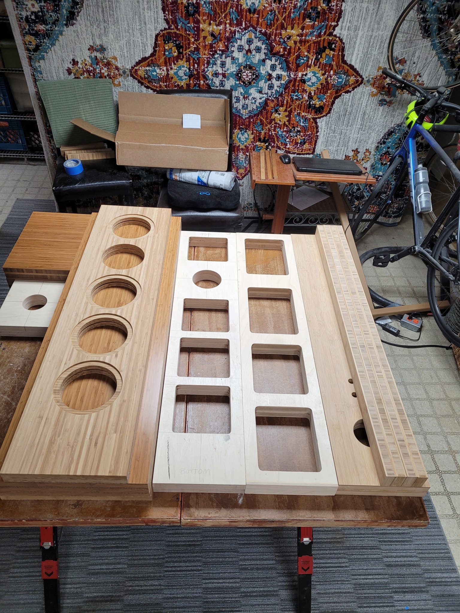

Progress report on my ULD build. Just finished with cutting and routing out all the panels. The cabinet is 1" bamboo plywood, except for the front baffle, which is 3/4" bamboo plywood. The sub front panel is 24mm baltic birch plywood (2-12mm panels glued together in a press) as well as the tweeter stiffening panel. The main brace is a laminate of 6mm baltic birch ply on the outer surfaces and a 1/2" MDF core. I was actually surprised that an unscientific rap on this composite (identical sized) was a higher pitch than 24mm baltic birch. I didn't weigh it, so don't know if it is stiffer or just less massive.
I have a little work to do prior to starting assembly. On the East Coast of the US, the most practical and cost effective way of getting 1" bamboo plywood are pre-finished desktop/countertops, which ships free to a home improvement stores (Lowe's) as easily to handle 60"x30" panels. They have a poly varnish, so need to strip off the finish for glue-up. The shipping cost for full sheet (8'x4') panels is several hundred dollars on top of the $200 to $300 cost, and since they have to be transported via truck, I am responsible to get them off the truck at delivery, which is more than I can handle Yes, I probably could have used BB, but even that is expensive and difficult to find now days given the Russian embargo. I wanted to use a superior panel material after my experience building MDF cabinets on the MFC build a few years ago.
Anyway, picture of the parts.
David

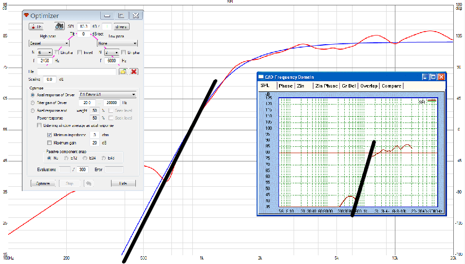

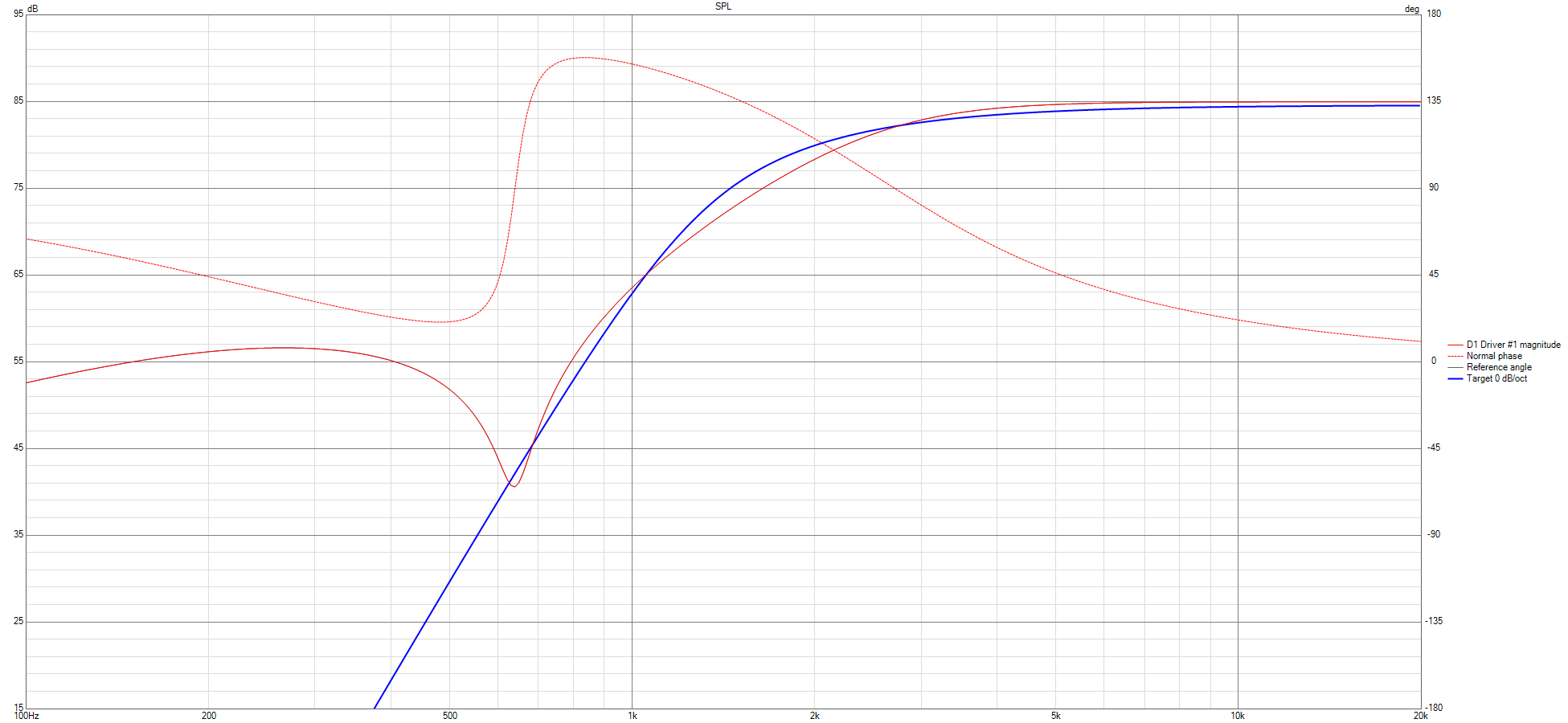

Where the roll-off is steepest, it's 26dB/octave, and then for about 100Hz or so. That's 10dB/octave short of 6th order. There also seems to be a bit of a downside in that at below about 600Hz the filter network is providing a lot less attenuation than the desired target function response. Maybe it would have been better to include a twin-slope approach to the target function, with an initial 3rd-order/4-order fitting response, followed by a 5th-order/6th-order low-frequency fitting response below some chosen frequency. The total component count would likely have been similar.In this case a sixth order rolloff for reduced excursion, and a third (or forth) order fitting phase response.
I went back and checked it by drawing 36dB/oct slopes on the plots, the one on the left is the model and the one on the right is measured.
I agree that it's not a precise copy. Some areas where there is room for deviation.. the notch filter doesn't have orders, the resistance of the inductor and vituixcad smoothing. I took the slope asymptote further down in frequency than you appear to have, as it's where the slope stabilises.
In any case this is not what was being demonstrated. As I'm going to point out on the other thread, the tweeter has an standing 12dB/oct slope before the crossover is added and that resumes where it deviates below 700Hz.
I misread the graph, and you are quite right – the slope is 6th-order over a large part of its range. Once the magnitude response starts diving into the notch, the slope becomes even greater, about 8.5th/order. In any case, the target response is a 6th-order high-pass Bessel response, and the simulated response lines up with that over most of the range.

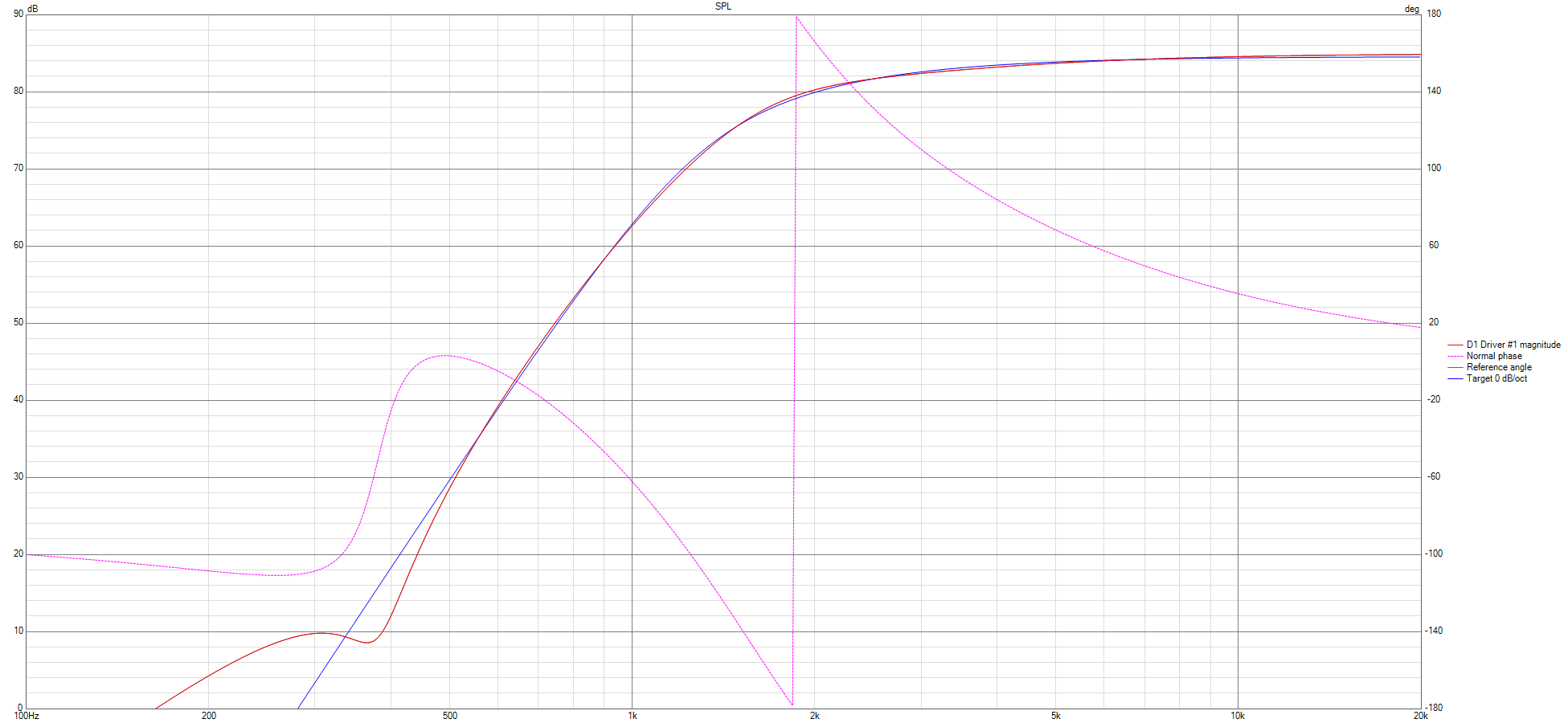

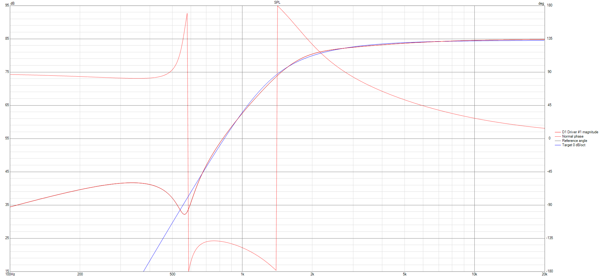

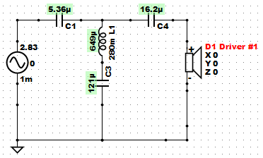

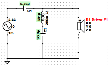

Here's a simulation of the response obtained with the circuit including the notch filter leg, after some optimization to compute suitable component values for an 8-ohm resistive load. The target response was a 6th-order Bessel high-pass filter with a cutoff frequency of 2450Hz.
Adding an extra capacitor produces a markedly better fit to the target 6th-order Bessel high-pass response. As the magnitude response is matched better, it might be expected that the phase response inherent in the chosen target function is also more closely matched.

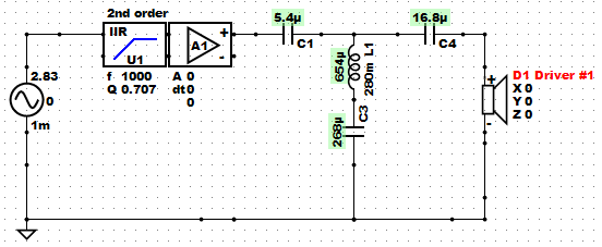

I've added a 2nd-order high-pass response function for the tweeter, with a −3dB cut-off at 1000Hz to the model in the previous post. The circuit and the optimized response that was obtained are shown below.
Adding in an extra capacitor produces the following result, which is a better match to the target function. Note that the notch is now much less sharp, and is also much lower in acoustic output level.
