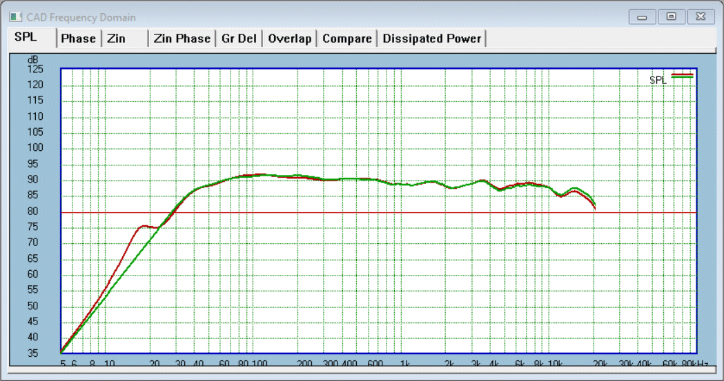

Green is voltage source and Red is current source. With the latter, the enormous power handling at LF will only be slightly less. I don't you will even notice it.

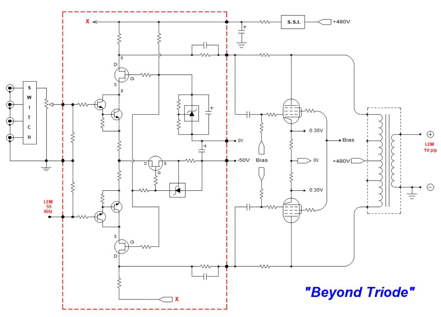

But what I am listening to looks something like this, where the EL34 output tubes only have 1.5x gain, so almost running the tubes at unity gain:
Bet you won't see a circuit like that every day. I would put this amp up against pretty much anything. The input converts voltage to current, which is the current that drives the Power Fet which is 'grounded' signal-wise (+35V). The non-linear Gate capacitance is suppressed because there is no signal on the gate, very wide bandwidth. I had somebody at Power Electronics in Segunda California (part of Tesla and SpaceX), computer model the circuit. It is phenomenally linear and low distortion and no feedback is required. I wish everybody here could hear this amp into a pair of Elsinores.

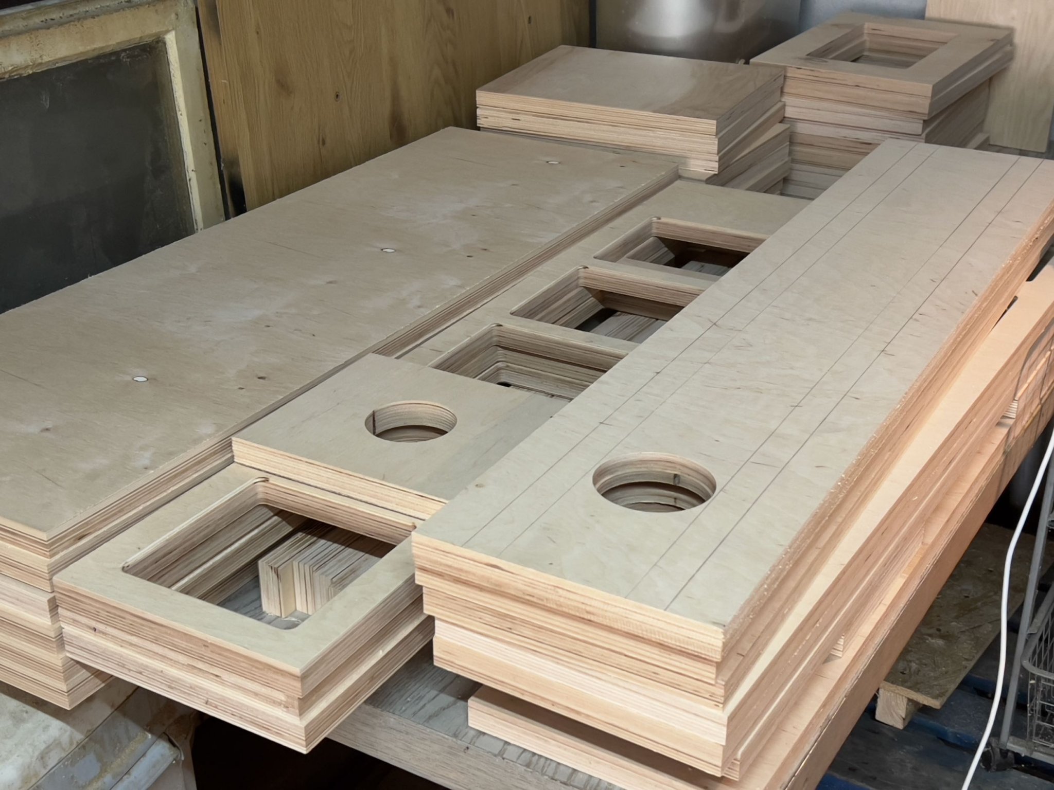

Many thanks for the quick reply. I struggled with my wood work because I intended to do it perfect. But I am no carpenter. Beech multiplex with a front made from Panzersperrholz. Nice contrast. The mistake was the glossy boat paint, nearly impossible for me to get a perfect surface.

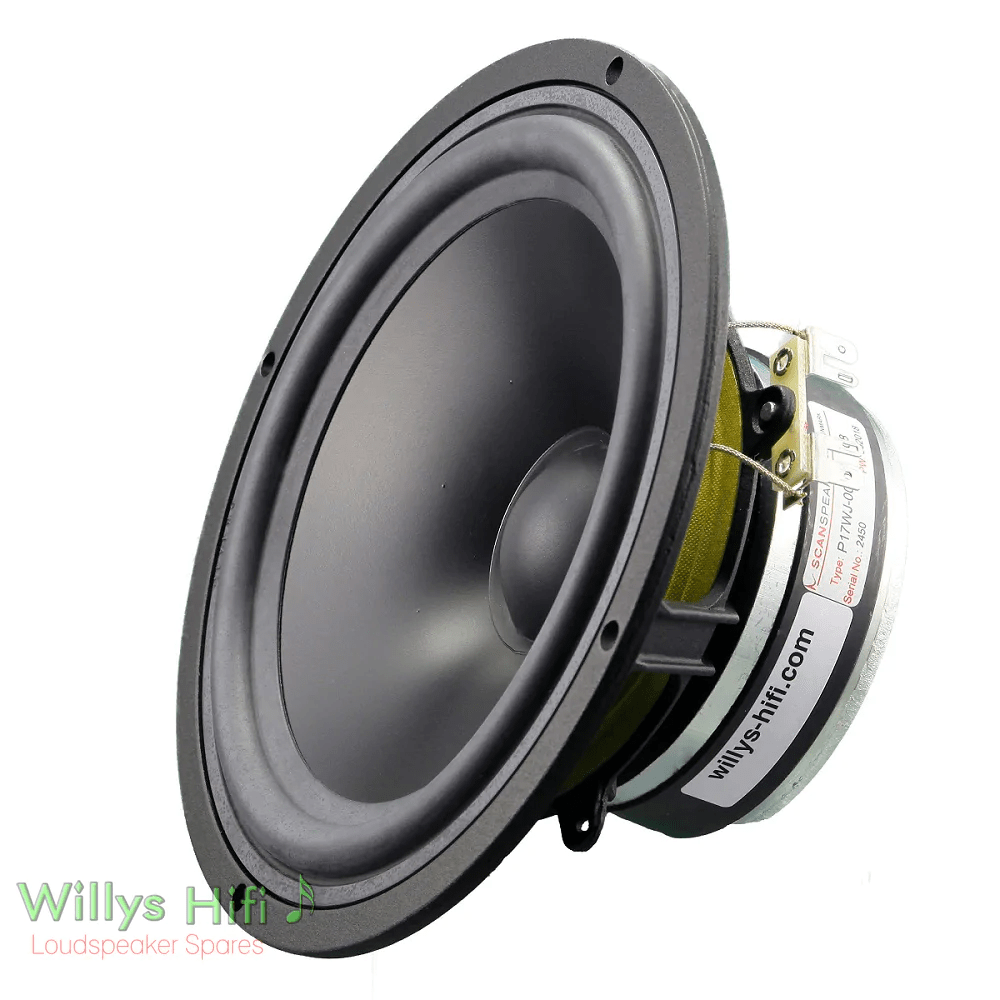

I am putting a test jig together and a very carefully selected driver I have brought in as a reference, only for testing purposes. Basically it has to do with the inductance of the driver, it must be just right. You cannot use a resistive load, or dummy load for the tests in mind. This has to be a real driver with moving parts and a less than stable inductance. Measure the inductance at the rest position, then when the cone is pushed in about 4-5mm and the inductance goes up and when the cone is pushed out 4-5mm, the inductance goes down - we now know that this driver has a non-linear force factor. I have found a driver with just the right parameters (at least I hope, but I have done my homework).

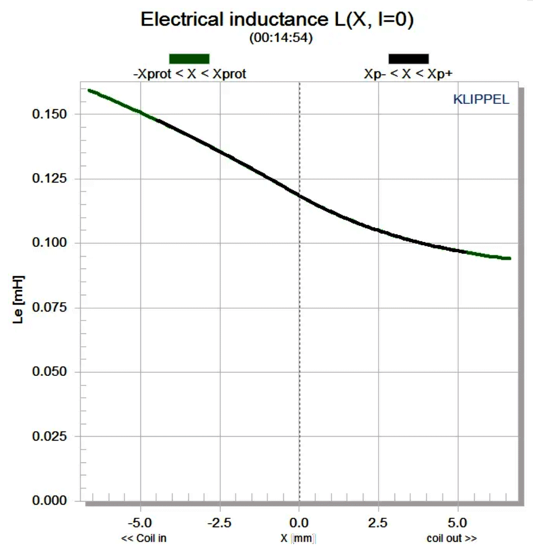

Above is a good driver, but not Purifi. The inductance here at 0.0mm is about 0.11mH and that is too good, too low for what I need.
This is what I have acquired and it looks just right.
Vifa P17WJ08
Three positions, there are different values of inductance.
Rest:
In:
Out:

Take a close look at those inductance measurements above. An unstable inductance as shown in post #4807 and we see a variation in inductance by 19.5% and what does that mean? Let us round that out to 20%.
THAT 20% INDICATES MASSIVE CHANGES IN FORCE FACTOR (BL) WHEN LOW FREQUENCY AND HARMONICS PLUS MIDRANGE ARE MIXED!
20%!!!
THIS IS ABOUT FORCE FACTOR BL DISTORTION!
And the force factor is directly related to the current coming from the amplifier.

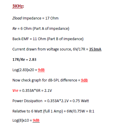

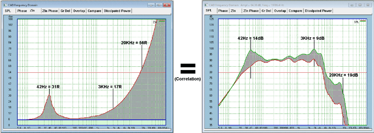

At 3KHz you get 9dB less output with a voltage source compared to a current source. That voltage now shows up inside the driver's impedance as Part B of the overall impedance:
Note the "V".

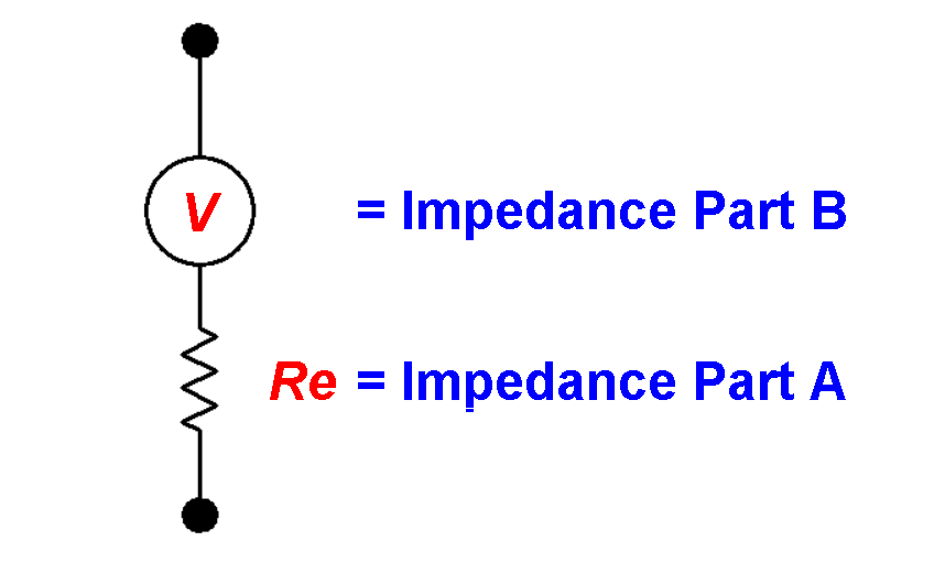

At 3KHz the Part B of the impedance is actually inductive-EMF which shows up as a voltage. As such the voltage/impedance now reduces the current relative to the full current of the current source.
I still remember the day that this dawned on me. I did the measurements, I also modeled it and developed the above maths. I then presented it to somebody that worked as both designer and scientist for a major Scottish company (you may guess) and he said he could not fault it.
Again, take a look below:

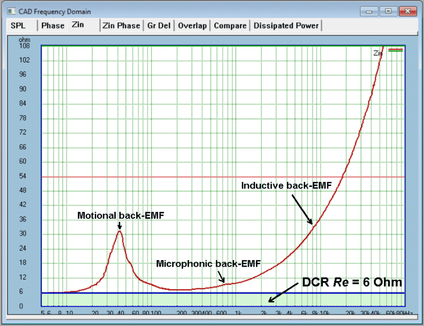

Standard graph of a driver that I have right here. Did the measurement. Note the bottom light green area. This is the DC resistance of the driver, the Re = 6 Ohm. All the above calculation and the difference between when this driver is both current source driven versus voltage source driven.
Any impedance above Re = 6R is some form of EMF, electromotive force, both in Ohm and in voltage. The impedance rise above Re is a force as in EMF, the F stands for force is always a voltage!
Yes, EMF, is a voltage.
This is back-EMF and it opposes the current and hence acts as an impedance.
Both a voltage and an impedance at the same time?
Pointing this out elsewhere got me into a lot of trouble and ridicule. But I went to people who know their stuff and pointed it out and they had no problem with it.
BUT...
When we use a current source, that EMF does not act as an impedance. Yeah, it does not impede the current. The voltage still shows up, but it will not oppose the current. It will no longer act as an impedance. Hence in the comparison graph above, the output with a current source is always higher than a voltage source.
The difference in SPL output in dB is directly related only to the current!

About the Vifa driver, yes you are absolutely spot on about the qualities it has and why I do believe it is a good choice. And yes you are right, my current source amplifier will definitely be used in the protocols that are being devised.

The interesting thing is that this 'voltage' is still there, even when the amp is a voltage source. I know this is hard to grasp, but that voltage is always there.
I even supplied the maths:
Note the "V".
BUT...
The maths I presented proves it down to 1mA resolution and I can better that if I tried. It just works!
I wonder if you can see and grasp the above. It is not easy. But it is logical.
It took me a while to do just that, but then Menno Vanderveen said that "thinking current is hard" and it is. Have you ever seen a negative of a print? It's hard to make things out because everything is reversed. The same thing when thinking about current, often it is the opposite to what we would normally think. Voltage is familiar English and current is more like Chinese.
The worst that can happen is that I fail. 😳
But seriously, some measurements have already been done and these are already in line with where we are going. So that is confidence building. Also that this is very much science-based and I have several scientist friends looking over my shoulder - so we are not examining some magic pudding, right? 😎
Cheers, Joe
Note the "V".

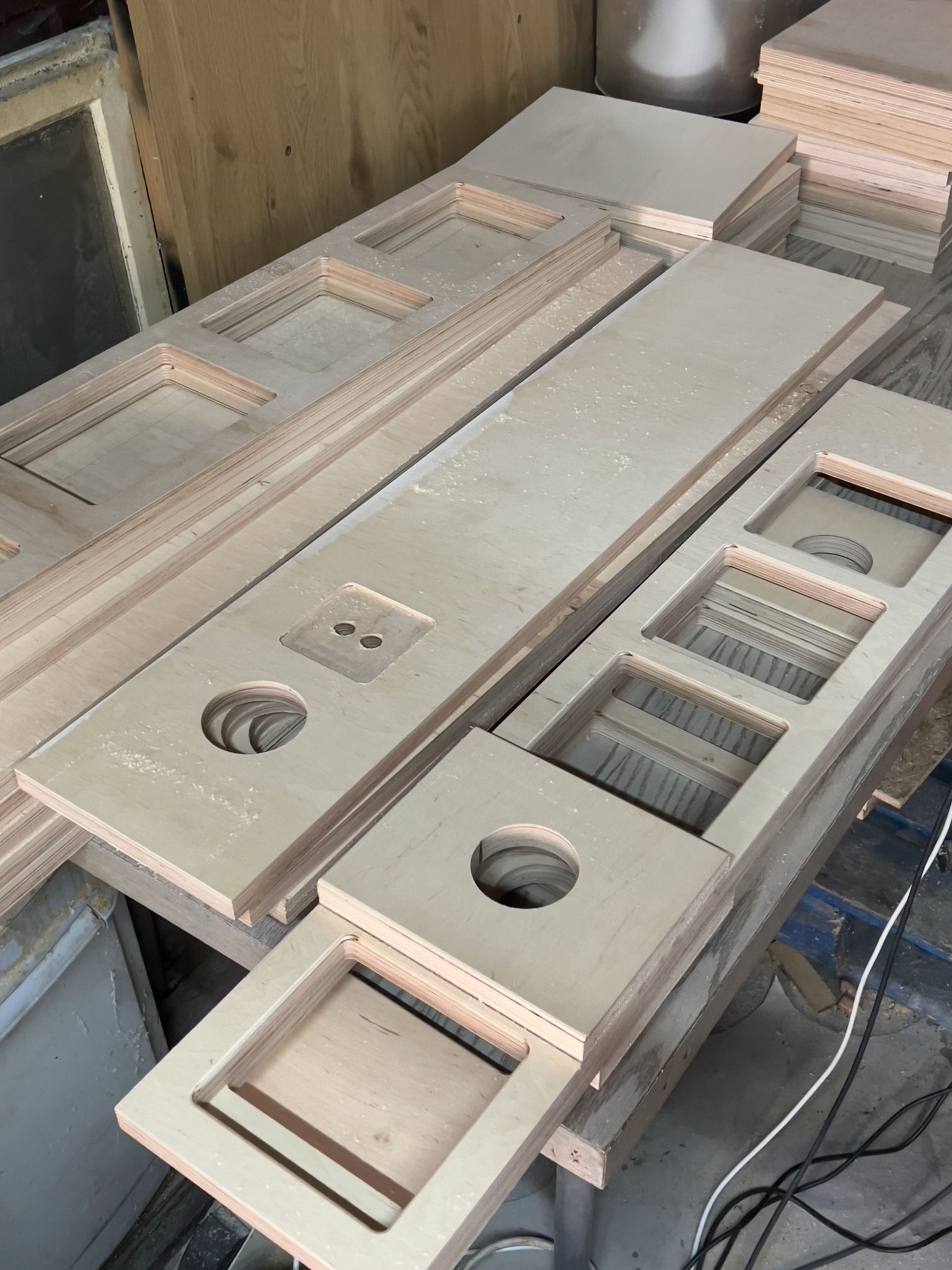

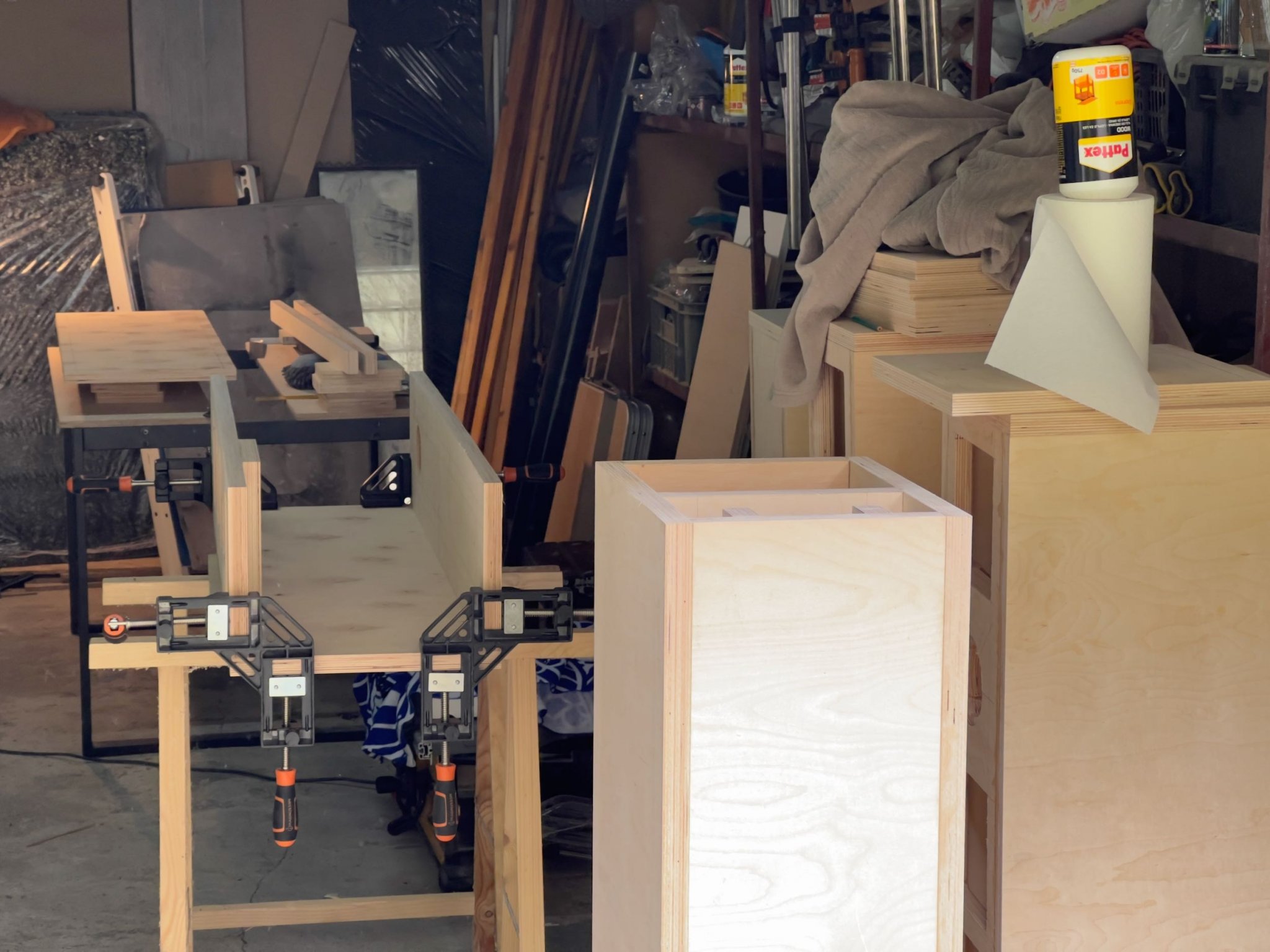

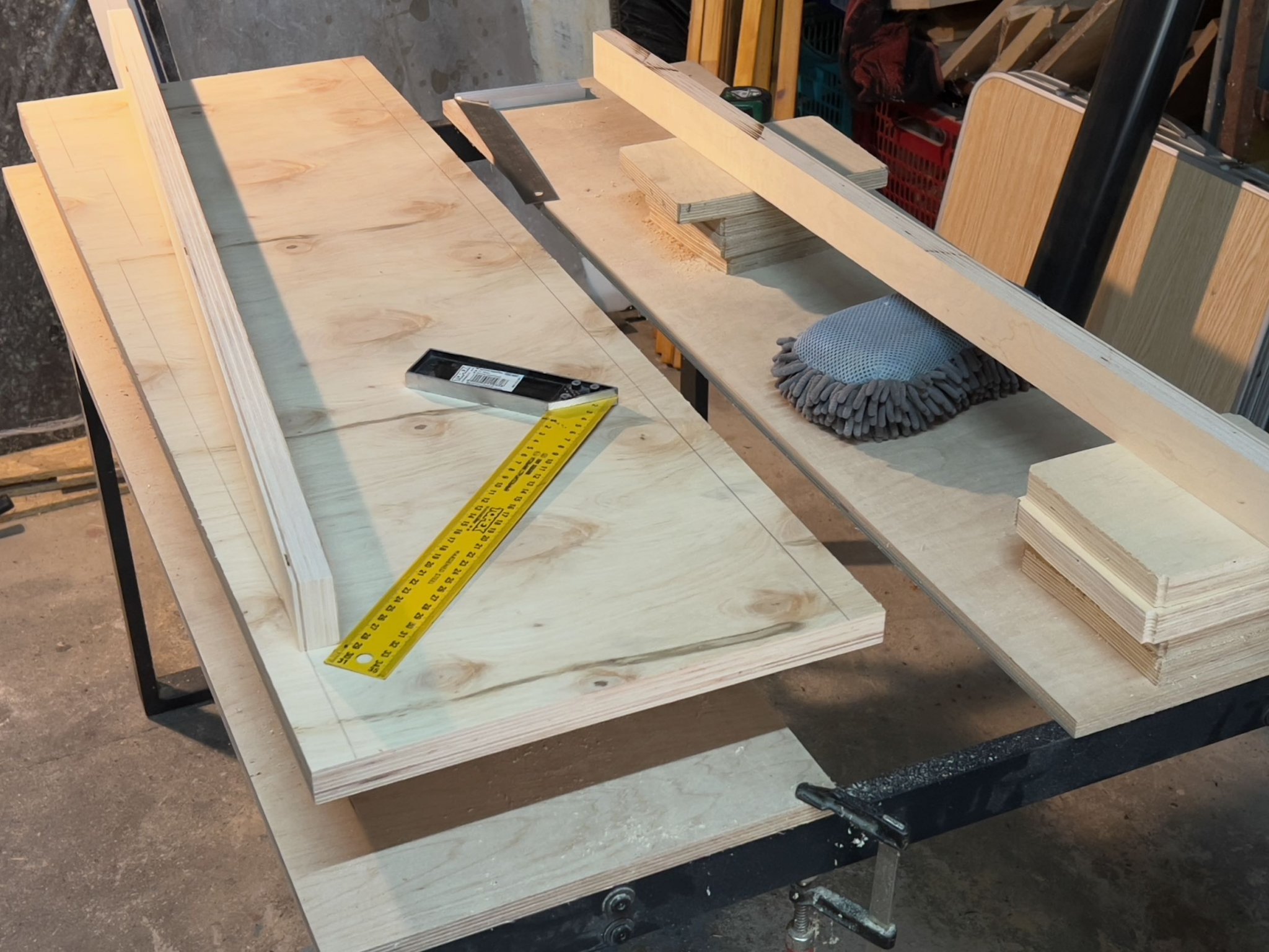

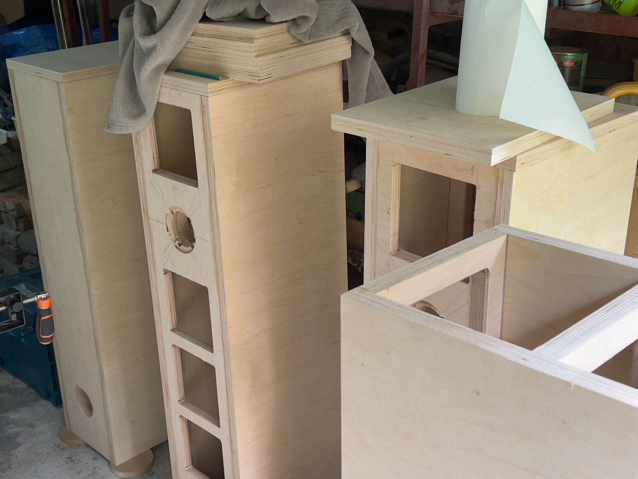

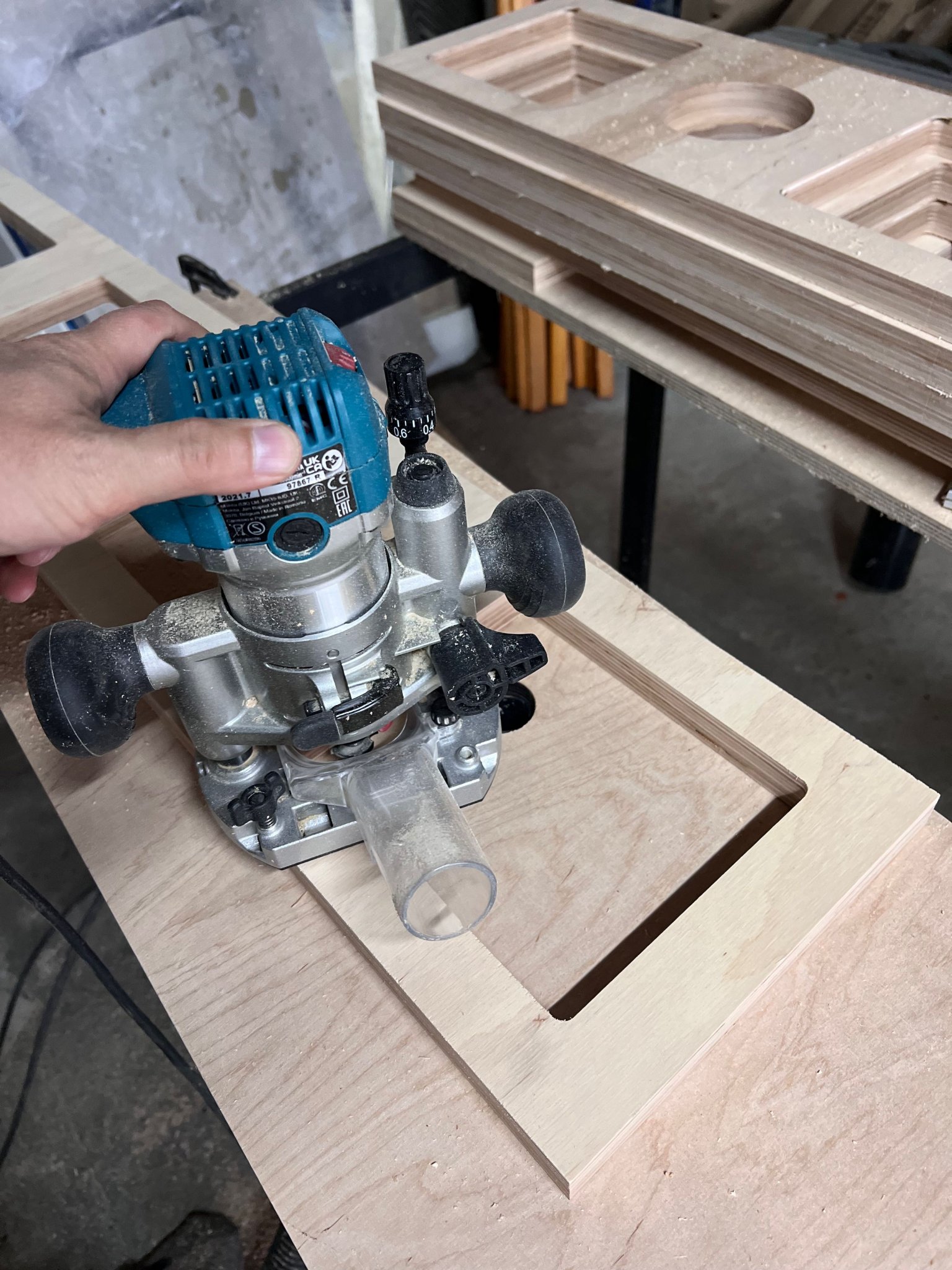

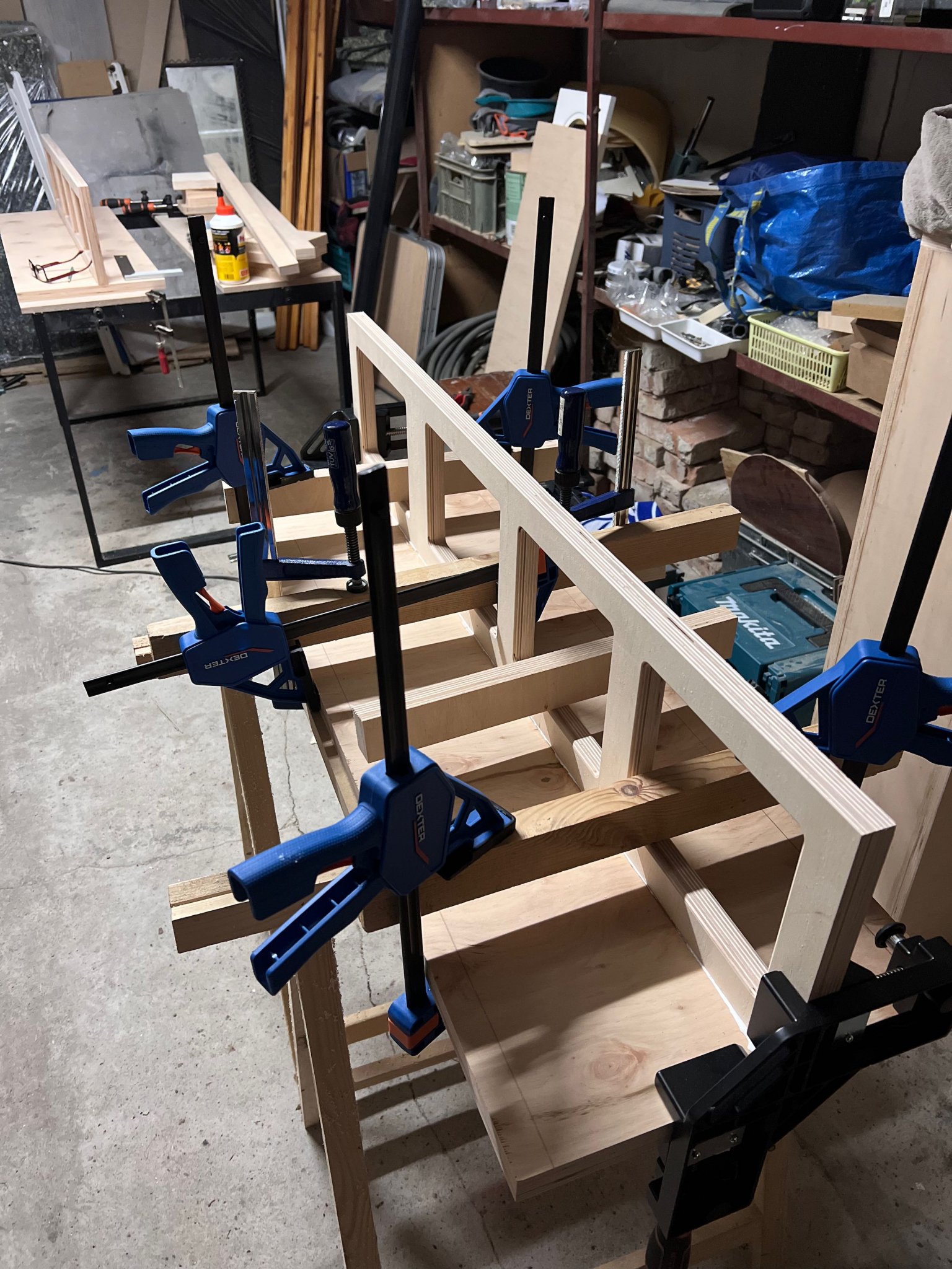

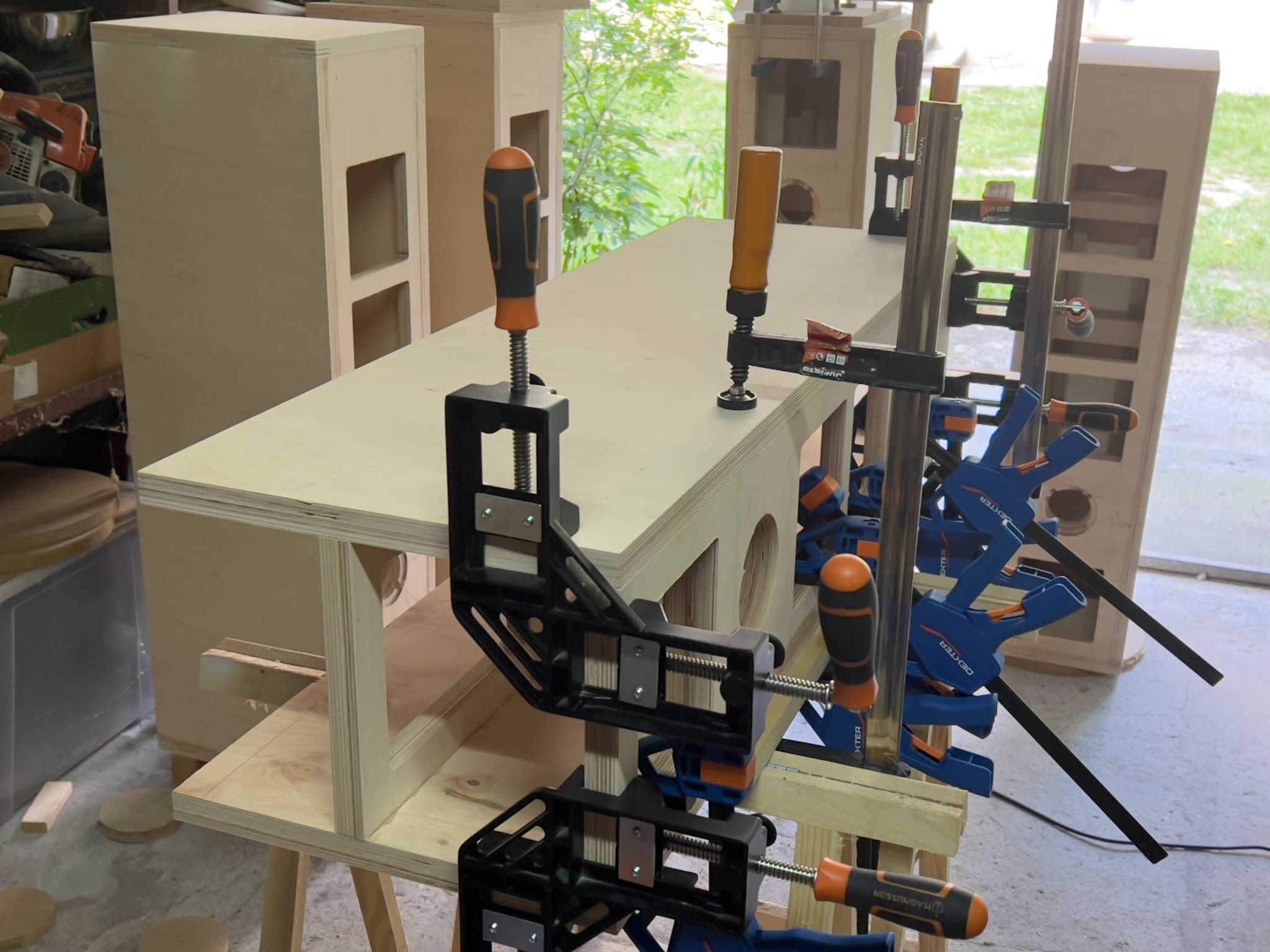

I did not expect this. Four pairs of crates for gluing landed in my tiny garage. I'm trying to control this chaos 🙂. Keep fingers crossed.
