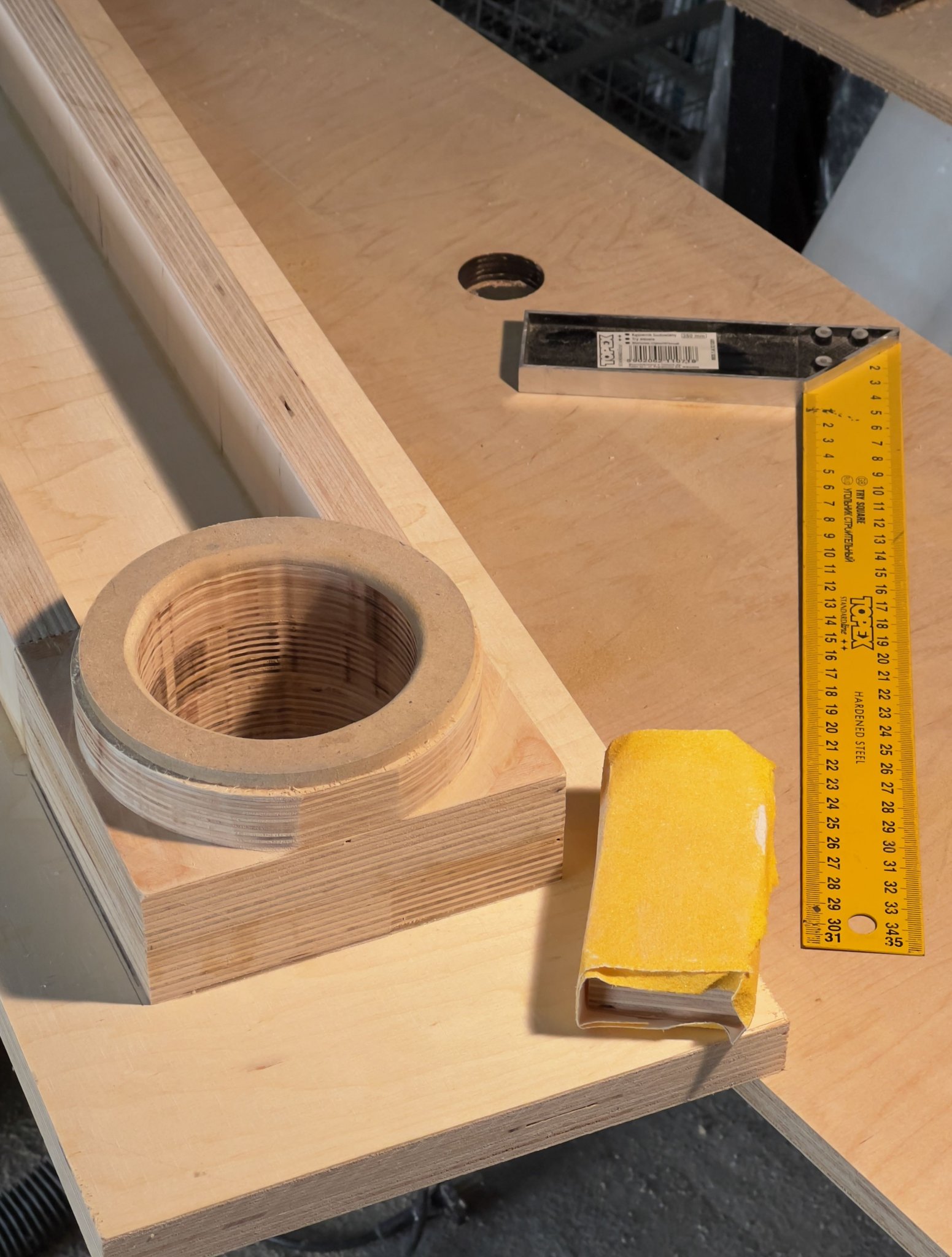

Indeed those are of major concern. In the Elsinores these are well sorted by a number of things, 1) the port is at the rear, 2) extremely large internal volume, 3) the diameter of the port is larger than its length and 4) the highly resistive nature of the internal volume, most of the mids are filtered out by the time it reaches the port.
A number of people have long had misgivings about vented enclosures and they have good reasons. But it just makes the design goals harder to achieve, but they can be achieved.
I have had a number of people converted, that a very well sorted (and rare) vented enclosure can be amazing and have its own advantages over sealed. One is that lowering excursion in a driver that handles the midrange, lowers critical high-order and FM-like distortions in the midrange. The Purifi drivers take this to almost extreme, but with the standard SB Acoustics drivers, this is still well achieved, like 1/4 the excursion required for a target SPL.

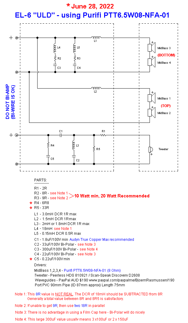

UPDATE:
There are some changes to the Crossover to take note. There was always a possibility that some tweak would be found, but the changes are small. Please note the components marked with a red Asterix. *
* R5: 33R (IMPORTANT). This is a new added component. As the ULD drivers have concave dustcap shaped cones, it has been noted that with a single inductor doing the filtering to the top two ULD drivers, this means that you get a bit more pronounced "BBC Dip" effect than the SB17 type drivers. This is about how we come out of it at frequencies above the dip. Adding R5 33R did a subtle but well worth improvement.
* R4 changed from 8R2 to 6R8
* C5 changed from 0.47uF to 0.22uF
These two values are adjusted to to match the effect of R5 on the electrical side. These are less important than adding the 33R resistor.
If you have already built the crossover, then just add 33R as that is the most important. If you are starting now, use the new values.

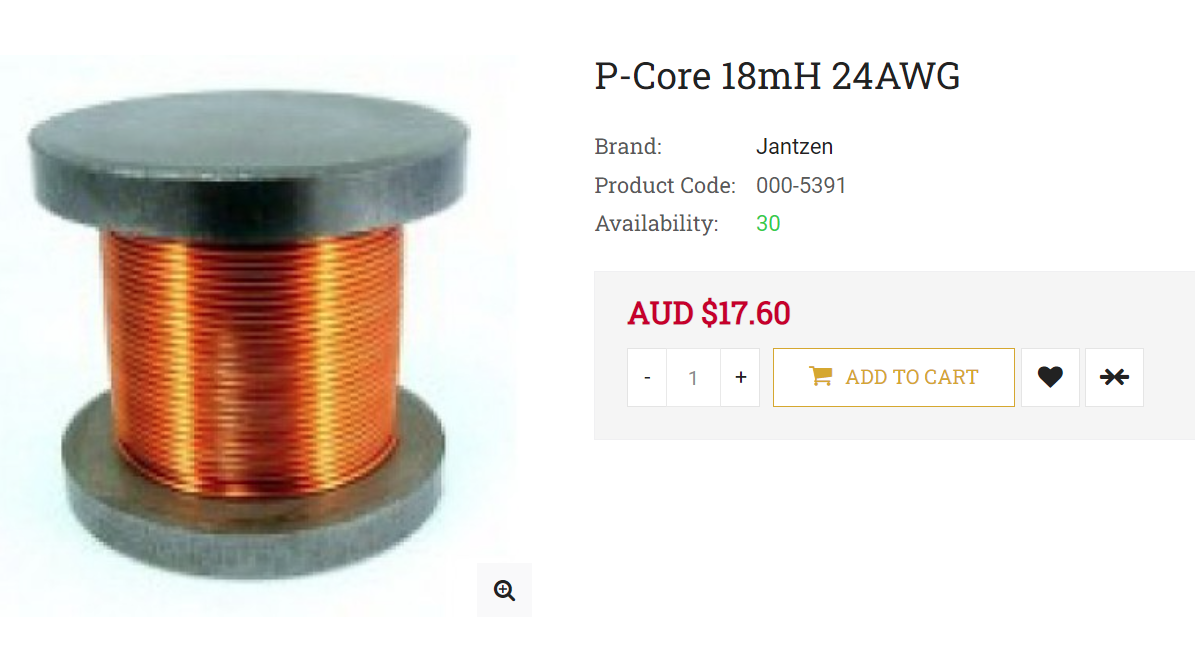

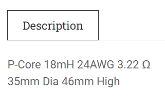

Re 18mH Inductor:
This is clearly a tricky component as the ones usually available have thick gauge wire and low DC resistance. But in this instance it is better to use a higher gauge and this one below uses 24AWG and has 3.2 Ohm resistance, which is near perfect for our requirements and makes the inductor more compact. The resistor that is already in series with it makes it unnecessary to use low resistance inductor. Just reduce the value of the series resistor.
Note how reasonably priced (AUD$) and the dimensions.
https://speakerbug.com.au/index.php?route=product/product&path=18_45&product_id=967
I got in touch with www.speakerbug.com and asked if they could offer 30 from Jantzen, so this batch was made for us. I got 30 and Nigel at SpeakerBug also got 30.
This inductor and dimensions, this is what the PCB was designed for. This is the reason that I sell the PCB and the 18mH inductor together. I did that part to make it easier for you guys.

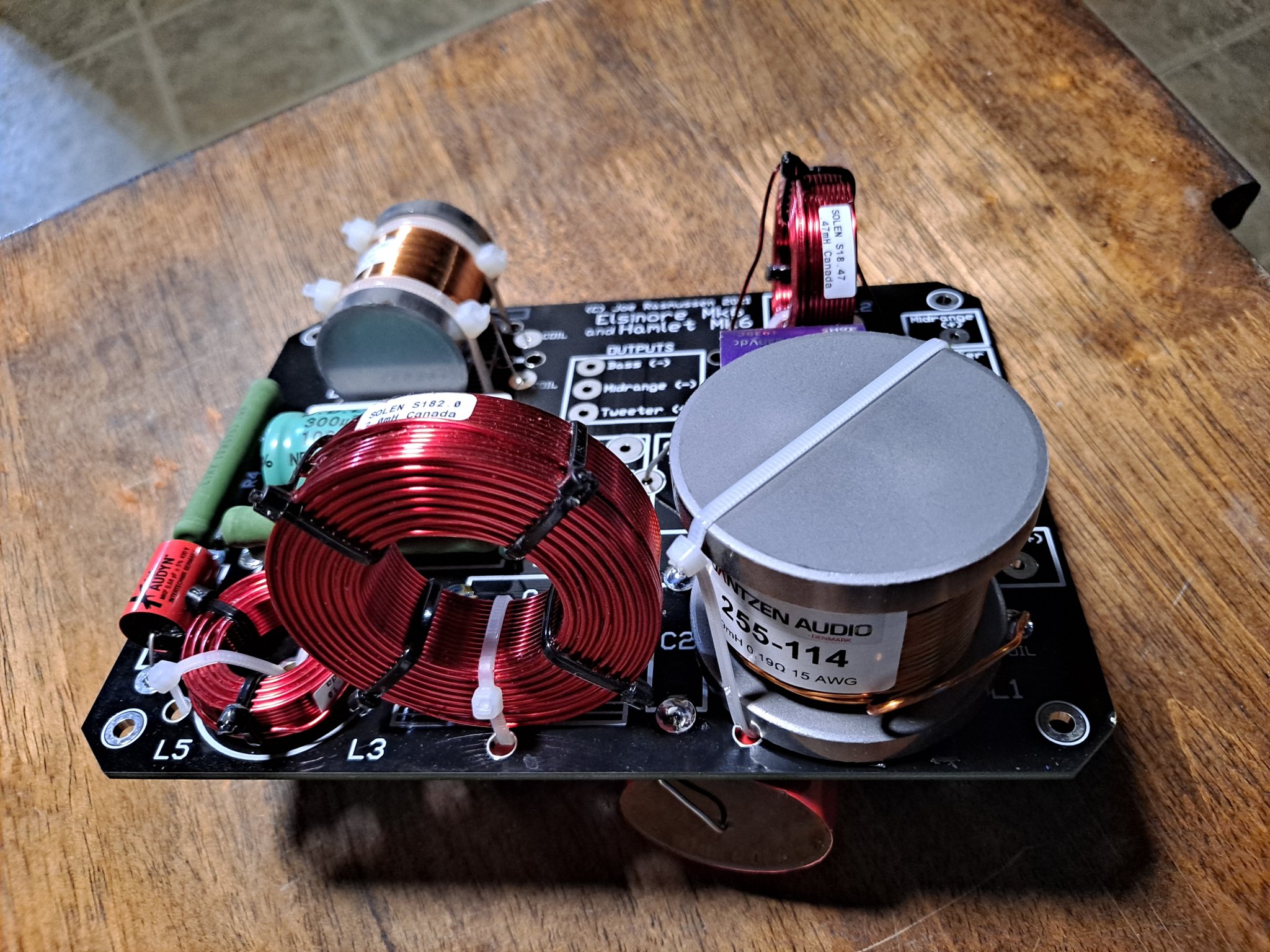

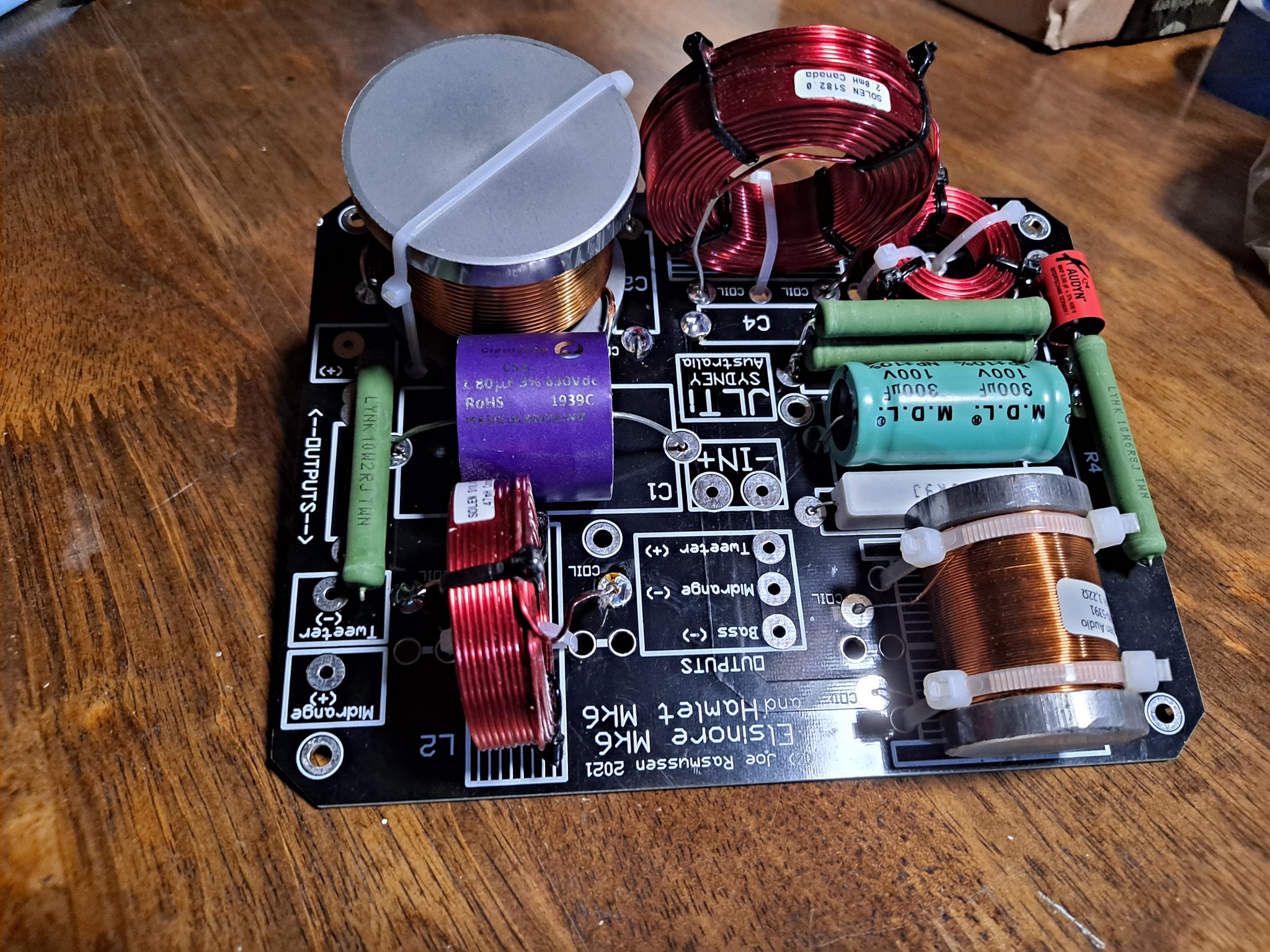

I mentioned in post #4,791 that I would report back with the fitment of the parts from Meniscus. The inductors worked out well. I used two film 33uf caps rather than the bipolar electrolytic (I didn't feel like shopping around for parts and they only had the films.) and they did not fit on the top side of the board along with all of the other components so I just mounted them to the bottom. I also used Metal Oxide resistors which were slightly long but still manageable. If you sourced the Bipolar caps for C2 and C4 as well as went with the sand cast, everything would fit just perfectly without any hassle.
The big thing is that the inductors fit well enough.
