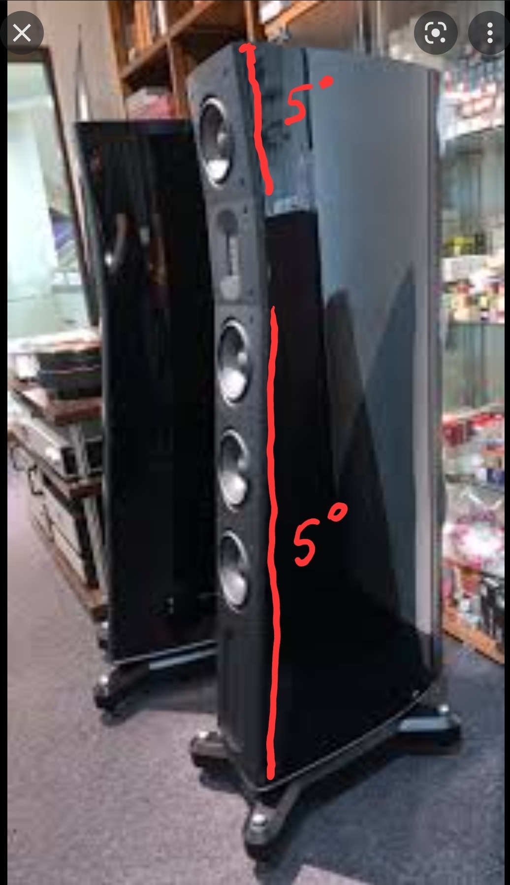

Dear Mr. Rasmussen,
thank you for providing such a DIY project. I have read all 4.800 posts (took me around 15 Hours) o_O
I am preparing to order parts and looking if I can make some changes to encloser.

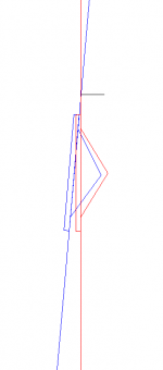

Can you please advise if some tilt on front panel could be possible (that will not affect sound greatly):
1. 5° tilt on uper driver and 5° tilt on 3 drivers down, like on picture (all other encloser spec will remain the same as in project)
or
2. 5° tilt on complete front panel (all other encloser spec will remain the same as in project)
thank you very much.

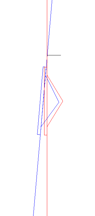

or
If you did this with the current Elsinore design and drivers, then the focus of the top three driver array will fall to a much shorter distance.

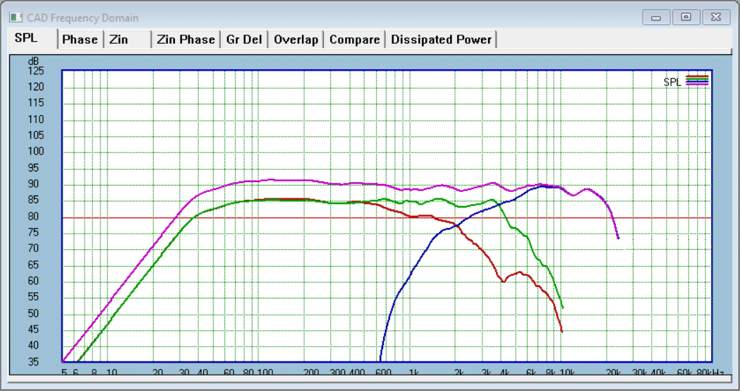

Tilting by 5° starting at the edge of the waveguide changes the distance by approximately 10mm in my rough drawing (based on the MFC woofer).
At the crossover a quarter of a wavelength would be approximately 30mm (@2900Hz)...

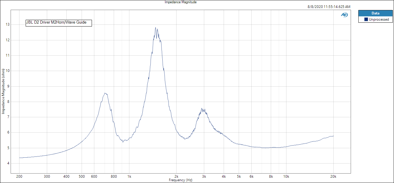

Oh yes, Ohm's Law is very much at the heart of this topic and indeed an unstable impedance can modulate the current that flows through the voice coil when the amplifier is a voltage source. If the impedance changes (not stable), the current changes and you will have distortion. And yes, it is very much measurable.
But the concept of 'current distortion' is yet to catch on, but it will happen. My hope is that it will.
The voltage only creates a potential for current to flow.

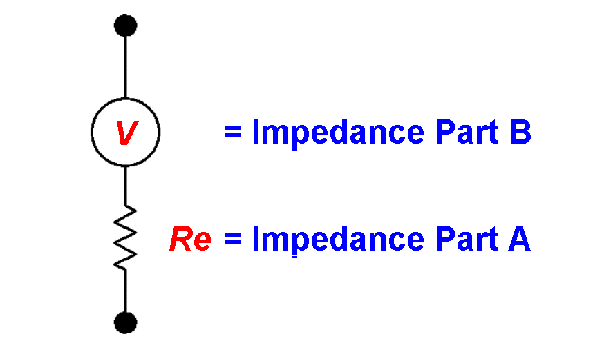

But what exactly does the amplifier see? Here is a very basic concept where the two ends are the terminals of the speaker, what the amplifier sees as a load:

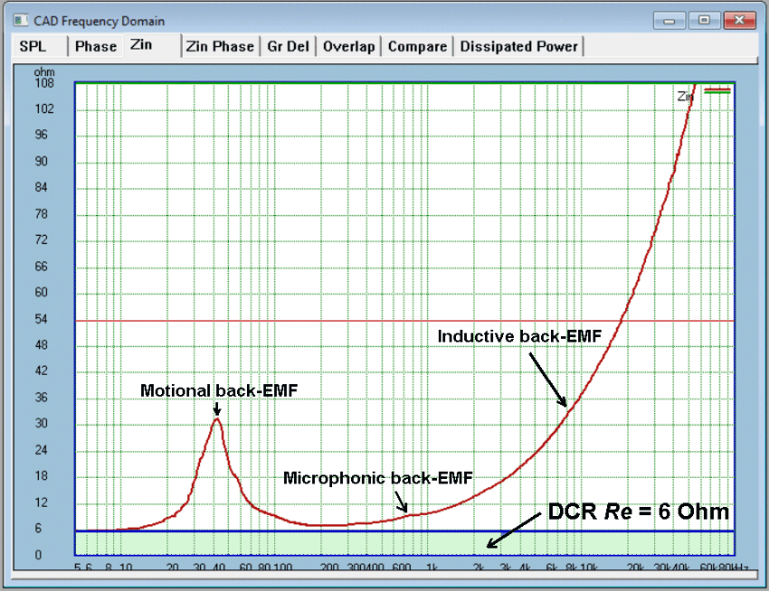

Part A is the DCR (Re) of the driver. It is largely constant with frequency. But Part B of the impedance, the "V' is not constant and varies with frequency.
The voltage only creates a potential for current to flow. BUT, how stable is that current?

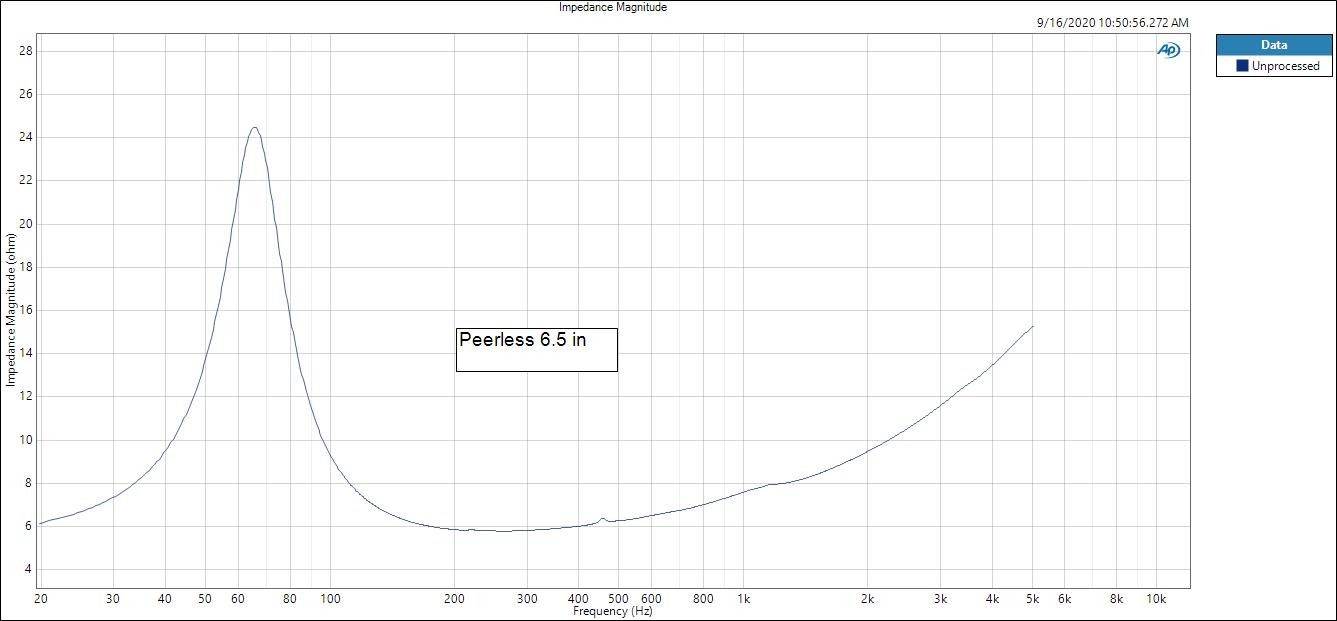

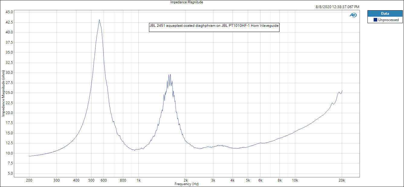

Take a look at the impedance graph shown below, note that any impedance above Re is some form of back-EMF and that only at 0Hz, or DC, there will not be some kind of back-EMF:
Note that the impedance cannot drop below Re at any frequency and that there are three different types of back-EMF involved.
Why are we calling this "V" which sounds like a voltage?
Because any form of back-EMF is a voltage source in its own right.
The "F" in EMF, electromotive-Force, is a voltage.
This force acts against the current of the amplifier and becomes an impedance. One knowledgeable friend of mine, when I pointed this out, called in an anti-voltage that acts as an impedance. And yes, it acts as an impedance that has a value in Ohm.
This simple fact has gotten me in trouble in the past: A voltage can be an impedance and a value in Ohm.
Our impedance is not stable and hence the current of the amplifier is not stable.
So many things can cause this problem. The impedance can and does change with excursions. This is where Purifi has done their homework. But any irregularity will show up, and any aberrant behaviour will end up modulating that impedance plot we see above. Imagine that impedance plot line as being very fuzzy and you will visually have some idea. Motor deficiency, cone resonances, poor suspension performance, surrounds too (Purifi again), all these can bounce back into the system, they get reflected right back into the amplifier on the current side. How can we ignore this? Signs are that some at least are not ignoring it.
The above is clearly simplified, but realistic view.

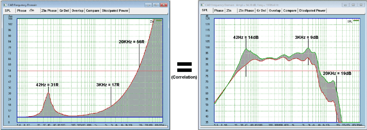

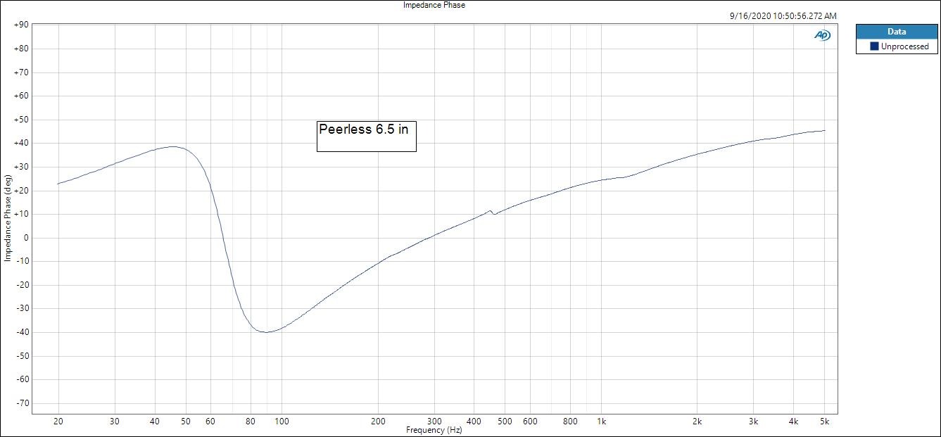

If one digs even deeper, then take a look at this:
Note the grey area are equivalent, the graph on the left correlates to the one on the right.
What we have here is the same driver as the impedance graph earlier, but now we are looking at the frequency response. Actually two responses, one is with a voltage source and the other is a current source.
The above can be analysed deeply, but will try to keep it simple(?) here. The SPL output is directly related to the current and only current explains the difference in both responses.

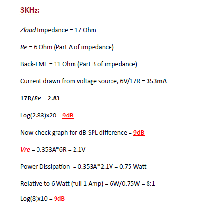

I have three frequencies shown above, but let us just look at 3KHz below:
Using the variable Vre we can see that the difference SPL corresponds to both current 353mA as well as dissipation in the voice coil, since efficiency is well under 1%. The reference voltage is 6 Volts and the reference current is 1 Amp respectively. The 6 Ohm Re is the determining factor for choosing these two.
I know the above takes a bit of an effort to digest and get a feel for it. Remember when the current source is used, we would have 1 Amp current at all frequencies. The voltage "V" is still present, but it will not impede the current. When a voltage source is used, then "V" will act upon the current and at 3KHz it will reduce to 353mA which is -9dB relative to 6V/1A/6W.
It's also important to understand that 6V and 1 Amp were chosen as useful equivalences because the Re, or DC resistance of the voice coil is 6 Ohm. Hence without the presence of "V" the voice coil would dissipate 6 Watt under both voltage source and current source conditions.
I think I will leave it there. I hope you found it interesting. There is of course far more to it and will put in down in written form soon, but I won't be rushed to print, so to speak.
The above is clearly simplified and this is just an open door for more work.

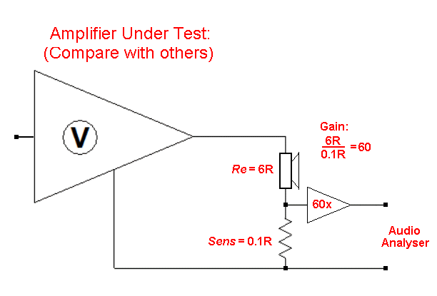

If one digs even deeper, then take a look at this Vre can be used by an audio analyser to measure current distortion. We can now simultaneously measure both voltage distortion of the amplifier and current distortion of the amplifier.
What if it turns out that amplifiers turn out to have significantly different current distortion profiles, that would help explain why amplifiers DO sound different. Would it also be crazy if it also showed that transformer-coupled amplifiers have an advantage in this respect?
Maybe?
Cheers, Joe

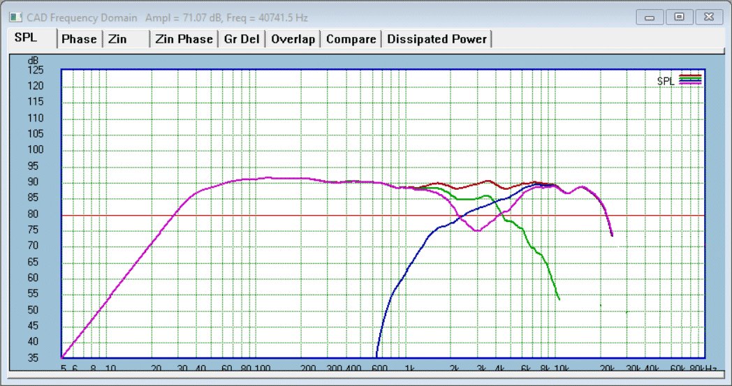

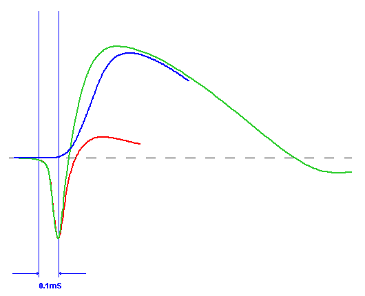

Yep! And that would be problematic when it comes to the Elsinore design, which is very close to that crossover frequency.
Blue is the four driver combo, Red is the tweeter and Green is the sum of Blue and Red.
Here is another view:

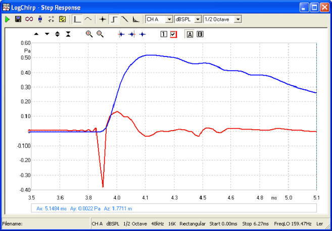

Note that the drivers are not fighting each other in time. This means that the crossover circa 3KHz will perform well, some cleanly at -6dB (optimal) and near perfect driver integration.
One either get it right or wrong.
ULD:
The null is when the tweeter is connected in the wrong phase, the crossover frequency is revealed at 3KHz.

I am not too sure about voltage or current distortion either. In a few days I will be back at my bench to test a few things.
What is the source of pre-ringing in the step response?
The ClioFW01 sometimes does that, it is just a measurement artifact. It can safely be ignored. Notice that the tweeter is reversed electrically, but the output under 10KHz is in phase and is timed to sum upwards. That way the crossover becomes very clean with near 100% vector summing in and around the crossover. This is how you get the stitch right between the midrange and tweeter drivers.

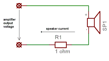

Study the above R1 resistor which must be a small fraction of SP1, this way you are measuring the current of the amplifier. The voltage formed across R1 will be proportional to the current that the amplifier is producing. The key word here is proportional. The voltage of R1 can now be fed through an audio analyser and we can measure that voltage as proportional to the current of the amplifier, and we get current distortion measurement.
My method is a little more elaborate and produces greater accuracy:
A low distortion signal amplifier, 60x above, will mean we can match the voltage that appears across Re of the driver.
We need to measure both sides of the amplifier, both voltage and current.
Since the amplifier is producing both voltage and current, it must also be producing both voltage distortion and current distortion. Do you see the point?

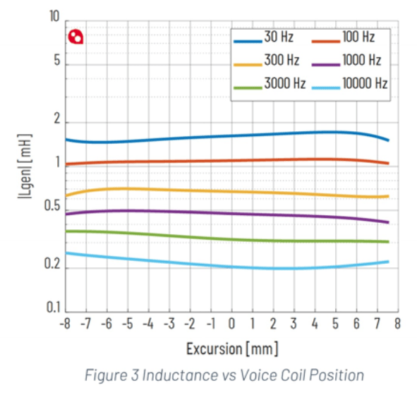

The above flat inductances are in series with the DC resistance (Re) of the driver. The impedance is much more stable than the average driver which has significant non-flat inductance. The flat inductance also indicates more linear force-factor linearity.
So with this driver, the impedance seen by the amplifier will be much less fuzzy and hence we get lower distortion from the amplifier.
This driver will get you so-called current-drive advantage with a more conventional voltage source, so-called voltage-drive.

Hello Joe,
A first responder will speak to mechanism of injury, as in what kind of injury will be caused by running your car into a tree. So if you drive your car into a tree they will take you to the ER and X-Ray looking for broken bones.
If there is distortion coming from your speakers, first what kind of distortion is it (a topic for later), and what caused it?
Is the distortion caused by the amplifier? Is the distortion caused by the speaker? Or is the distortion caused by an interaction of both? Can a good amplifier help a bad speaker or even the other way around?
I will start with one most can agree with. You can install a woofer in a sealed enclosure and use the air inside the enclosure as a part of the suspension of the bass speaker. Yeah sure it is done frequently. The problem is that air does not make a perfect spring. Air only sort of follows the ideal gas laws. If the sealed enclosure is small enough and the Woofer has a long enough excursion the nonlinear air compression may well be the primary cause of distortion for the air suspension woofer. Air compression is the mechanism of injury in this example.
Joe, you posted a figure that shows a “sensing resistor”. If we measure the voltage across the sensing resistor using Ohms Law we can calculate the current. This same configuration with software is how we measure/calculate speaker impedance curves, phase curves and TS/P’s. What is it about measuring delta Volts across the sensing resistor and doing an FFT that tells us that we are measuring current distortion? It could be voltage distortion, it could be impedance distorition, it could be phase distortion, it could be delta “Q” distortion, it could be inductive distortion or construct another name for distortion that we like better.
We do not know what causes the distortion, calling it current distortion may be too quick and easy.
What we need to do is to isolate some the potential causes of distortion (variables) and make some measurements.

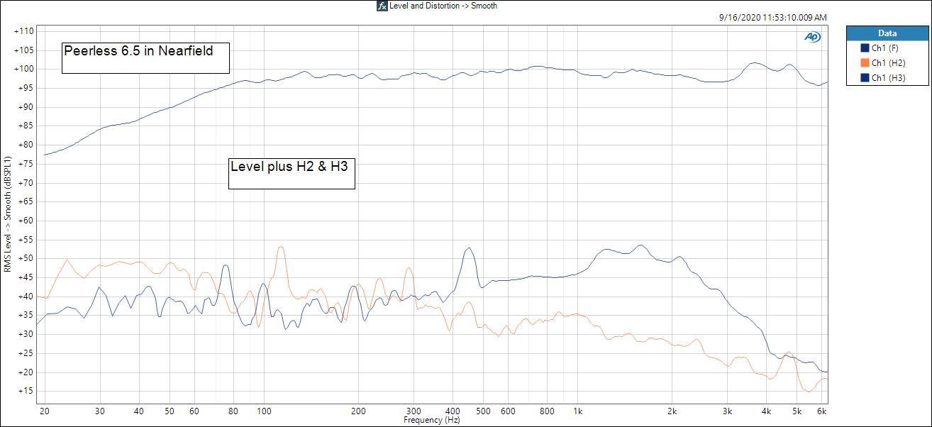

For grins here are some plots of a HDS 830875 6 ½ inch woofer made with a ApX 1701 test amplifier with sensing resistors and AP500 software. The distortion measurements are acoustic, made with an AP 426M16 microphone.
Thanks DT

Joe, you posted a figure that shows a “sensing resistor”. If we measure the voltage across the sensing resistor using Ohms Law we can calculate the current. This same configuration with software is how we measure/calculate speaker impedance curves, phase curves and TS/P’s. What is it about measuring delta Volts across the sensing resistor and doing an FFT that tells us that we are measuring current distortion? It could be voltage distortion, it could be impedance distortion, it could be phase distortion, it could be delta “Q” distortion, it could be inductive distortion or construct another name for distortion that we like better.
You have something right there. Yes, it tells us we are measuring current distortion. But this is not an LF issue. We can tolerate some distortion at LF that we cannot in the mids. Think of mixed signals, LF and midrange. One to, excite the position of the driver/voice coil.
May I suggest you read some of the Blogs on Purifi's website. That would be good.
BTW, the point you make about a sealed box (LF) and air/spring, are all very valid, if that was the topic.
But this is about distortion that shows up in the midrange, not really LF. It is about the voice coil itself and the force factor being related to the current. If voltage, force factor, and current, if they all lined up, then we would all be happy. Alas, any corruption of the force factor and you have distortion.
You cannot separate the link between the force factor and current. Any deviation is bad. Current distortion is bad. It causes a fuzzy load.
It is the current that creates the force factor and that is what we end up listening to. We must analyse current and that means measurement. We must measure it.
So I am hoping one day that will become a common thing to do, and DIY guys could lead the way. The discussion has started...
Convert the current of the amplifier into an accurate proportional voltage. Measure the distortion of that voltage and you have measured the distortion of the current. The keyword here is proportional.
That is what that 0R1 current sense resistor does.

You also have not grasped the idea that the impedance (graph) is fuzzy and why it occurs. This is crucial.
Nice clean impedance lines? As the driver processes music and multiple signals, some creating LF excursions, others higher in frequency, then our impedance is not that clean, it is fuzzy and the inverse of a fuzzy impedance is fuzzy current that corrupts the force factor. Fuzzy equals distortion.

Hello Joe,
Before I get too deep into this stuff I will do some measurements. I need to locate a 6 1/2 inch driver to test that Purifi has not fixed yet. I will be back later.
The discussion about air pressure caused distortion was only an example of a known distortion mechanism not intended to be a new topic.
Seems that so far multiple distortion mechanisms are all being lumped in under one heading "current"
Yes I know of fuzzy impedance. I have measured many driver curves, Low frequency and mid frequency cone speakers tend to have rather un-fuzzy impedance curves. The drivers that have the most fuzzy impedance curves are compression drivers with horns or waveguides. See the attached plots.
Even in the bi-amped M2 speaker JBL uses capacitors with parallel and series resistors to flatten and smooth the impedance curve.
We are introducing too many other factors and not focus on the real issue: Distortion!
THIS IS ABOUT 20dB OF DISTORTION!
Yes, fuzzy impedance is known, but it is understanding how it comes about and that a fuzzy impedance means that the current of the amplifier is also fuzzy.

A TRICK SOME USE:
One way to smooth out and suppress fuzzy impedance is to put parallel resistors across the driver terminals. Now you have reduced fuzzy distortion. I tell you a secret, Wilson loudspeakers do this. Linn loudspeakers have done this in the past and maybe still do. A number of loudspeaker manufacturers worldwide do this, but will not say anything publically. By causing the amplifier to produce less fuzzy distortion due to fuzzy distortion caused by the amplifier reacting to fuzzy impedance.
So there are funny things going on out there. Wilson uses some weird language to obscure what they are doing, they say that their crossover has less jitter and uses funny word games. This is not helpful. Incredibly obscure, but good advertising. But it is a sledgehammer approach and leads to difficult loads, ouch!
CURRENT IS NOT ABOUT HAVING ENOUGH HEADROOM.
The Elsinores reduce fuzzy current-related distortion by equalising the current of the amplifier.
No crude parallel resistors are used, but carefully tailored LCR (2) and Zobel (1) smooth out the impedance.
Yep, and it is so easily audible. Make the amplifier produce the same current at all frequencies, the current phase angle goes flat and there is a massive reduction in audible distortion.
THERE! YOU NOW KNOW A MAJOR 'SECRET' WHY SO MANY PEOPLE FEEL THAT THE ELSIONOES SOUND SO DIFFERENT.
The key is less distortion! It is not magic, it is targeted at lower distortion and then the music starts to sound right.

Can you please present 2 measurements, with the mic untouched between the sweeps, where
Meas 1: speaker as is.
Meas 2: remove 2 LRC and 1 zobel (as per above)
Present normalised distorsion graphs - 1m mic distance, 90 dB.
(there will be FR differences but it can be ignored as the claim is that it is distorsion that makes the difference - there are settings in REW that normalise FR for distorsion graph.)
It would be very interesting to see - thank you!
The Elsinores are about low distortion, they sound that way. Every detail about them is about targeting as to what kind of distortion(s) that matters. On this there may be differences of opinion in some minds, then so be it. I am confident in what I target.
The type of distortion I want to reduce is similar to those heard when current source is used, such as in fullrange drivers and in active loudspeakers on the midrange and treble. Once you have cottoned on to that sound, you recognise and like it.
Except I want it when the amp is a voltage source and not a current source. A fuzzy impedance creating fuzzy current is suppressed in a current source. We need to develop ways to suppress it and get similar benefits with voltage sources.
In time, in the context of explaining the above, I will produce more than amble distortion measurements. These will not be your regular THD that does not show the more important things up, but mixed signals combining LF and mid frequencies. Both acoustic and electrical (electrical here means measuring bot voltage AND current). The correlation will be obvious and easily compared. Excursions excite current related distortions.
I don't have a REW setup. I am sure that it will be useful, but the usual measurements I am sure would be interesting, but not the type that will show force factor relative to current distortions.
Again, as we are dealing with Purifi drivers, may I recommend to you read Purifi's blogs.
