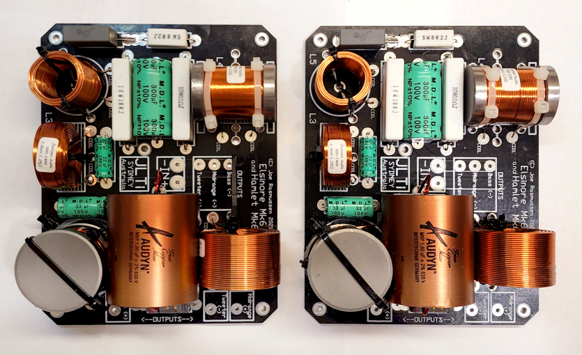

Now take a look at the two largest inductors on either side of the large Audyn True Copper Max capacitors. What these inductors do has a different kind of philosophy behind them. We can think of them as straight 1st order inductors, and that is just fine. But these are uncorrected in any way, so as to add the largest series inductance to the driver's internal but unstable inductance. Also that cap, using lowest possible value is a plus, the inductors, here the largest value is a plus.

I think something significant has been overlooked! And it has to do with those two inductors above.
In the Elsinore Mk6 "MFC", they are 4mH and 1mH respectively. What they do is different from what everybody else is doing and just looking at the crossover is not enough. It needs to be explained.

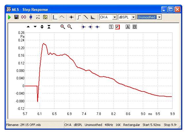

The step response looks like this and comes out like that over a wider window than any other 1st order design like Duntech/Dunlavy.
Take any more fancier methods of measurements (which I still welcome), the above measurement tells me so much, but again a trained eye will know why. I know that this speaker will be friendly current wise (number one requirement) without being greatly deficient anywhere else on the acoustic side. Earlier on I mention Andrew Lipinsky, the designer of the L707 model - it too has that step response you see above. It will also have a wider window than any Dunlavy design (they worked together for a while) and Andrew came to this conclusion independent of mine.

Please take a close look at this, where Red is the bottom two drivers:
How can a single inductor cause such a low-pass function Red? The truth is that it cannot!
Again, some of the tricks used in the Elsinores are not obvious until they are pointed out. The initial roll-off looks normal and near 1st order as you would expect. These two bottom drivers need to perform very well in the midrange. But then the response goes to acoustic 3rd order until you see that dip near 4KHz. This goes back to the original Mk1 design that came out in 2006. The answer? It's a cancellation between the bottom two drivers and what you see above is at 2 metres and on the axis of the tweeter. The distance between the two drivers is what causes that null. The frequency is related to the sum of those differences.
But it is still electrically 1st order. I am actually quite proud of having achieved this trick. I nailed it. :smash: 🙂

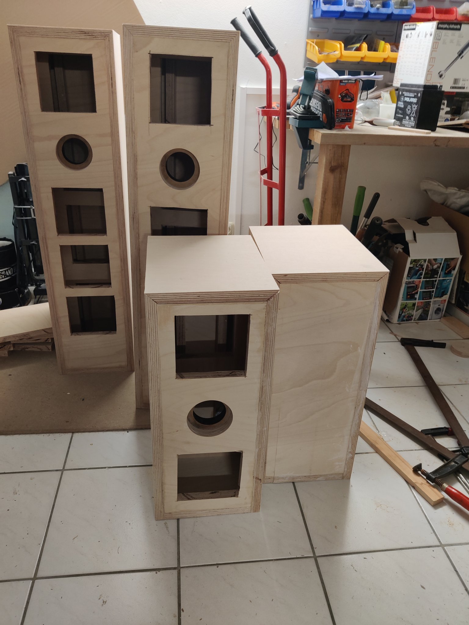

Hello Joe,
good news, very good news. I am building a pair each Hamlet and Elsinores ULD in parallel, so it is time consuming. May be about a month? The Hamlets are closer to there finalisation. Front panels will be Panzersperrholz, These panels for the Elsinores have still to be milled. I will report.

I’ve already mounted and have been using the Purifis in my mark V so I should be able to quickly make the changes to the xover.
Couple questions
—> I know you addressed this before and indicated that it shouldn’t make a large difference, but just to ask again now that you’ve finalized the design —> any reason surface vs flush mounting should make a significant difference in performance? I currently have the drivers surface mounted as per the Mark V
—> I’m obviously awaiting your final suggestion for port length but I did extend to 16cm when I modified my Mark V. However I added the additional port length externally for ease of conversion and for the ability to modify easily once your design was finalized. At the time I did this my internet searches indicated that internal vs external port doesn’t change anything in a vented box - rather only the length. Is this correct on your end or should I re-modify to internalize the port? Obviously internal is better cosmetically but in my application it’s not visible..
Thank you!!
Couple questions
Good news, the Mk-V boxes should work OK with Purifi drivers.
With the Mk-6 using SB drivers, they had to be rebated 7mm. But with Peerless drivers, they had the option of rebating or not. In my own case, I used no rebating.
I wonder if the same could be said for the Purifi drivers? Claus Tinggaard was with Peerless and a significant part of Purifi, so maybe we are seeing his influence and that it is OK to do, or maybe they have not given much thought to it?
I did a search on Google Images and looked for pictures of Purifi Speakers. They were all rebated, but there was one exception I saw that it wasn't. See below.
Will you be able to rebate your Mk-V boxes? The 4mm difference is OK, whichever you use. Without rebating, the top MTM array of three drivers focuses just bit closer, but in practice makes little difference. A lot of this has to do that we get 6dB summing at the crossover frequency and not 3dB.
Re port length, I suspect you had 80mm long ports if using 90mm diameter PVC pipe (inner diameter around 87mm). I ended up with 75mm, but 80mm will be just fine.
Look at the example above, the lower right hand side of the driver, it looks like this was not rebated.

Thanks very much Joe for the response and for all your hard work!
Currently I do not have the ability to rebate them so will try surface mounted but certainly could revisit that down the line.
