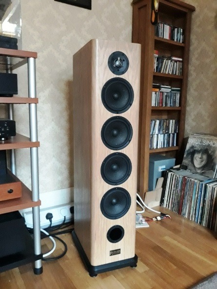

It's very easy to get wrapped up in one's own priorities, while forgetting that it will not be universally admitted that everybody else is obliged to share them. The attached is a 4x midbass + tweeter design I did a few years back for example -very different conceptually to the Elsinores other than the number of drivers, because I had different objectives. Do I think the Elsinores should be like it, or share the same design priorities though? No. I think they should be as Joe wants them to be. I may be mistaken, but I don't recall him asking for advice or opinions on how to change them.

Indeed. And again, one needs to be careful when assuming that others are ignorant of differing approaches, rather than considering the fact that it may just not be a priority or even an interest for them, or that their crossover is already designed 'accurately' according to their design priorities. In this case, Joe has already explained he is satisfied with his general approach and filter, notwithstanding some probable adjustments based on listening & test data from his prototypes. QED.
Re my old speaker design, as noted, I mentioned it for the sole purpose of illustrating the point that different people can come up with very different designs on a vaguely similar theme without implying (or even thinking) that their criteria or methodologies are superior or that others 'should' (!) adopt them. There is nothing for anybody else to say on the matter, since they were not a shared project, and achieved the measured and subjective criteria I had for them. I'm glad you think they look nice though -my then cabinet-building partner-in-crime, for whom they were designed, did some beautiful work.

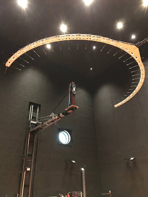

in a matter of big company measurement method, i find what Dynaudio does in their room looks amazing
http://peteswrite.blogspot.com/2018/05/dynaudio-factory-visit.html?m=1
once I visited anechoic room in my previous university which has 120m2 floor area and maybe more than 15m height. but their purpose is more for testing material acoustic properties instead of audio source testing
all of my friends that i invited to join that visit have their own local brand loudspeaker, i give them an access to anechoic chamber so hopefully oneday they can have a proper measurement.

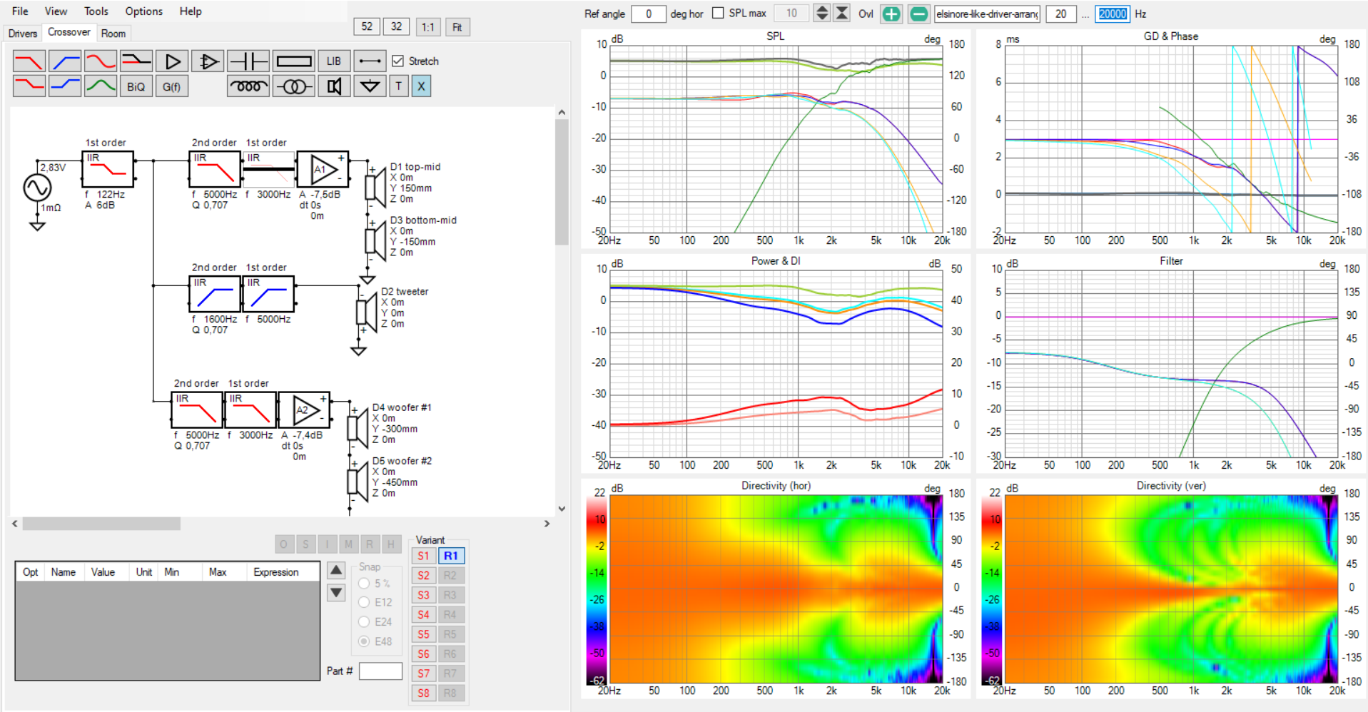

It is not too hard to whip up the driver arrangement into simulator, ideal flat pistons with filters emulating acoustic response roughly and then some quess work about the xo. Looking only the directivity the main features seem to be narrow vertical directivity on the midrange and some narrowing on the horizontal directivity as well before tweeter kicks in. All of it makes dip in power response if axial response is flat. Directivity wise it is a short line array up until point source tweeter comes in widening the response. No waveguide in the sim and dimensions are approximations but the rough trend is about this.
