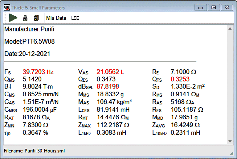

I have burned in the driver for 10 hours measured the Thiele-Small Parameters and they have hardly budged at all. It behaves as it has already been run in.
I am going to give it another 10 hours, that will be 20 hours in total, and test again. I am going to do that will all eight drivers before they are used. I will do similar to the two tweeters HDS/D2608, but of course, the setup is a bit different, here a series capacitor is used. When I fit the drivers to the new boxes and do the calibrated measurements, the drivers will not be in 'cold' condition.

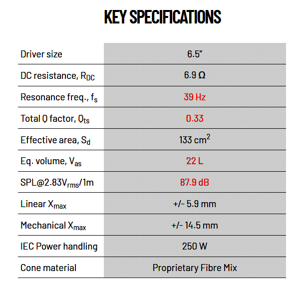

OK, the 30 hours of burning in the Purifi driver has yielded an interesting result. Usually, my system measures the Fs just slightly high, and compared to Purifi's spec, this is very close to theirs.
This is Purifi's Key Specs and the important ones we are looking at here in Red:
Next is my T-S Parameters test using ClioFW01 and the same Key Specs highlighted in Red:
Very close indeed. About the best correlation, I have seen, by a fair margin.
The parameters hardly changed at all over 30 hours of burning in. This seems to indicate the suspension is remarkably stable. The key to that is not the surround, but rather the spider part of the suspension. It has a look that I have not seen before, an intricate weave and if you shine a light behind it, it is partly transparent as I can see one of the cone breathing holes behind it. So to me, this strikes me as a very high-tech suspension and not just the 'funky' surround, as Lars Risbo calls it. I will now burn in all the other drivers for 20 hours each and then test them and compare them to the above. If I find any anomalies, I will report them.

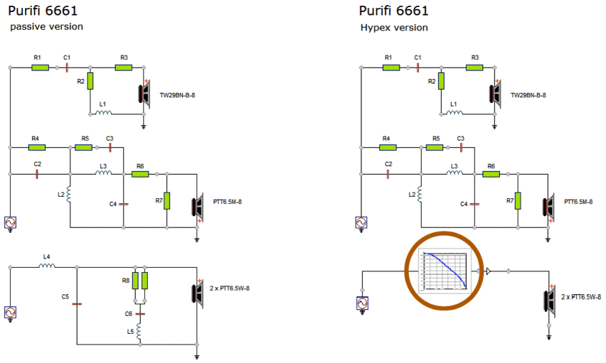

Troels biamps his speaker, with the bottom section running on a 250W hypex plate amp. He also offers a passive option, but even then it is still meant to be biamped, although it probably doesn’t have to be provided the amp can handle the varying impedances and has enough power. The stated minimum requirement is 50W which is much higher than the current Elsinores. Sadly the crossover frequencies are not included in his write-up.
Anyway, maybe this biamped approach is required to get away with the lower box tuning?
The amplifiers he uses are voltage sources, so the alignment should hardly move at all. The DC series resistance of the coil in the passive version might change it slightly, more than a Hypex amplifier would. But it is already well damped. Re crossover frequencies and values, you will need to buy the kit to find out. At least with the Elsinores and Hamlets, I put everything out there. Even the Waveguides can be made because I put out the drawings, but they are tricky to do.
Correct. It's good that he's generous with the amplifier settings because the Hypex Fusion amp appears to be capable of changing the speaker damping via its DSP.
I tried to find out about that. But the Hypex FA-251 is simply a voltage source, then how can you change damping by changing voltage because what else can the Hypex do (other than invoking some kind of voodoo, which we can all agree is not the case). I tried to find out as much as I could about the Hypex. It comes down to what the software controls and we can see that they have put that here:

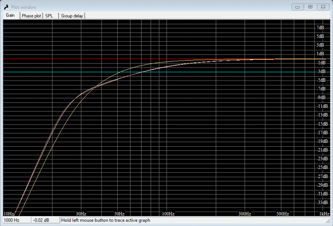

Also, I don't think Troels is doing that anyway as shown by below:
That indicates that the Hypex amp is set to being a low-pass that matches the passive low-pass. It has to do that as it needs to match the same high-pass of the midrange "M" driver. It is the same for both versions. So the filter responses must be the same.

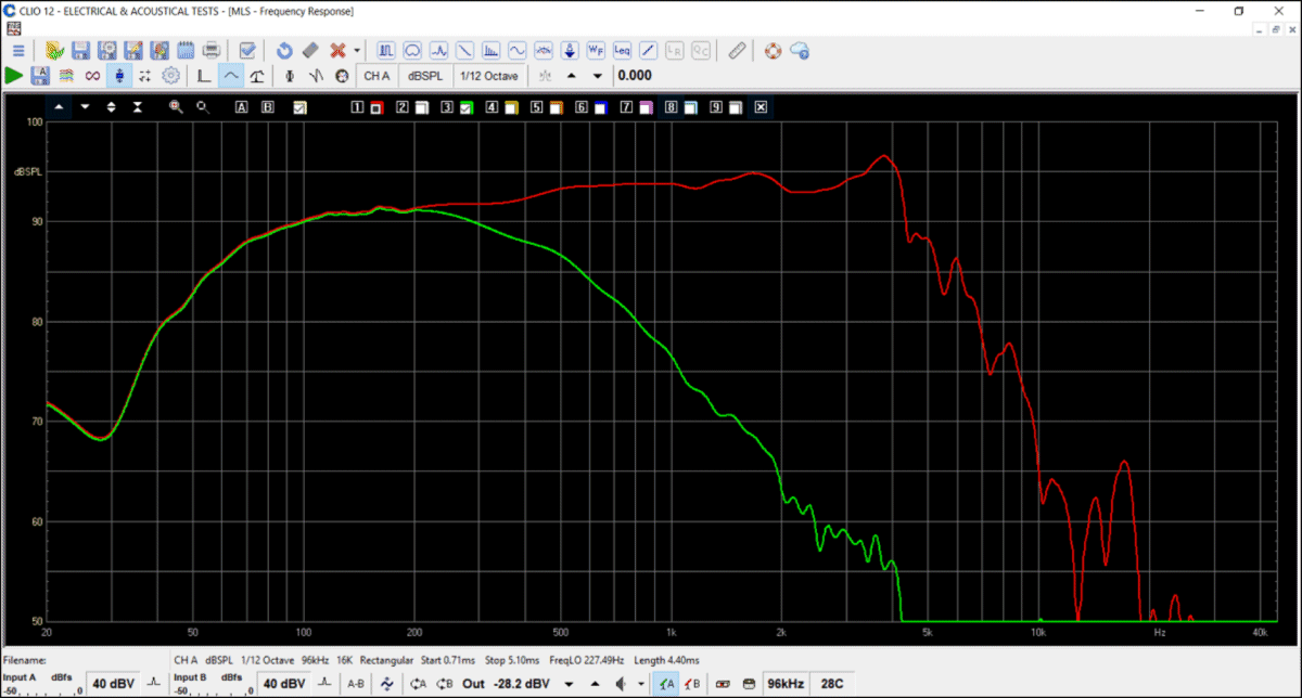

Another thing that points to this:
Curious, in this nearfield measurement of the bass, he does not state if this particular measurement was done with the passive or Hypex low-pass. But the message here is that they should measure the same, or so close as to not matter.
But the thing that is getting my interest is that dip in the high 20Hz range. Because this is the driver itself and the port tuning and no sign that it is being interfered with. We know that the port is filling in that frequency.

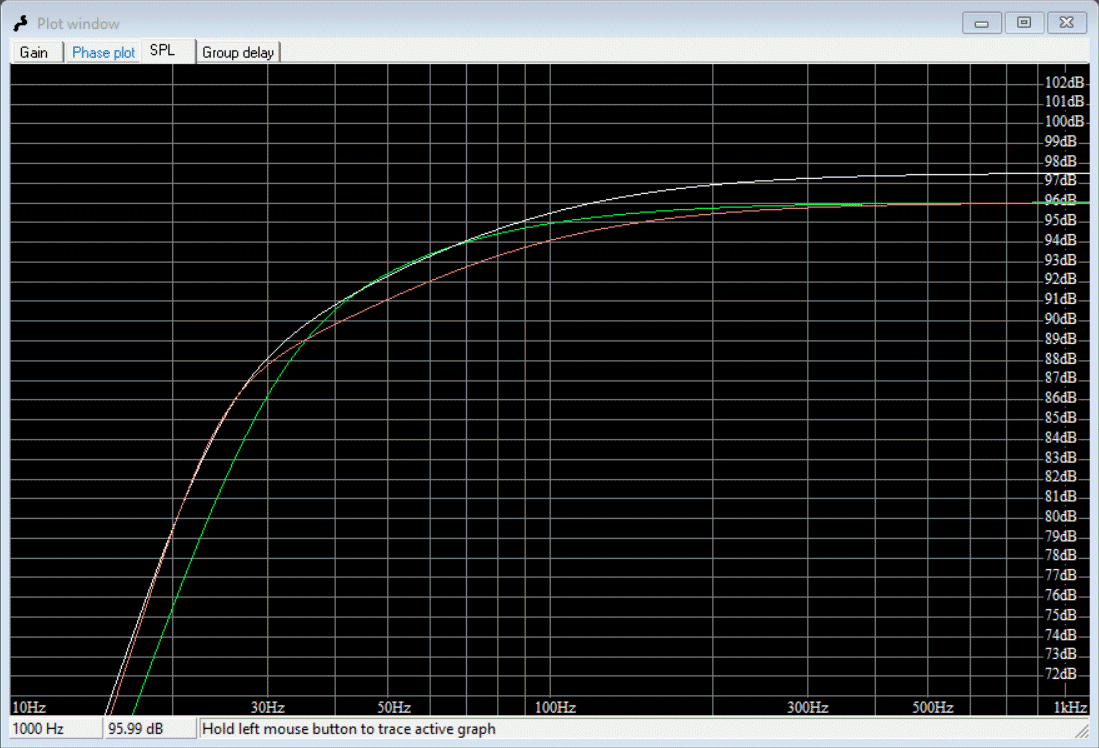

When I first saw this I said hello and this is tuning way below the Fs of the driver. This is OK provided that the Qts is not has low as we have in the "W" driver. And then his comments about the quality of the bass, which is not easy just to ignore. BTW, I have been to Troels place and seen his setup in the basement of his house, so I recognise his room etc.
I digress, the fact is that this is an indication that Troels has tuned this very low. Looking at his port, being about 70mm in diameter and somewhere above 200mm long, with a 37L box, this confirms to me what I see above as the tuning frequency.
The problem with the "W" driver used here is that this decreases the output above the 30-40Hz and up to a bit above 100Hz. So studying the above measurement something occurred to be: See how the roll-off starts around 200Hz? Pull down the relative response of the midrange "W" driver (using R6 and R7) by 1-2dB, and that issue of an overdamped system, can be filled in. Of course, the system sensitivity will take a bit of a hit, but that is sometimes the kind of solution you need to use. He still gets a healthy 90dB.
Above: We can see the extension we get tuning the "W" driver to a lower Fb and that the penalty of lower output above 35Hz to 150Hz and how this can be dealt with by lowering system sensitivity, bring up that response and also get lower LF extension. A classic trade-off.
In the Elsinores, to do something similar, the port length needs to be increased from 100mm to 150mm. I use a much larger diameter port than Troels does. I did some calculations and found that with 50 Watt input, the peak Mach with 100mm long port is around 0.18 (this is very loud). Increasing the length of the port and with the new tuning, this had increased moderately to Mach 0.20 - and this would still be a much better result compared to Troel's example.

PS: This demonstrates what I have in mind. Flatten out that red line and you have now compensated for those frequencies whilst getting more LF extention. This may well be something equal that Troels is doing, consciously or not. The hit is sensitivity:
