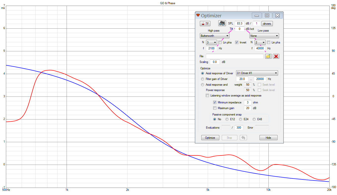

Yes, I get across the LR2 comparison from time to time and it is seeing the tweeter's reverse electrical phase is that catches the eye. But it is not LR2 and the step response looks like this and is the key:
Lipinski L707
Now let us look at the tweeter in red:
Lipinski L707
I am not the only one who has worked out, the above is from a speaker designed by Andrew Lipinski who worked with the late John Dunleavy who was wedded (welded?) to 1st order Butterworth. But Andrew and John just did not agree that was the best way.
Neither did I (I have a relationship with John's earlier company Duntech - an interesting story there). We, Andrew and I, independently ended up with a different way of doing 1st order as electrical crossovers and the step response looks like above, which is John Atkinson's measurement of the Lipinski L707. (But I have used a few tricks that AL hasn't, particularly reducing tweeter distortion - an obsession with me.)

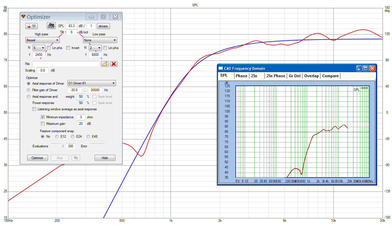

Below is the Elsinores, compare with above:
Now we are starting to understand why the tweeter's phase needs reversing:
The perfect tweeter will have an infinite rise time, hence all its output is reversed. The ideal tweeter inverts its phase. Of course there is no such thing, but it supplies the clue that we can get the reversing out of the way (going negative) as quick as possible and line it up in time with the mid/bass driver, so that in time they both go positive together. Yes, it mans you have introduced a pole, but it is well above 10KHz most of the time and in one case got it up over 20KHz with 1 Watt input. Obviously, the pole swings in frequency as power changes, but in practice does not prove to be a problem.
Also, the off-axis response improves greatly, because now you get 100% vector summing there when you only get 50% with Butterworth. Off axis better, power response better.

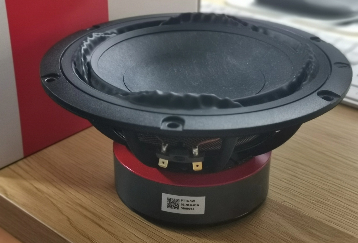

Just got an email that FedX has landed my Purifi drivers.
Great news.
And a new speaker is going to me as a replacement for the damaged one. And I hope this time will be fine.

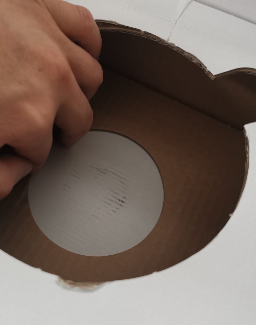

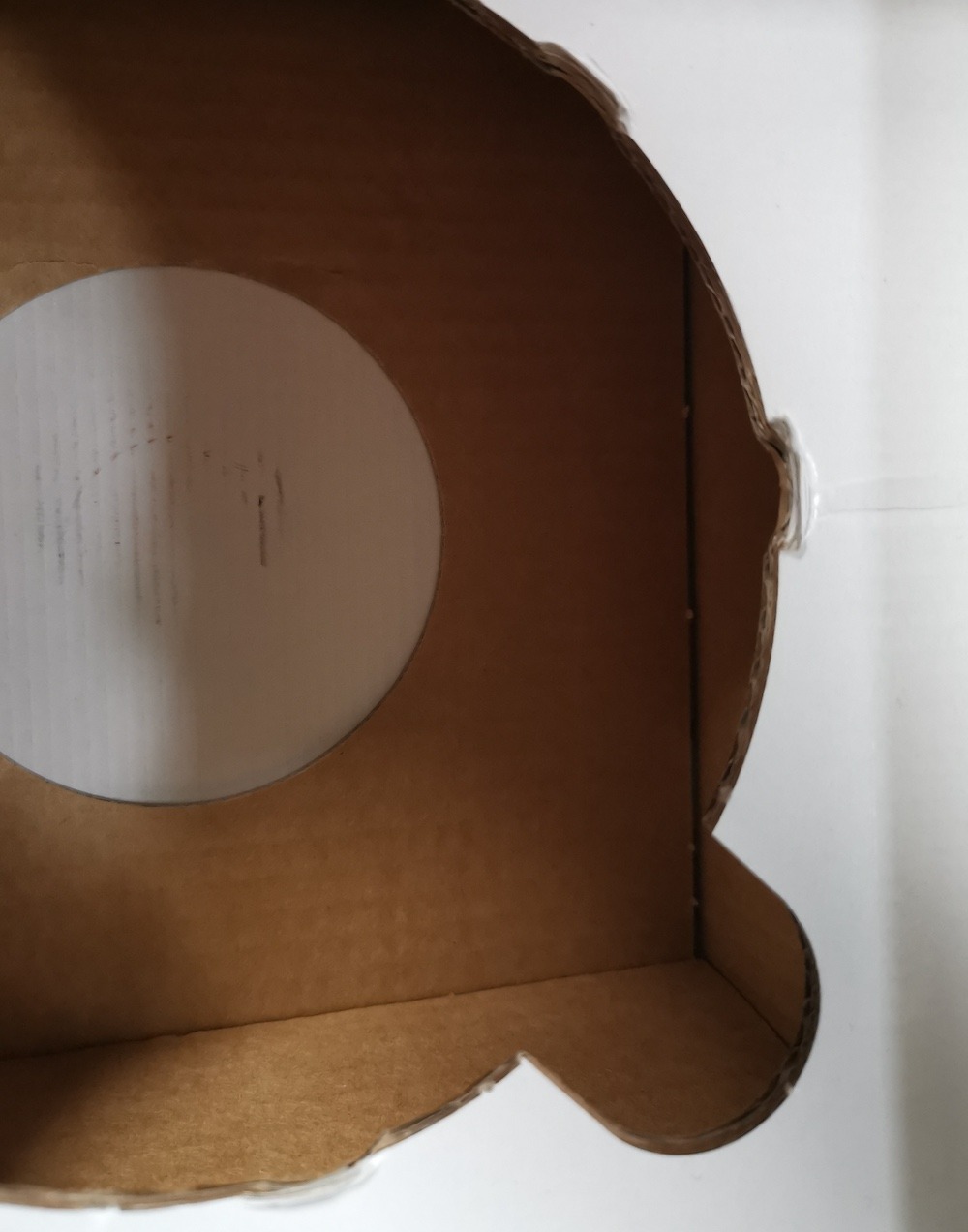

I think the speaker packaging is very badly made up. It holds the frame of the loudspeaker and the magnet has no support. In my opinion, this is a big mistake. So, as I wrote earlier, be careful when collecting the parcel.
Pics or it didn't happen.Just got an email that FedX has landed my Purifi drivers.

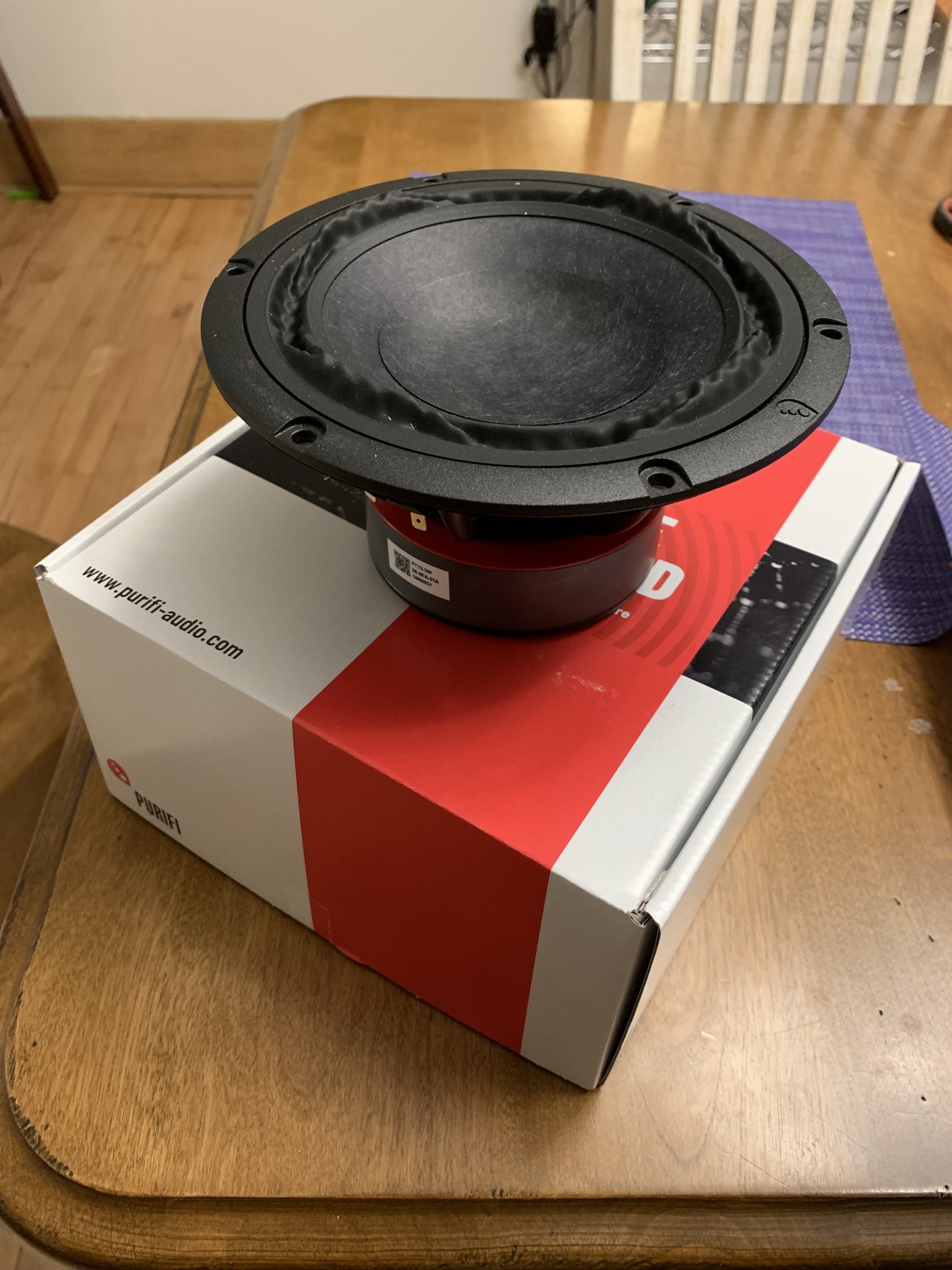

Is! New! My precious!
And this is what the shipping box looks like. No support for heavy magnet. See how hard the speaker basket works. Bent edges. I don't like this technique of packing items.

Regarding the phase response of the Elsinore, it is an actual measured acoustical phase? If so, it doesn’t show the expected 180 degree phase rotation across the all-pass band. Is this because of the expected 180 degree rotation of an LR2 with inverted driver is only an electrical phase response, while the speaker’s resulting relatively flat acoustical phase response stems from your ‘renegade tweeter’ view?
Also, is the frequency of the negative going spike in the step-response a function of the crossover frequency, or is it only due to the tweeter’s bandwidth?

The other 6 of mine came yesterday too! No damage I could detect on any of them on my end..Yesterday 2 parcels filled with 8 Purifis landed in Germany, now we may start.
I have to check them for damages, we will see.

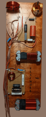

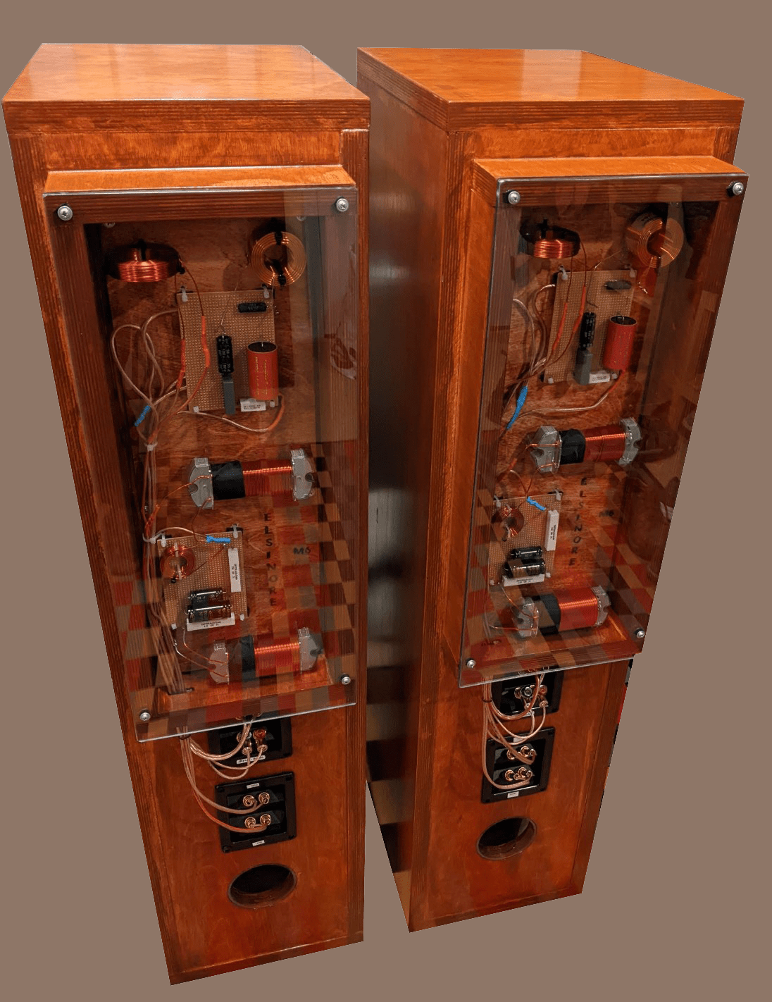

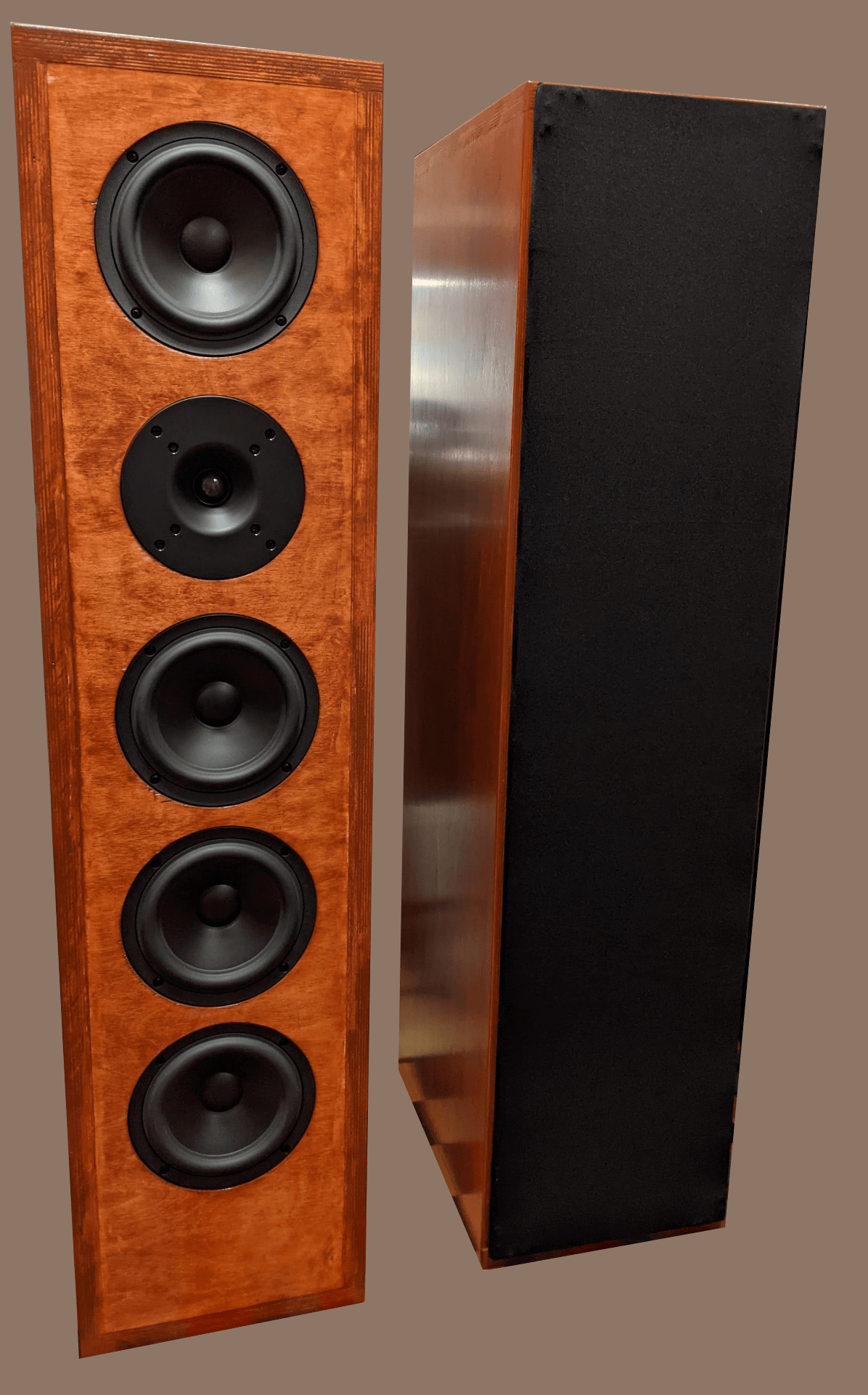

Reporting another successful build of the Elsinore Mark 6 speakers. I used 18/25mm Baltic (Russian) Birch plywood that you can find at many plywood distributors in the US. I am attaching a couple of pictures showing finished boxes and the crossover layout. The speakers perform above all expectations, and absolutely deserve the praise they get on this forum and beyond. Thank you, Joe and everyone else who share their knowledge and experience with the DIYers everywhere!
- The "Elsinore Project" Thread
