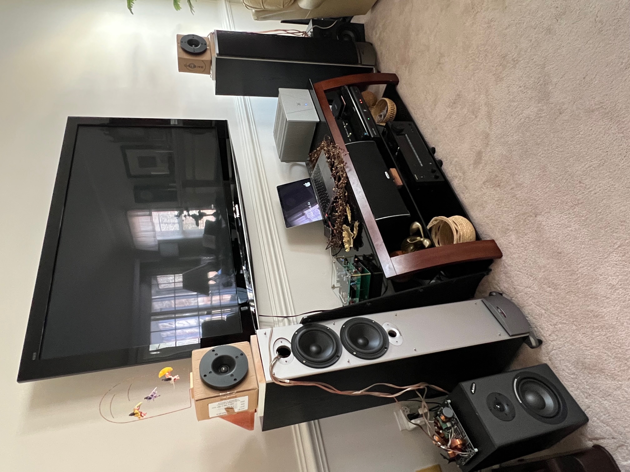

A while back I pulled the inferior drivers out of my Polk speakers and temporarily installed 2 of the SB17MFC35-8 drivers into each enclosure. That made a giant improvement in the quality of the sound from those Polk enclosures.
Then yesterday as I was moving the ScanSpeak tweeters to a different storage location I heard them cry out for action. So I pulled them out of the shipping cartons, mounted them to a couple of the SB17MFC packing boxes, attached a bit of pine board to the boxes for stability, and hooked them up to the crossovers.
The outcome is ugly and sub-optimal but boy do these systems sound great. I never thought that good drivers and a couple of good tweeters could make that much difference in the sound that I am now hearing.
Hearing the range of sound that is being delivered by the combo of drivers and crossovers has kicked me in the butt enough to cause me to stop dragging my feet and start building the Elsinore boxes!!
My setup uses an Apple MacBook Air feeding Apple Music lossless digital to a Khadas Tone 1 DAC mounted under the ACP+ The ACP+ preamp feeds my P-channel Vfet power amp.
More to come
-- Happy Jack
