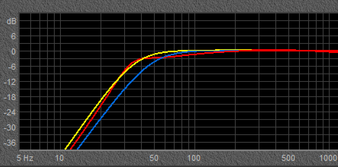

A shy question. Will Purifi speakers require smaller boxes than SB Acoustics?
Not necessarily. This is where I need to have the driver before me and compare the T-S Parameters and compare to my known drivers here. Note that the comparison can only be done on the same setup so that they can be compared and then the difference numbers can be crunched. It isn't just the difference in VAS that is important - and that low VAS may not show up with my setup as that low. But what is certain, to make the new drivers work in our box, it looks like a higher tuning frequency is required. I tune it to give the closest thing to what looks like a Bessel fall-off in frequency.
There is also another thing, the Elsinore box working as a reflex is much more resistive than normal vented boxes. One of the two major reasons I knew I could not use the first "X" drivers Purifi brought out was the very low Q they had and the "W" does not. Also that the new "W" drivers now match the sensitivity of the drivers we have used so far.
But this comes down to finding the best tuning for the box we have got. The port will definitely need to be a bit shorter, we shall see by how much.
Yellow should be approximately what the Elsinore/SB is now. Blue suggests an optimum regular damped vented box for the Purify at just under half the box volume. Red suggests what you might see with the Purify in a regular larger box.A shy question. Will Purifi speakers require smaller boxes than SB Acoustics? The electrical-mechanical parameters are so different.

So some correction may be necessary. Even for ready-made boxes, it is easier to reduce the capacity than to enlarge.

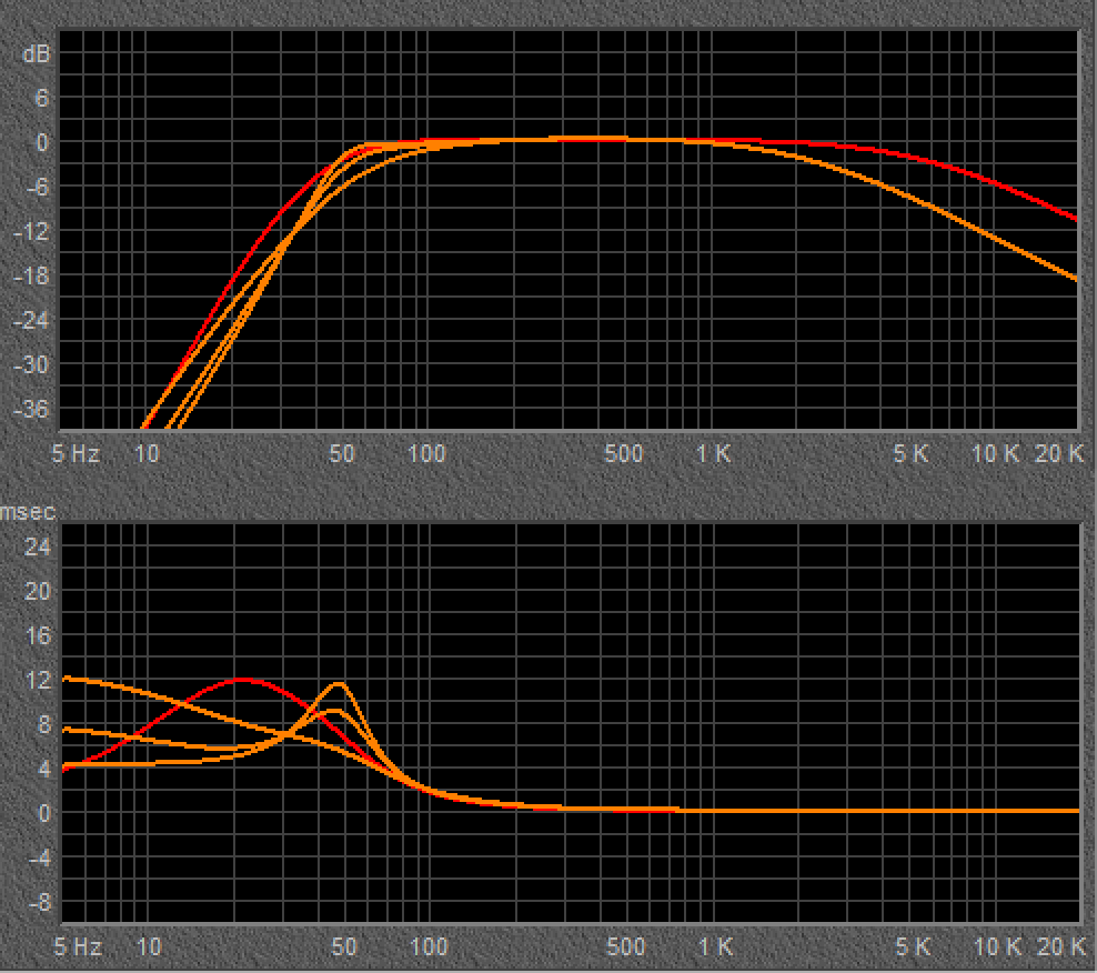

If you believe I could make that determination after 5 minutes on a simulator, then you give me far too much credit
It is clear you will explore damping, and then some of the many other options.
Others might be interested to know that group delay can be used in this process. This shows how fast the response turns. It is related to phase. For example...
The orange responses with different degrees of damping. Less damping can show a greater bass response, it comes with a quicker downturn, and this is shown as a group delay peak indicating the higher rate of phase change.

Allen, I am not exactly sure what you are fishing about for. But I do keep an eye on GD via SoundEasy (software from Bodzio in Melbourne and chances are you know it) and I generally know what to look for. Being a textbook jockey does not interest me, the real world does. But if I have you right, the gradual Bessel-like fall-off is what we want to see. This what you were getting at? It is also the way you get a flatter and even response in the room.

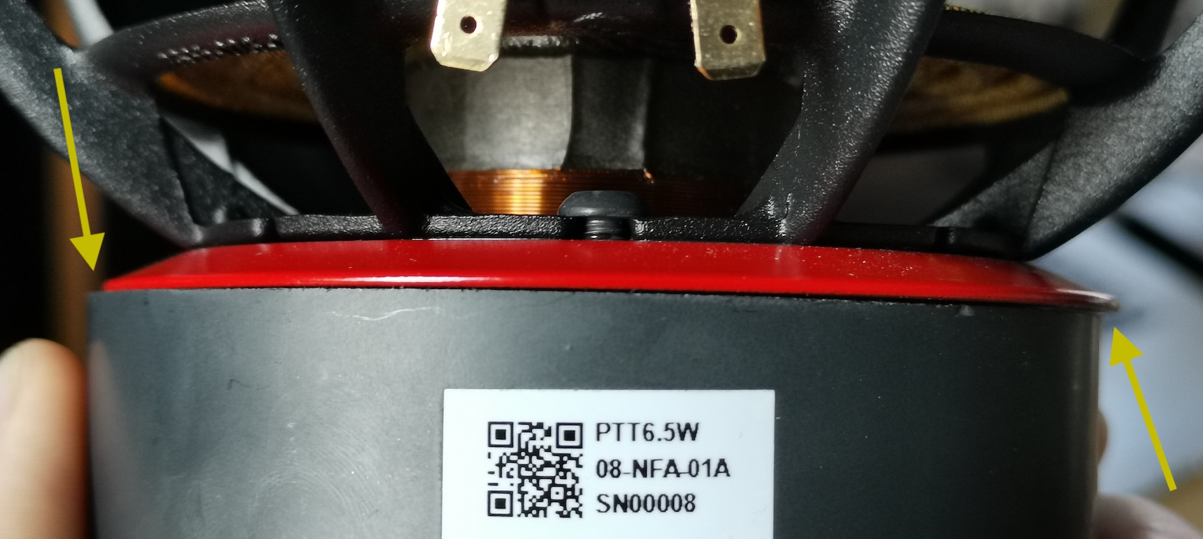

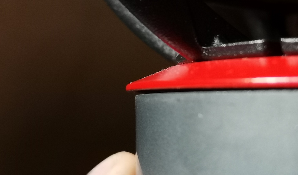

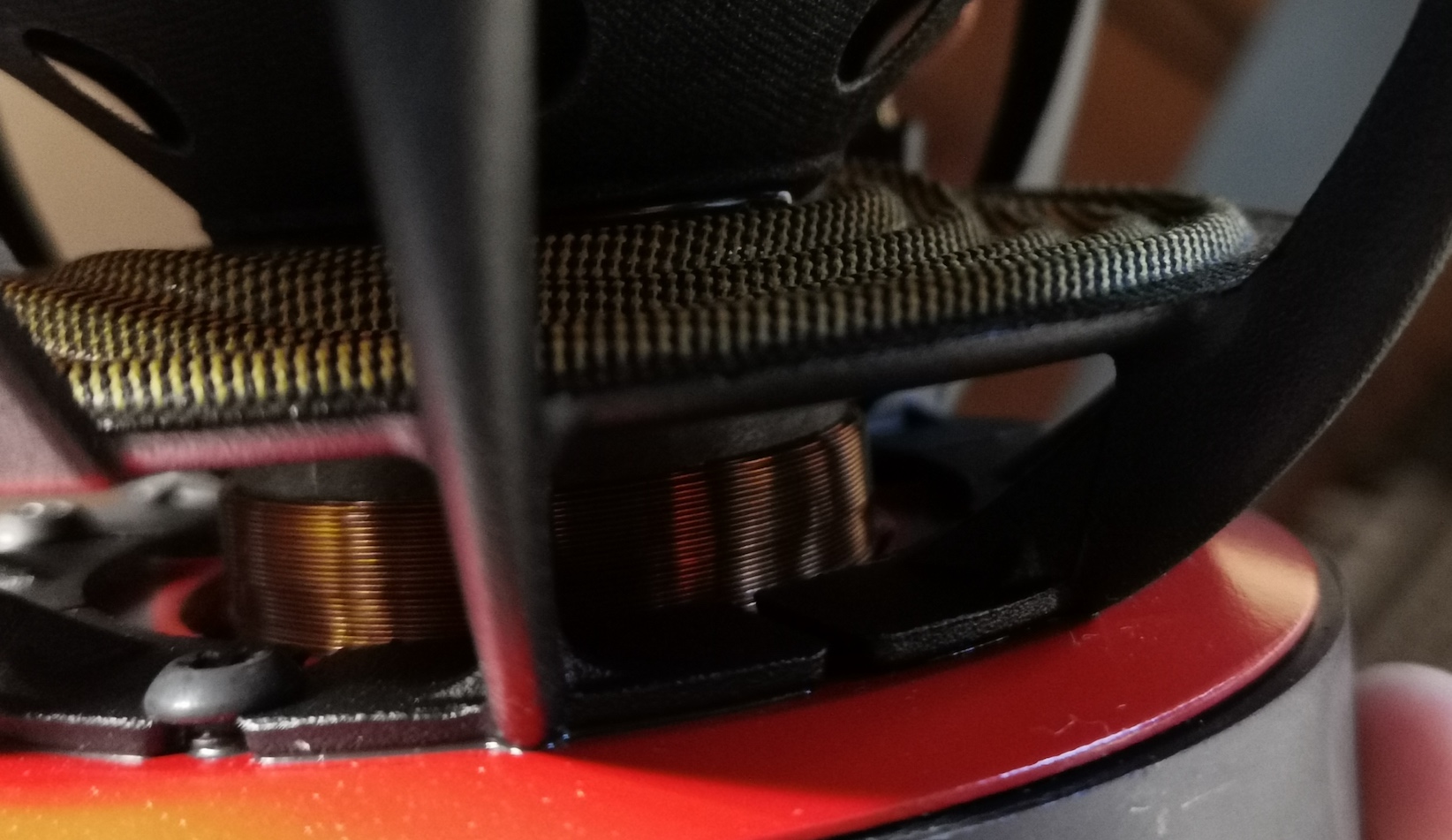

Yesterday I reached for one of the Purifi speakers to demonstrate to someone. The diaphragm stood as still as stone. The entire magnetic system was strongly shifted in relation to the speaker basket.
A very great force must have acted. Coil blocked very hard. Suspension deformed.
The rest of the speakers are fine. Interestingly, there are no strong distortions in the cardboard covers of the box. The package itself, in which they arrived, showed no signs of damage.
Get a good look at your speakers upon receipt from the supplier. There can be unpleasant surprises.
The red perimeter of the basket must be centric to the magnet.

JarBar - You sure seeing as thanksgiving is now big in your neck of the woods you didn't use the Purifi driver to slam Tequila in (joking)? This **** happens freighting to Australia - damage is off the charts! Anyway if not freight damage then quality control ? Slave labour ?
Be interesting to see their explanation.
Warning.
And you picked those up in person correct? So not shipping damage but quality control or ?
