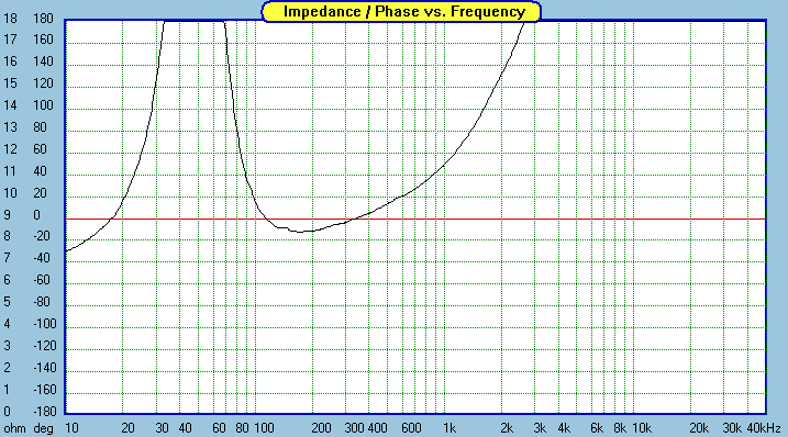

Below is a phase response measurement I did to an earlier version of the Elsinores, but it still applies:
I think this was a hefty 4 Watt input, you can see the pole a bit above 10KHz.
You can see the phase tailor off above 10KHz.
Does that help?

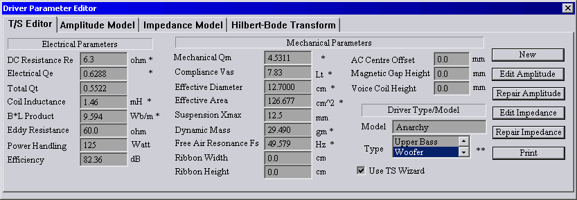

As an aside, I notice that you’re looking at 6.5 inch mid-woofers. You might considered the Anarchy XBL motor 7-inch drivers. Price is $66USD each... Current model numbers are Anarchy-704 (4-ohm), and Anarchy-708 (8-ohm).

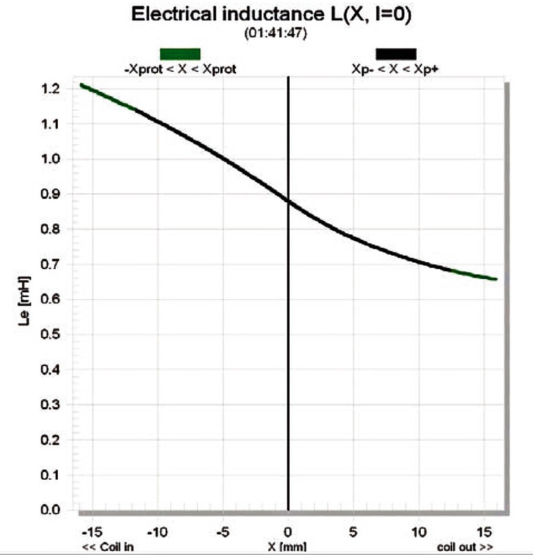

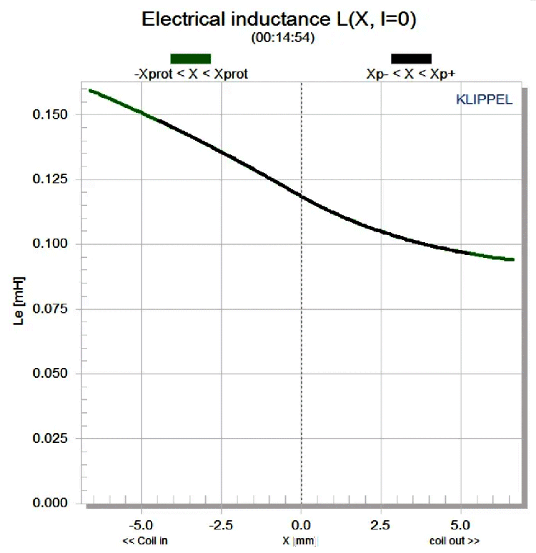

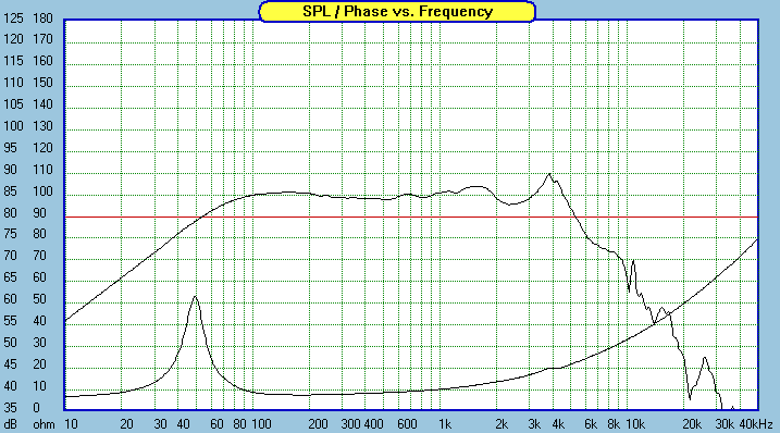

There are a number of reasons this driver is a no-go, but the stand-out is the inductance, which either has to be very low (which applies to our current driver) or is constant with excursions (very rare, but Purifi fits into this camp).
The inductance of Anarchy driver relative to 1KHz and changes in excursion:
I can do this measurement in a rough kind of way with my inductance meter set to 1000Hz (you will hear a tone). Check the inductance at the rest position, then push the cone gently in 4mm and hold still (imagine you have glued the position of the voice coil) and check the inductance. It will go up. Now do it the opposite way, push fingers behind the cone and push out 4mm. The inductance goes down. You don't want this, the force factor goes up when the cone is in the (-) position and goes down in the (+) position. This is not what you want to see, or as little change as possible (Purifi does this).
We are talking about reducing FFM, Force-Factor Modulations caused by excursions, and AM distortion.

EDIT: Internal inductance is bad unless it does not change with excursions. But inductance externally is really good and can used to swamp and flatten the internal inductance. This is why the MFC driver we use now is so good. At 2KHz the inductance is 0.1mH and we use 0.5mH inductor, FFM will be low because of the high external inductance, which changes neither with frequency or excursion, it is a purer inductance (yet not perfect, of course). We shall also use some external inductance with Purifi drivers, I am thinking 0.33mH would be good and 0.22mH also good. Higher the better.

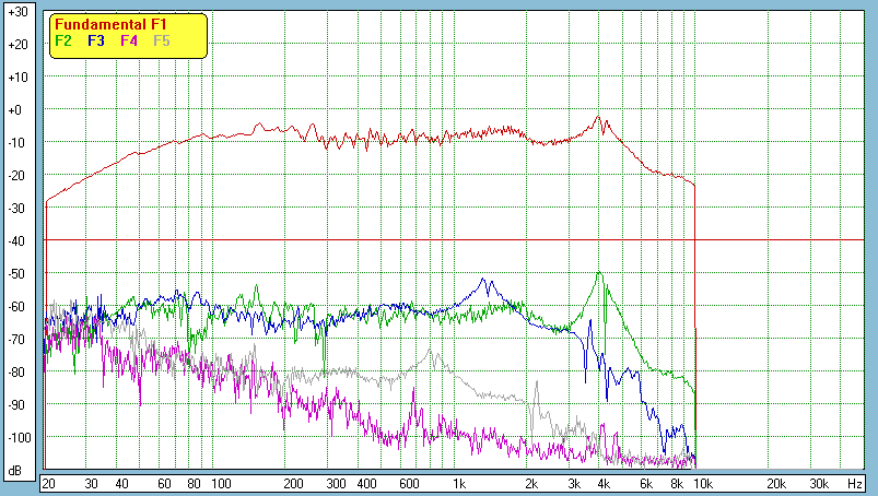

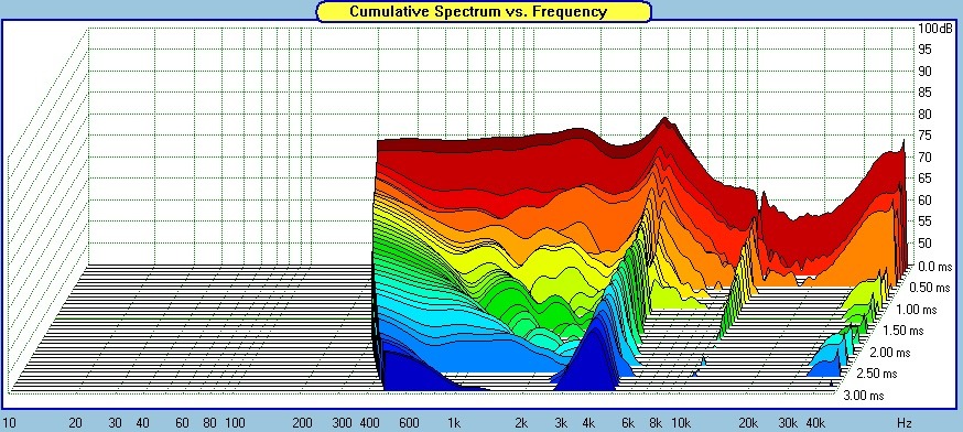

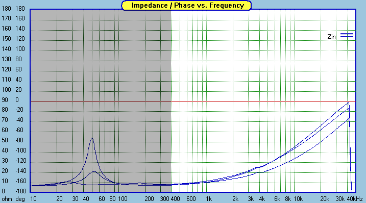

I have taken a sample out and done some tests and basically compared it to a run-in SB17MFC35-08, the current Elsinore driver. Even though the Purifi driver hasn't been run in, the Thiele-Small Parameters are where I would expect even if it had not run in. Maybe they have a;lready done some burning in already before packing.
I will connect it up to my run-in setup for 10 hours and retest, then another 10 hours. That way we shall see if the driver parameters settles in or whether they change much at all. I will post the results here.
But basically, it seems to work out what I have been expecting. The Purifi looks like not quite have the same LF extention, but maybe that is not going to be obvious when you listen to it? It may not have the same extention but it will also be a bit better damped. So it may come down to swings and roundabouts.
As expected, this points to a slightly higher tuning frequency of the box, I expect the 90mm OD port (around 87mm ID) needs to be shortened to 60mm. This will be confirmed later.
