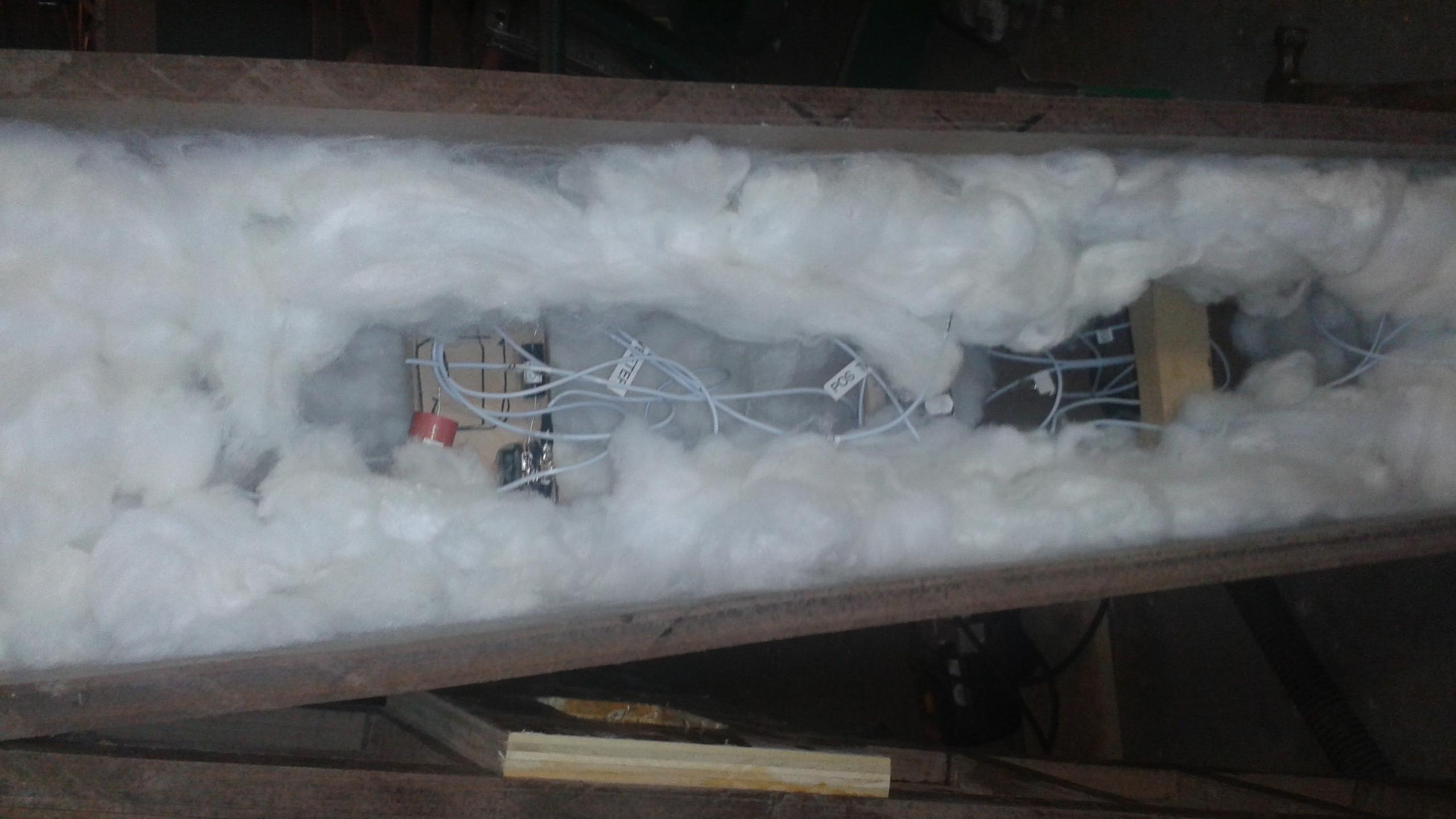

I have some questions about cabinet thickness I am saving. There are no 25mm plywood, or MDF in the states. I am considering doing what I did before, which is laminating 3/16 HDF together. It worked really good, and it's a lot easier to work with than a big sheet of 4'x8' MDF or plywood. MDF weighs a ton.
Damping material does NO effect close to the wall since the air is standing still there. The pressure maximum is close to the boundaries, and so is velocity minimum.
The damping material shall be placed close to the velosity maximum which is close to the backside of the speaker element. And in the geometrically CENTER of the box.
Sorry for my capital letters... :)
In my experience, there is really no rule as to where you place the damping material, unless you take time to measure the difference, generally we try different material and different stuffing methods until the sound is right. Too close to the driver, it actually creates pressure loading on the driver where in some cases, will cause the mid frequencies to be overly damped, which for woofer covering frequencies below 100 Hz only is not a problem. I will be testing some various stuffing methods on a Behringer B300 soon along with other mods.
