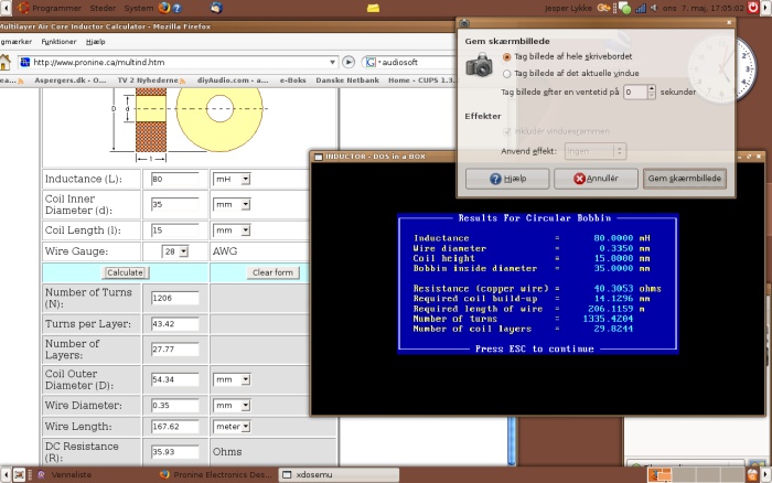

I finally got it (Thx Magura for calling me on landline) ... all the time i thought that the coilresistance was the thing to include into my F3 calc. :wave2: , but the matter, that i only need to include the transductance of the mosfet, at the given mA + sourcerestiance, gives me the calc now. ;)
Thanks all for helping me out.
I finally got the inductor.exe program to work (The link i placed earlier is right) .. on a Linux-dosemu program.
The results, are simmulair, compared to the onlinecalculator.
Only thing is, that the lenght-meassure in onlineprogram, is called height in the DOS inductor.exe program...
See here:
