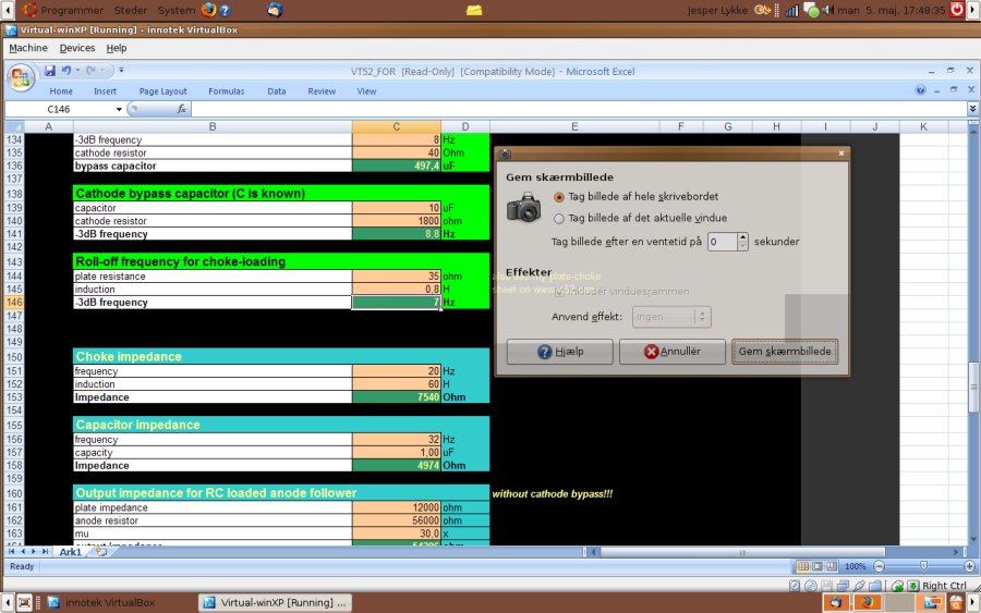

excellent Zenmod ... excellent ...
look at my screenshot ... i calculated under choke loaded rolloff, this is correct right ?
seem's that 80mH is a very good choise, with a 0,335 magnetwire...
Jesper.
EDIT: I got it wrong, it was plate resistance i calculated under ... sry ..
Jesper.

soo Choky you tell me, that xconductance is A/V(Opposite of Ohm) and that V/A = Ohm(part of ohms law), which leads me to just ... nothing! About the result the spreadsheet gives me ... what does plate resistance have to do with that ?

xconductance of Jfet Boz 2SK170 is ( as Papa sez) 1/50 ohms ~ and according to datasheets - 20 to 22mS ...... (same thing written backwards)
according to data sheets , xconductance of irf9610 is ?
so - just recalculate what's apparent resistance of 9610 and you'll know what to include as plate resistance in your xls file ......

lykkedk said:Yes 😉 I see, but i can't see howto calculate 22mS (in fact i donno what it is) into something usefull ?
The trickquistion, is just to tricky for me... 🙁 ... I really would appreciate an explanation instead.
Jesper.
if 170 have xconductance of 22mS , means that his apparent impedance is 1/0,022 ~ 46 Ohms
if 9610 have xconductance of 0,8S , means that his apparent impedance is 1/0,8 ~ 1,25 Ohms
anyway - knowing from da toob world real parameters are these ones measured in working point , you can't be sure in exact values of xconductance without looking at real graphs ;
in any case 9610 have enough low internal impedance , so your chosen 2x80mH choke is good enough ..........
