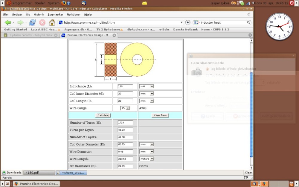

Well 🙂 this is not a inductor-design thread ... but i found this LINK! which i found very interesting. I tried to wind up, and old ''1mH 1mm 0,49 Ohm'', and the inductor-calculator was calculating very near that coil.
So... my quiston is now, if i should go for thick >=1mm or thin <=0,6mm Cu wire ??? The DC-resistance goes up, when wire gets thinner.
I would sure like to know, if 120mH with 1mm wire (6 ohm) is better than 160mH with 0,5mm wire (26 ohm) ... Hope someone could help me out, with a little explanation.
As Magura told me, some day's ago, i should just wind up two inductor's in one, so that i have two let's say 0,49mm. wires laying aside in that form.
The trick when calculating using that link, is to just double the length(please see, where length is messured on link) of the coil, and use the same number of turn's for getting two inductors in one.

lykkedk said:Well 🙂............
that really depends of your goals ...... what's the current through coil , what are losses you can allow .
for Drek - 160mH is certainly better than 120 is certainly better than 12 is certainly better than 1,2 is certainly better than 0,12 is certainly better than 0,012 is certainly better than 0,0012 is certainly better than 0,00012 is certainly better than 0,000012
Well, i allready know that 160mH is better than half, but when looking at schmatics i can't tell how much current, that will flow through them. Actually i would like to know, the benefit of having small/large (high R or low R) in thoose chokes in this circuit.
Making a 160mH dualcoil with 0,25mm wire is much easier than doing it with 1mm wire. So what's the deal regardingn thickness/Resistance ?

Resistance is only a matter of heat/loss. As loss is diminishing low in a pre, heat is the factor to be aware of.
The party begins at 0.25mm wire, where it ends is up to your wife😎

Well if heat is the thing, i will make my inductor's somewhere between 0,40mm - 1,00mm thickness to avoid to big resistance.
I took a scr.shot, of what i had in mind... The coillength will just double when winding two inductors in one (2x120mH)
Does it look ok?
Jesper.
lykkedk said:
Does it look ok?
Jesper.
No, the number is 2*80mH
0.49mm wire is somewhat big for this, you may run into WAF problems.
Magura 🙂

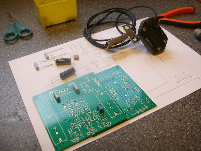

Cviller i recieved my package today, thank's for being so quick, especially thinking that you are occupied in house painting etc... How are you proceeding there ? good i hope!
I have attached a picture, and top-right is a DIY-counter, made by part's from pedometer, and rpm-controller from some crane 😉 I will have to use it for winding inductor, when i have figured the right size.
Jesper.
