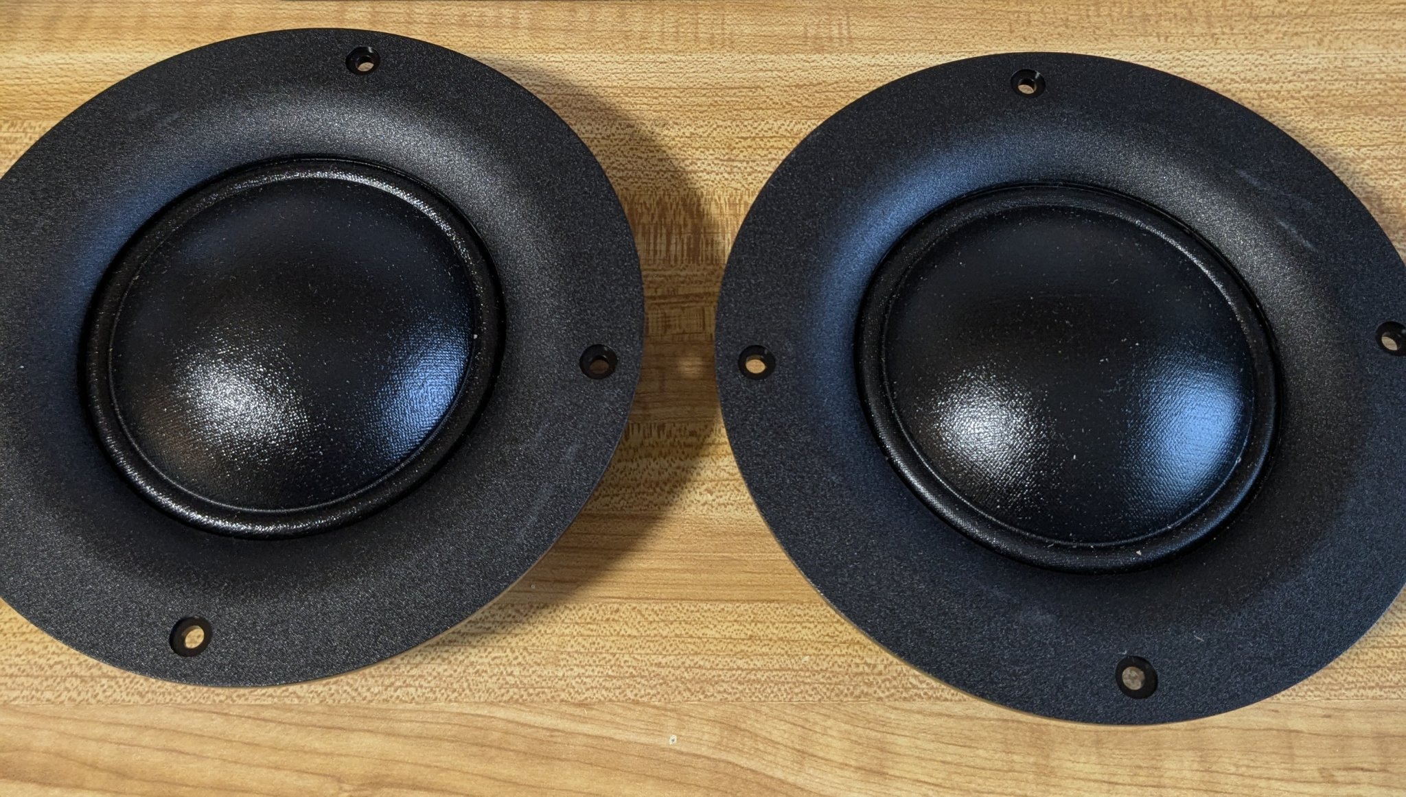

ScanSpeak domes arrived this morning! Will use with Scan alum 8 inch woofers and Morel CAT 378 tweeters. Triamped, Mini DSP, Topping PAS2 amp on the tweeters, Hypex NILAI on the mids, Behringer A800 on woofers. Enclosures being planned now. Cant wait! Will sit atop my 12" subs for home theater duty. Crown Class D on them.
