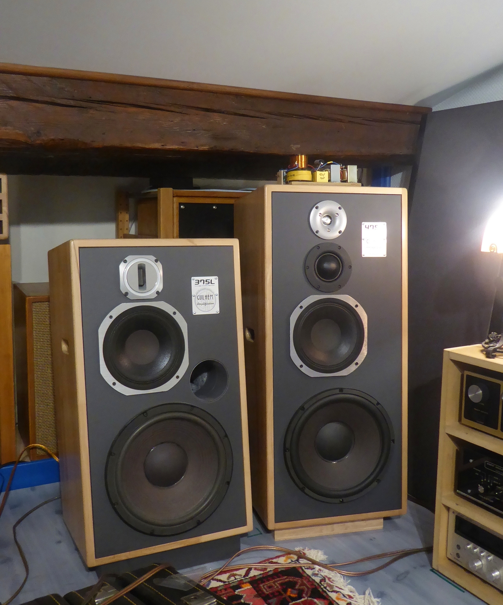

@tubelectron Is that a Beyma CP22 tweeter in the smaller speaker? What woofer are you using in the right speaker? Beyma?

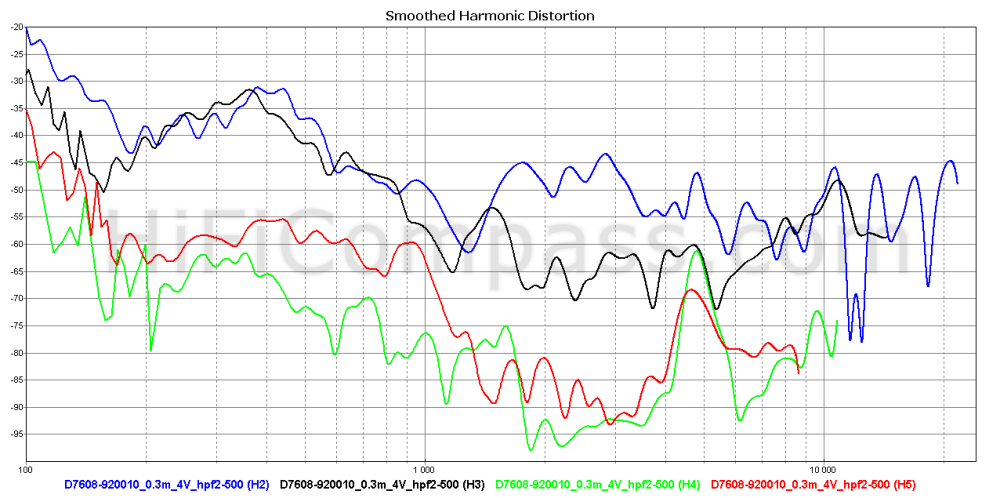

Simulation-
D7608 (stock unit) SPL with rated 100 hr RMS Noise test with 2nd order Butterworth high pass with 80W (25V applied) (IEC 18.4)
So clearly it won't be destroyed with 500Hz HP filter, but could do with some optimization to improve it's performance below 600Hz...

@tktran303 The D7608 is definitely capable of a 500 hz 4th order HP and will easily cope with 105+ dB levels from a thermal standpoint. I've already tested this myself and the results were more than promising. This big dome will dish out decent SPLs once it has a proper air space to work in.
The factory specs show a highly elevated Qts that can easily be lowered to under 0.7 with proper chambering and dampening. Again, I already figured that out via my own research, otherwise I wouldn't be bothering with it.
My standards are rather high when it comes to SPL capability. I wouldn't bother with anything that can't hang with at least 105 dB system SPL. Dynamic range capability is very important to me, especially on a 3 way system. Why would someone bother building a 3 way speaker to begin with if it can't deliver decent dynamic range?!
Please forgive me for sounding like a broken record, but the evident lack of lower mid SPL on the factory supplied FR curve is simply due to a missing rear chamber. This certainly isn't doing this driver any favors in the marketing department. This is also mainly what produces the elevated 3rd order distortion below 1k. Once the diaphragm has a proper linear spring to work with, it makes things sound much cleaner in the lower mids and even improves SPL capability in this area.
I'm glad you were inspired to build that design with the MD60N. Its a good mid, but I wish they would have dampened the chamber a little better.
For the 375L speaker, at left :
- Beyma CP21/F
- Beyma 8M60N
- Beyma 12B100R in Bass-Reflex configuration.
For the 475L speaker, at right :
- Beyma T2030
- SATORI MD60N
- Beyma 8M60N
- two Beyma 12BR70 in Sealed Isobaric configuration.
It's not clear to me that the MD60N can be modded in a non-destructive manner.
Yes. At the request of @profiguy, I tried to open it in order to check what was the chamber damping.
But nothing wanted to move, so I did not insisted... Sorry ! 😕
T
@tubelectron 12BR70 and 12BR100 are nice drivers for larger boxes. The CP21 and CP22 are some of the last ring radiator tweeters available. Both are good, but the CP22 is a little better
