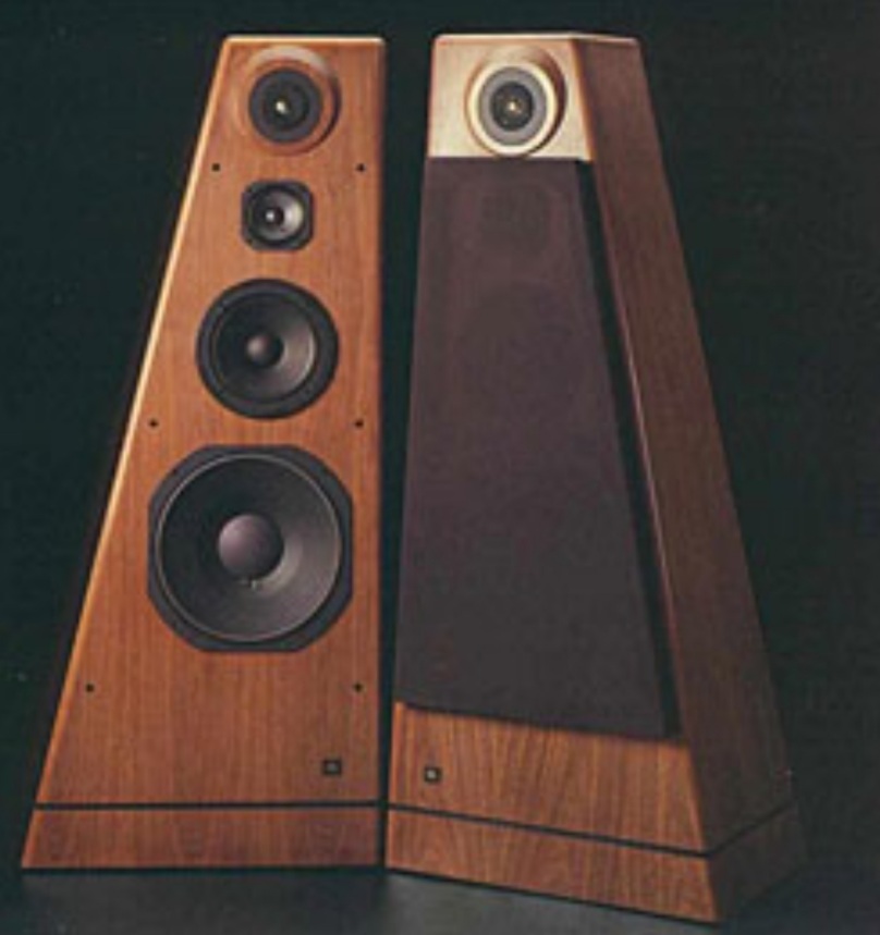

@hifijim You probably already figured out that going from a large cone to a proportionally smaller dome (along with its different geometry in radiating surface) by nature results in a shift in directivity. The two things which can partially fix this either is shifting the turnover frequency slightly from a shared turnover frequency and / or gradually changing (tapering) the baffle width to help get a wider DI with the larger cone. Sometimes it requires more overlap, which has to be compensated for by using a different or modified rolloff slope. I'm not sure that a sim can show this accurately. Tapering the baffle shape is one option, but isn't flexible if the shape isn't as the sim suggests. Diagonally tapering the front baffle towards the mid and tweeter is one way to achieve a more gradual DI from the larger cone. Of course these are just generalizations and some experimentation will be needed, but narrowing the baffle towards the tweeter (among other things) has always worked for me in this regard.
This is the JBL 250ti -
