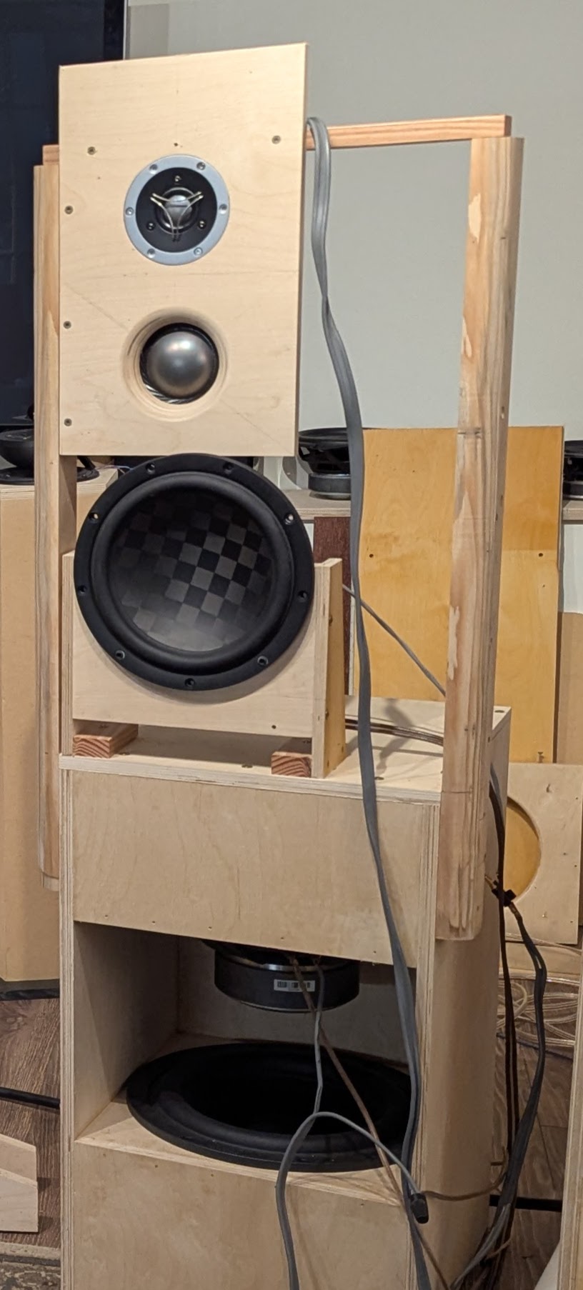

I've started cutting the panels for the Peerless towers using 2x NE315Ws, 2x NE180Ws, 2x D7608s and 1x DA32TX. An alternate mid/tweeter combo would be Morel 2x CAM558 and 1x CAT378, which I'm leaning towards due to tighter CTC spacing. They can also be crossed higher from mid to tweeter, which is IMO more important. The mids already have chambers on them.
The NE180W are awesome midbass drivers. I'd say they're one of the best midbass under $100.
The D7608s can be difficult to linearize with a passive network on a wider baffle. Usually they need a slight negative LF shelf under 2.3k for BSC.
The vent is pretty big, actually:

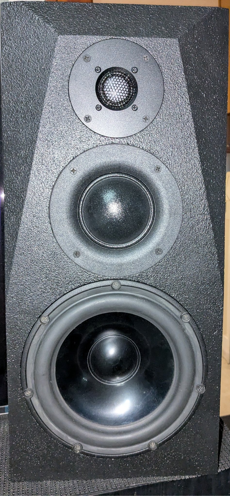

Here is a picture of the speaker project, this is a prototype cabinet ,I plan on something a bit more refined in the future. Currently crossing the mid at 700hz on the low end, and 4000hz at the top end. Much lower on the bottom end and the mid sounds distressed to my ears, at 500hz it doesn't sound near as clean, even though distortion measures fine. Using 4K at the top end to keep the tweeter well within it's comfort zone, and it does sound very clean and open. Tweeter is a Chinese brand "Mellow David", and has been tested as a very good performer elsewhere on this forum. Supposedly a beryllium dome but this isnt confirmed. I actually like it better than the SB beryllium dome, I have tried them as well, in other projects. Tried a decent fabric dome tweeter in this project and it just lacked resolution and clarity. I'm targeting 24db crossover slopes, but its a bit tricky with the mids limited bandwidth and my limited experience! But, so far, the speakers are probably the best mains I have had. Very clean and transparent sound, and deep and wide soundstage. Distortion is minimal, at 78db, which is about where I listen, 2nd order is just .06% and 3rd is a mere .029! This measured using a Umik 2. So far, so good! I have not quite got the baffle step comp just where I wanted but it's darn close, male and female voices are very realistic, perhaps just a touch lean. My reference music CD's sound better than I have ever heard them, and for movies, the 5th Element for example is just stunning! So thanks for your help so far profiguy and any additional tips from anyone is welcome as well. Click image to see full speaker.I was helping @Troy Madden with his D7608 tuning. He got some decent results. I can't do too much right now being this way but I'm trying to finish a successful print on a pair of the rear chambers, which was repeatedly ruined by the flaky power issues we had.
The PMC IB1S, looks like it uses the Scanspeak 3" dome? However they are using a 380Hz 24db crossover point and that seems very low for the Scan mid? Even at 500Hz in my project they sounded strained and lost transparency. I wonder what they have for the midrange enclosure?
PMC describes the xover by the electrical circuit, not the acoustic rolloff. It is likely that the electrical slope is 4th order and the acoustic is higher by at least 2 orders.
I thought about that. But then a steeper slope means the mid is seeing more energy closer to the crossover point. I wonder how they keep it flat and clean that low? X-max is pretty limited, I wonder what the excursion is at higher SPL's?PMC describes the xover by the electrical circuit, not the acoustic rolloff. It is likely that the electrical slope is 4th order and the acoustic is higher by at least 2 orders.

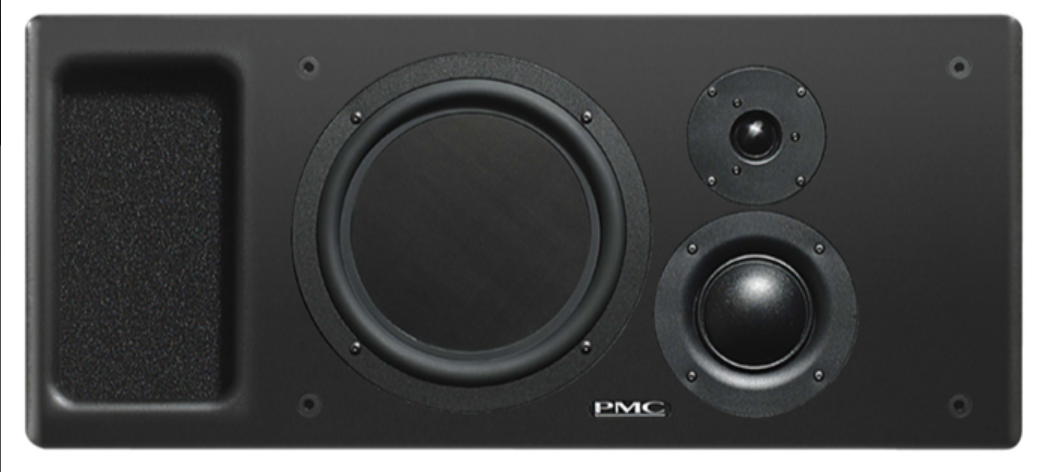

I've owned 2 pairs of PMC IB1s and can say without doubt the mids are slightly modified versions of D7608s. The only difference is the rear felt on the motor.

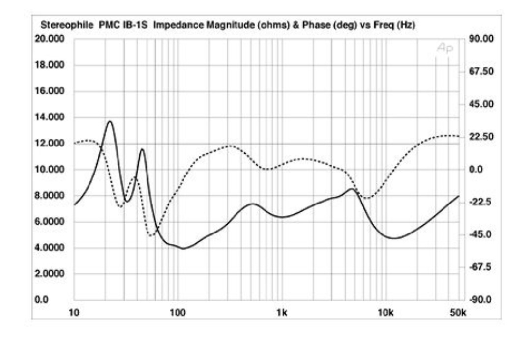

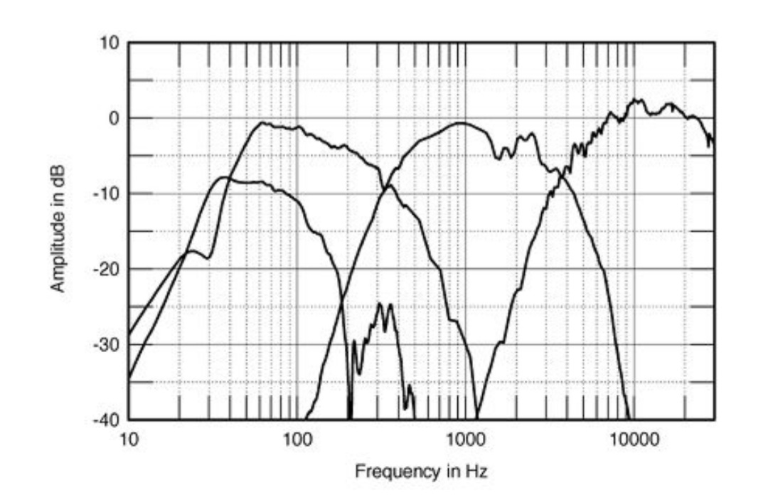

Below are measurements taken from Stereophile. These are in line with the system measurements I've taken a long time back.
PMC IB1 individual driver FR -
and impedance/phase plots -
The mids cross electrically between 500 - 600 hz but the higher Qtc of the mid shifts that down closer to 400 hz acoustical HP. The rear chambers are roughly 400 ml net on the IB1s with some heavier fiber material dampening the chambers. The upper end mid LP is also altered by the climbing acoustic response coupled with the baffle dimensions influencing the final FR. The other big influence on the system FR is the driver overlap gain in the mids.
