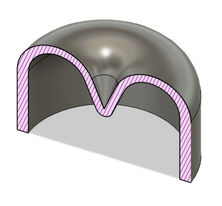

Finally, a significant update on the D7608 chamber progress -
I got the CAD files back from the generous fellow on here who graciously volunteered his time to make this happen. Out of respect for his privacy and sanity that he doesn't get swamped with tons of PMs here, I'll let him decide whether he wants to be mentioned or is able to answer any questions regarding printing them.
I'll be posting the STL file once the design is tested with absorption media in place and it fits the D7608 as intended. The chamber design is for personal use only. Any commercial use should be cleared with me first.
Initially I'll be printing a pair of test chambers from PLA to verify the overall fitment and perform some measurements. I took inspiration from the newer Seas T35C002 design, as it requires minimal mechanical dampening to achieve decent decay spectrum and avoid most common standing wave modes.

I think he'll gladly answer eventual questions 😊I'll let him decide whether he wants to be mentioned or is able to answer any questions regarding printing them.
Exciting! I'm clueless when it comes to 3D printing but are there many choices for the material? Is this PLA as good as any?
The mostly double curved surfaces of this chamber inherently make it very stiff and PLA should be perfectly fine as material.Is this PLA as good as any?
For best air tightness it may be necessary to print it with a high infill ratio and/or cover the surface with filler, primer or paint.
For high power applications PLA may be too heat sensitive, it's getting soft above ~ 60-70° C. Also consider heating up of an eventual bass enclosure outside the mid chamber.

I was thinking of using CF loaded ABS. Its not that hard to print if you're hot end can do the extra few degrees. I'd imagine PLA would be more than sufficient temp wise for domestic applications. There are quite a few types of PLA with varying durability. I've used the SunLa PLA pro on several prints with very good results. Its very tough material and cleans up very easily using abrasives. I recommend at least a 50% infill and probably would do 70% if you're not in a hurry. If the printer nozzle is extruding correctly I don't think there should be any concern with getting an air tight seal. I usually put a skim coat of cyano on both inner and outer surfaces if there's any concerns with sealing, but I really doubt there's going to be an issue.
To adhere the chamber, a higher grade hot melt adhesive would be more than adequate and leaves the option of gaining entry if something should need attention inside. The inner ID may need a little tweeking depending if your printer under or overextrudes, or if the scalar is set incorrectly. There are of course production tolerances on the dome itself leading to ID tweaks. You'll have to check your own printer for any stack u tolerances.

You might already know but abrasive filaments need a hardened nozzle to print. I like CF PETG for it's dimensional stability, it's also got a bit of damping, but the filament can be variable by manufacturer. QIDI does a glass fibre ABS that is incredibly tough, although quite expensive. That doesn't warp either. PLA prints easily but I always feel like I'm holding a toy not a product.I was thinking of using CF loaded ABS. Its not that hard to print if you're hot end can do the extra few degrees.
Increasing the number of wall loops is the best way to increase strength. It also makes the print look better.I recommend at least a 50% infill and probably would do 70% if you're not in a hurry.
