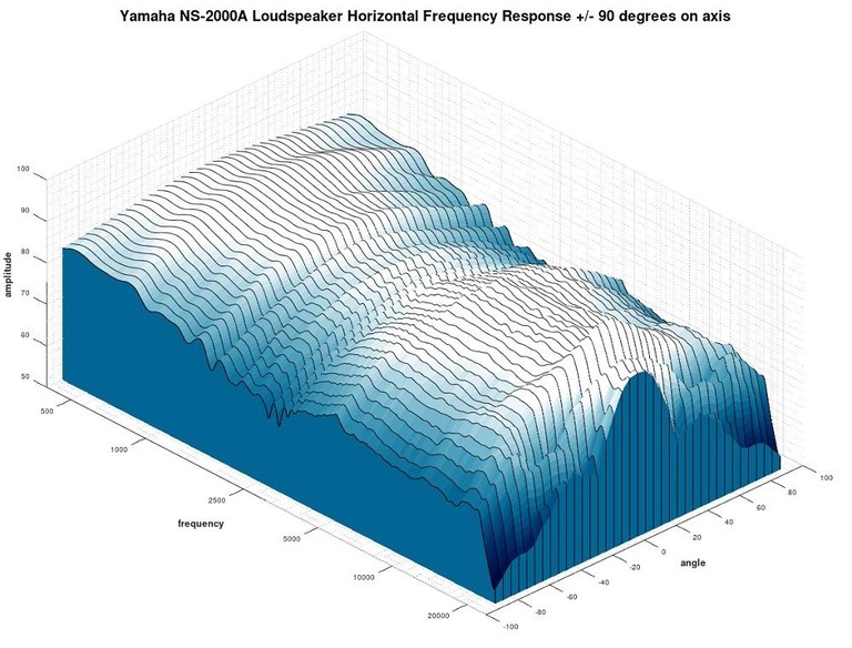

https://www.audioholics.com/tower-speaker-reviews/yamaha-ns-2000a

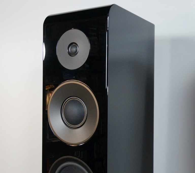

A large waveguide in a narrow cabinet!
Very interesting. Dome midranges live on! I see they didn't make any attempt to enclose the surround. I've been experimenting with that a little, and some initial tests showed improved dispersion up to a certain point before a notch in the frequency response happens on my Dayton.
They also didn't try to smooth over the transition between the waveguide and the baffle. Just a cone with a nice, crisp edge.

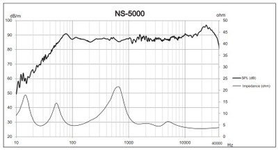

Is it me or this does not measure $8k great?
No, it's not just you. The big dip in the mids centered between 2 - 2.5 k along with the rapidly changing vertical directivity peaking at 5k makes these speakers sound too upper midrange forward. Comparing this to more expensive B&W, which also tend to measure poorly, the directivity change in the upper mids isn't placed in a benign frequency range. Most higher end B&Ws however are crossed in the mid 3 -4 k, right where the ear is more sensitive. This chosen crossover works better because of the ear's loudness curve centered around 3 - 4 k. A dip in this range sounds pleasant and relaxed, especially with louder music. This is a reason why many B&Ws sound good at higher SPLs, plus they can be tuned with toe-in or out at the listening position. This theory doesn't work with the Yamahas due to the suboptimal 5k directivity jump and unpleasant lower midrange wandering scoop. ListenIng above the tweeter axis helps but indicates poor crossover phase response throughout the entire mids. The average elevated 5k gives a false sense of detail and makes it difficult to listen to most contemporary style music.
