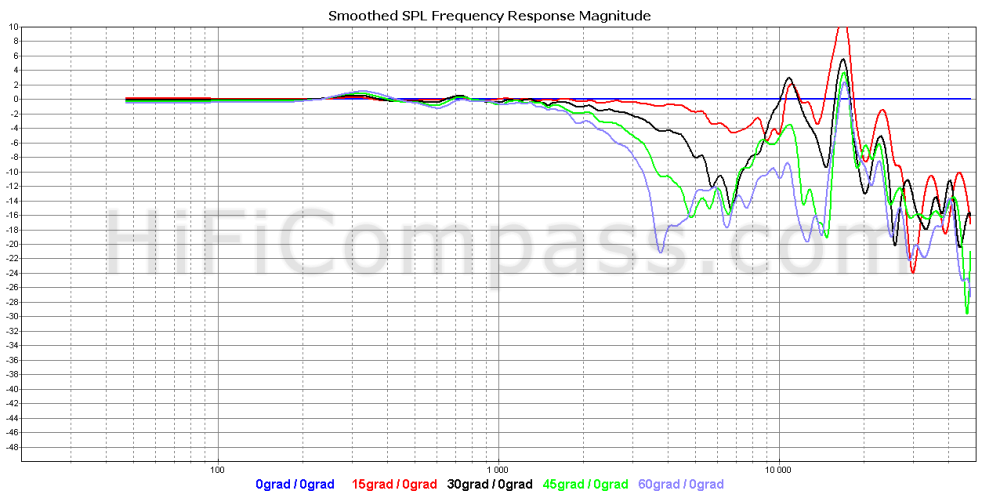

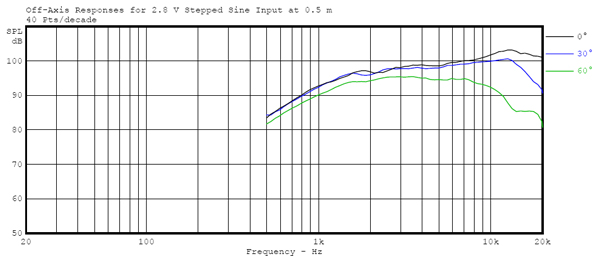

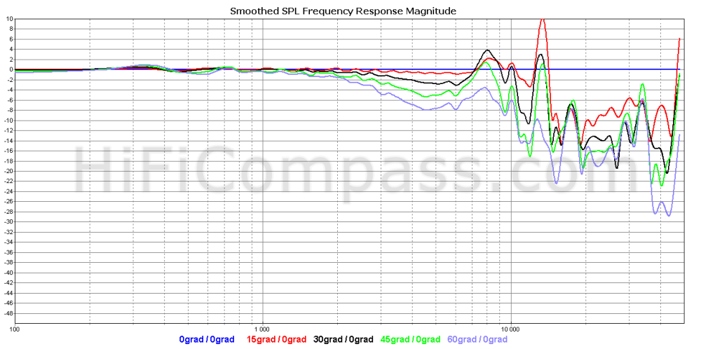

I've been thinking at this old post ever since I first read it and have a couple of questions:
  • Would you still recommend the Audax as the best match for D7608?
  • I think you mentioned in other posts you like crossing this midrange to 3-3.5Khz, is it the case for the Audax too?
  • Looking at the directivity of the D7608 and the Audax at 3.5Khz, it seems there's a severe mismatch at about any angle off-axis. This might be addressed to some degree by careful baffle design but it still looks worrisome?
Thank you!
D7608, normalized
Audax TW025A28
By comparison, the Bliesma M74A looks much more well behaved.
Reactions: motokok
@SunRa If you can afford the M74A then I wouldn't hesitate to recommend it. Its definitely in another performance league than the D7608.
Looking at your sim, there are more factors to consider ie. filter slopes, baffle geometry/size/layout to name the main ones. What data are you using for the sims? The manufacturers info on the D7608 and TW025A28 should be taken with a grain of salt.

The plots are not sims, but measurements performed by hificompass. Sorry, I should have mentioned, links are here: D7608, M74A.
The Audax plot is from the Madisound datasheet.
I couldn't find other measurements of the Audax on a flat baffle. However it seems it behaves really well with an waveguide.

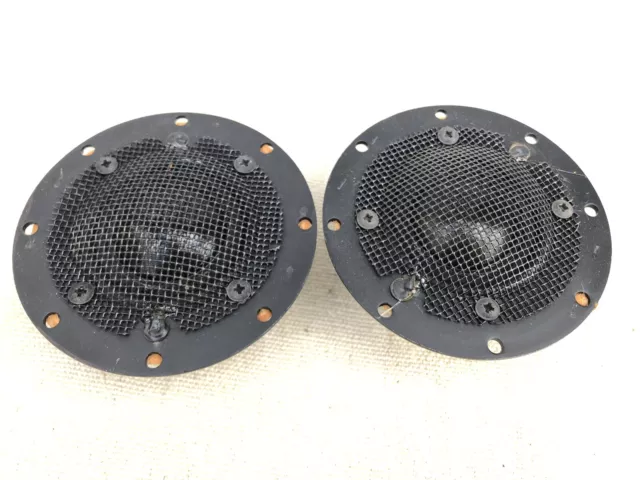

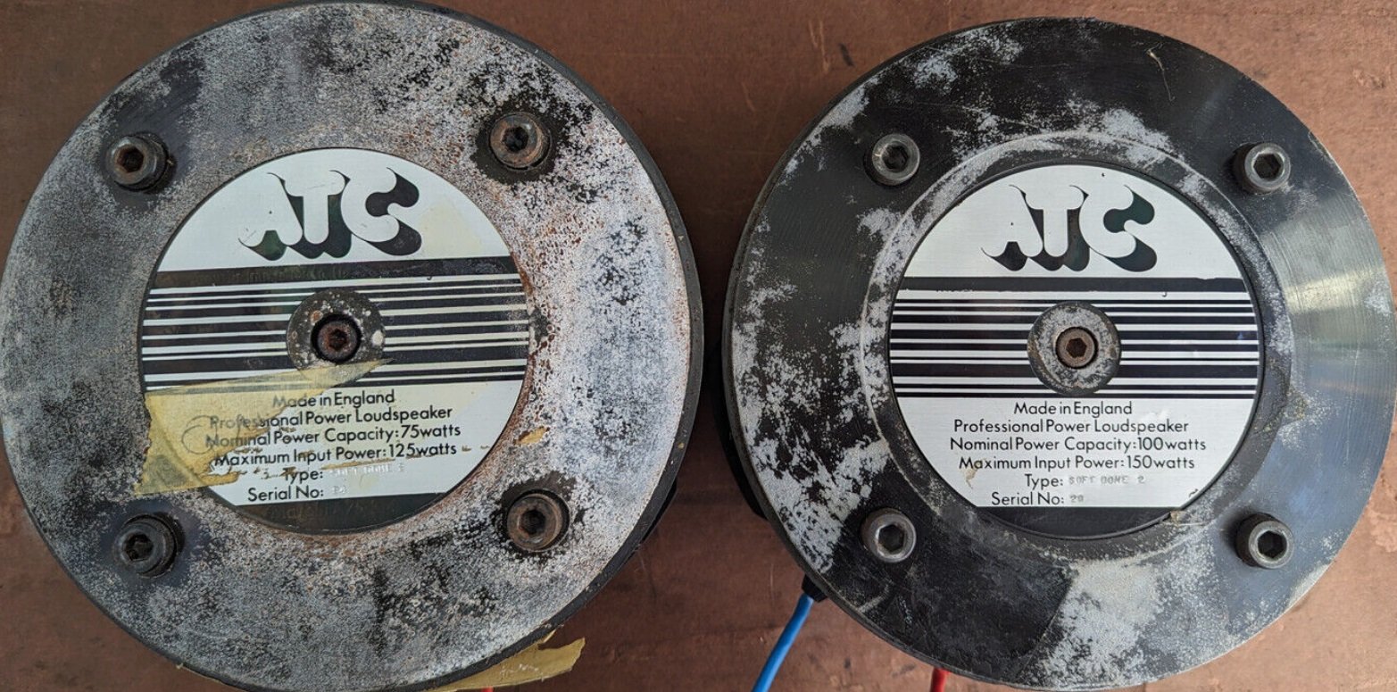

A pair of very old (SN 29 & 94 -Early 70's?) and beaten up ATC midrange domes for sale on Ebay: https://www.ebay.com/itm/296043432484
Not recommended, but interesting from an historical point of view. Labelled as 'Soft Dome 2' each with a different power rating label, one from a PA-75 bass driver and the other from a PA-100, I assume that means there was a Soft Dome 1?
Cheers, Ralph

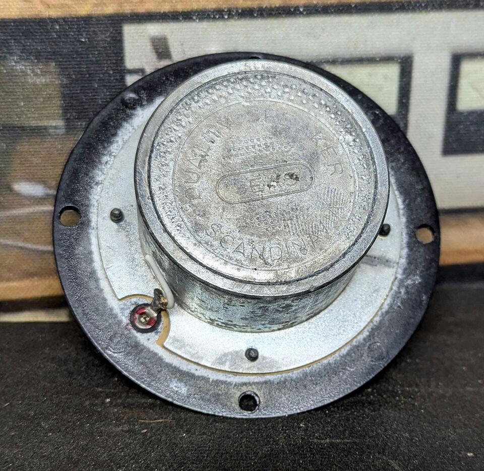

I would like to shine some light on this old classic Seas DOME 87 H Alnico which is not really a dome mid range or a dome tweeter but a little of both. Many years ago i had some great results with this dome speaker in a two way with a 6 inch bass driver. The mid band was simply great and i believe, a clever way to go for a two way which combines a seamless mid band at the cost of some very high frequencies which i did not really miss because the over all sound was that good!

@Henk Haring That Seas mid-tweet is a lost gem. Its funny how they did things more right back then for the sake of midrange purity and clarity instead of inaccurate, boomy bass and sizzling treble. Later on, the people selling us audio equipment were trying make their products desireable by focusing on specs and the bragging rights they garnered.
Fact is, consumers used to be more vocal of what they wanted from a product rather than manufacturers defining the customer and the taste they should have. Its basically being told what to like and buy. That's really what's essentially wrong today with advertising and marketing.
Those older speakers did a much better job at conveying the music at the time than the junk they sold us later on based on advertised hype. American speaker manufacturers marketed specs more than relying on the impression the customer got from the actual performance of the products.
Science is an important foundation to define performance and push the boundaries to improve products. It isn't however a sole valid substitute of process which should define how the actual quality and performance are perceived. That's like someone trying to tell you what kind of food you should like to eat based on a third party scientific chemical analysis of its taste.
