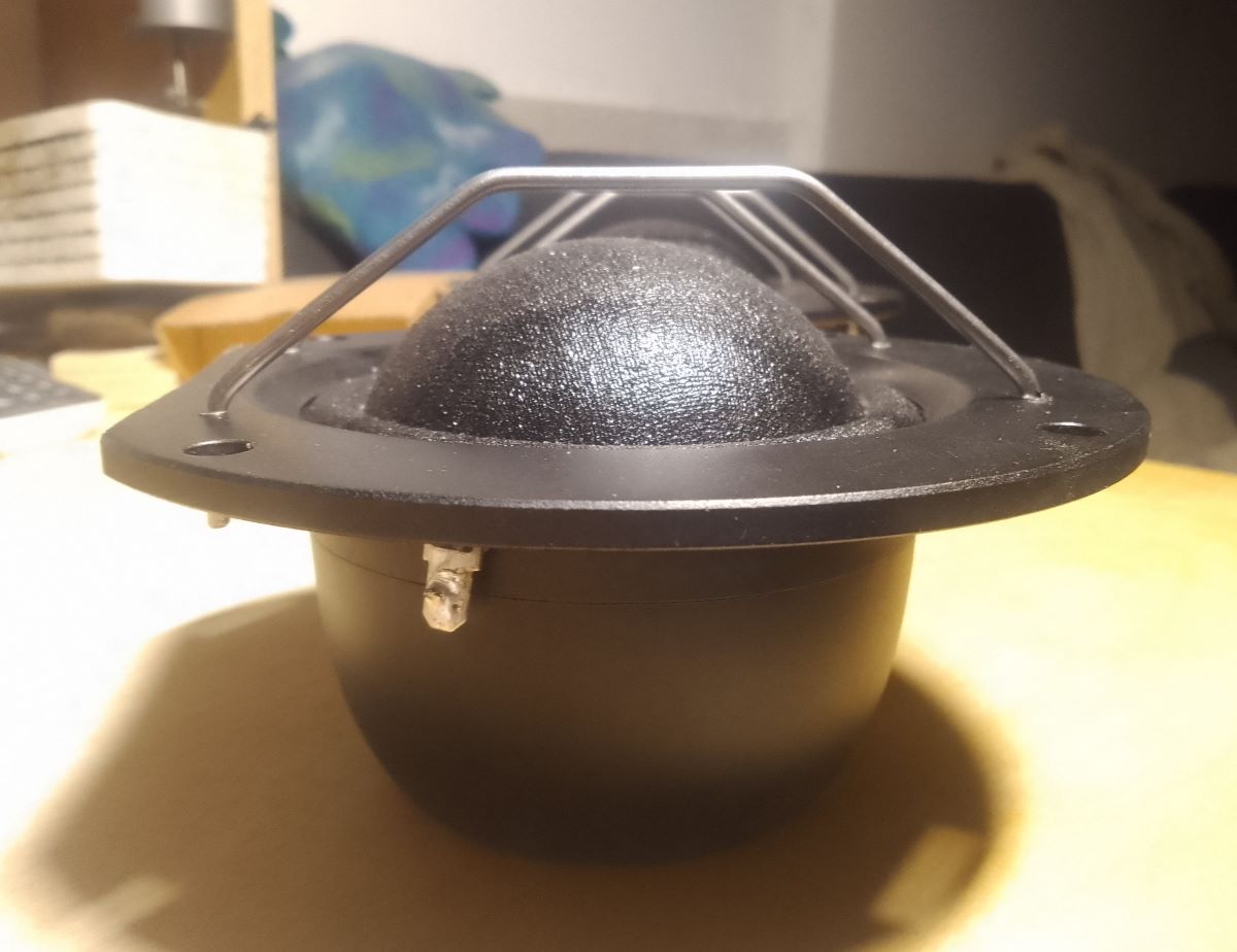

The tweeter that goes with this mid has got some concerning resonances just above Fs. There are two significant bumps there which could be caused by the chamber design and VC gap venting. The price point looks good, but I'll need to see some further assessment. I do like the compact design. It looks a little like a rip off of the bliesma faceplate design.
If used with the mid dome at 3-4K crossover the resonance should be attenuated. I think this combo looks promising with a 93-95db midbass 500hz and up.

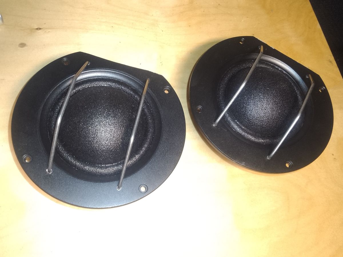

The second pair of HiVi has been fitted with protection.
They are super sensitive to brooms or the wrong hand movement.

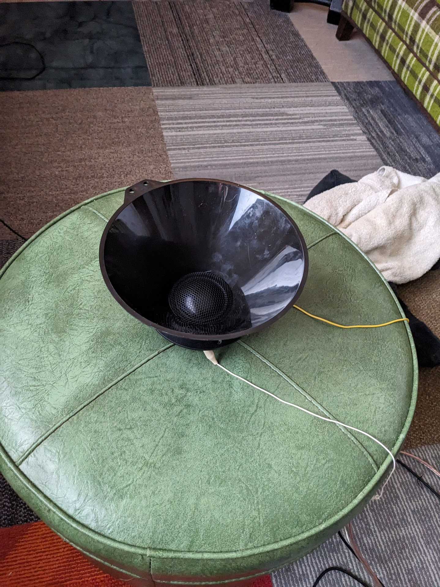

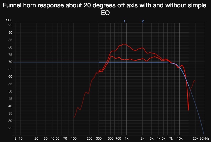

I bougth a Daytong RS-52an and loaded it into a horn made from an 8" diameter $2 funnel. Lol! With some simple EQ it's pretty impressive sounding. There's a notch on-axis at about 7kHz, so useable I'd say from 500 Hz to 5 kHz. Strangely, off axis you can see that the usual spike at 12 kHz looks like a deep notch. I also applied a litle EQ to bring it down, so the notch effect from being horn loaded isn't really that deep. Maybe with some expertise on the throat design the response could be extended a bit higher.
I've taped the funnel to the Dayton driver and set it on a stand so it's pointing at me. Looking at the in-room response at the listening position I'm seeing decent output down to about 350 Hz, and up to about 13.5 kHz. That's with the midrange EQ'd down quite a bit. Crossing it over to my woofer horns at about 350 Hz yields a surprisingly smooth and pleasant sound that doesn't seem strained at my normal listening levels. I think there's some hope for this with a bigger horn. Also, the notch at 12.5kHz is not apparent in whole room response, Instead, just a huge peak at the 12 kHz breakup that needs to be EQ'd down.
More on the Dayon RS-52an. After messing around with plastic funnels on these dome midranges, I finally had a listen to them in stereo without a horn. No baffle of any kind. Just propped up and fairly clear of any nearby things for sound to reflect and refract off of.
I have to say, these do deliver on some of the promise of what I always hoped a dome midrange could do. I added an FIR filter to flatten the response and phase out between about 500 and nearly 20 kHz on axis. Off axis they roll of above 20 kHz of course. But it sounds pretty amazing when crossed over to some woofers that are completely different - a big stack of horn woofers. It doesn't sound as solid and direct as it did with the funnel horns. But it's super detailed and the imaging is spooky and magical.

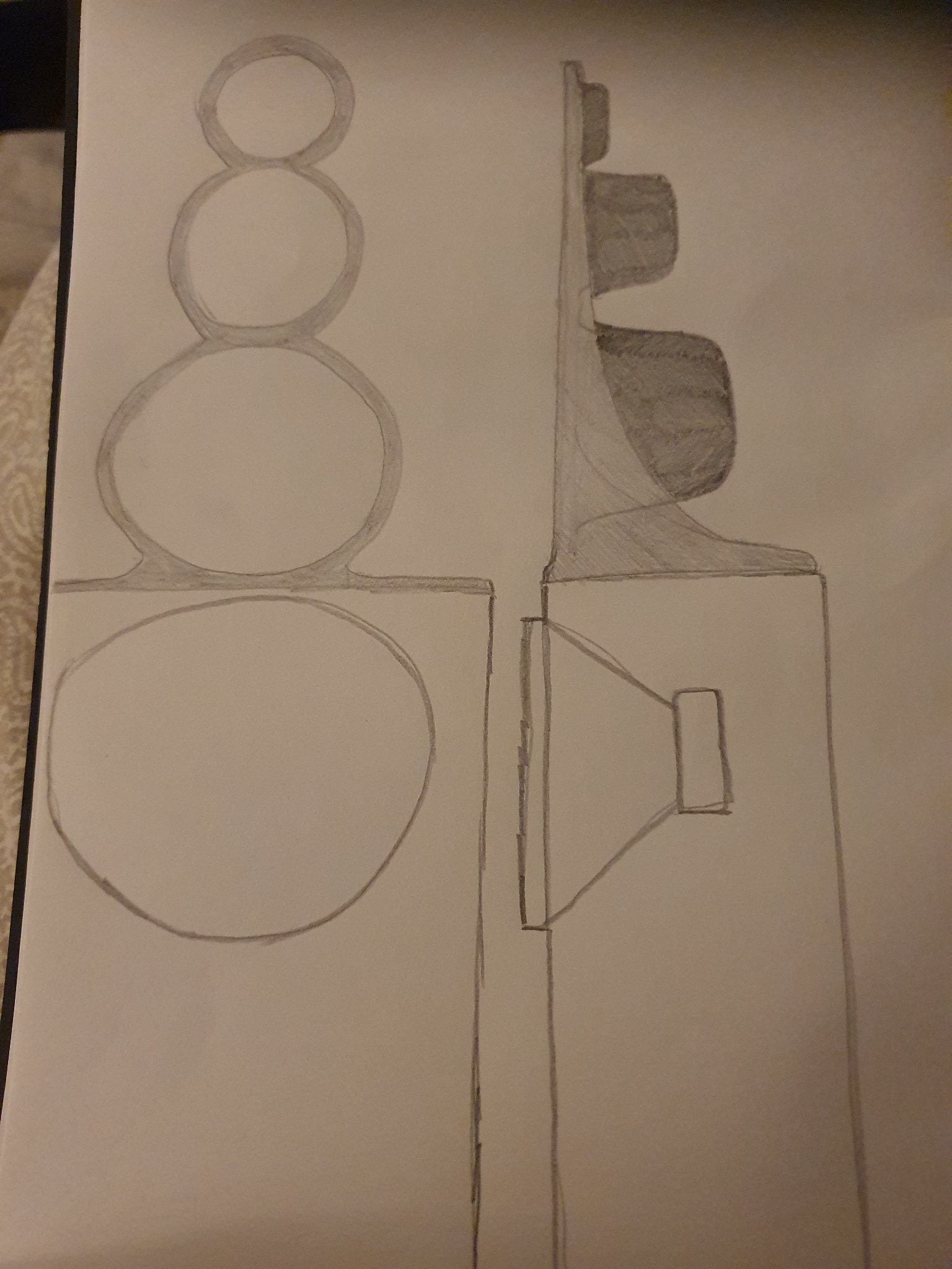

Well yes that has been done:
1”
2”
5”
Then you choose your separate bass bin or subwoofers below ~150Hz
So now we have smoother transition between drive units and lower directivity in the horizontal plane.
But compared to a coaxial we have asymmetrical directivity above and below the on/reference axis.
If we want symmetrical directivity in vertical axis a coaxial will be better, but the directivity will be higher.
trade offs.

thanks that's sort of what I meant but more like this included sketch . I have dynaudio tweeters and d76 middomes and 9.5 in bass drivers and was thinking of picking up some 5inch dynaudio woofers from their automotive line to bridge the gap . moddled the ts parameters of the driver I had in mind and it gave a f3 of 100hz in a 7ltr sealed enclosure so should work perfectly ? can you see any problems with my little idea ?
