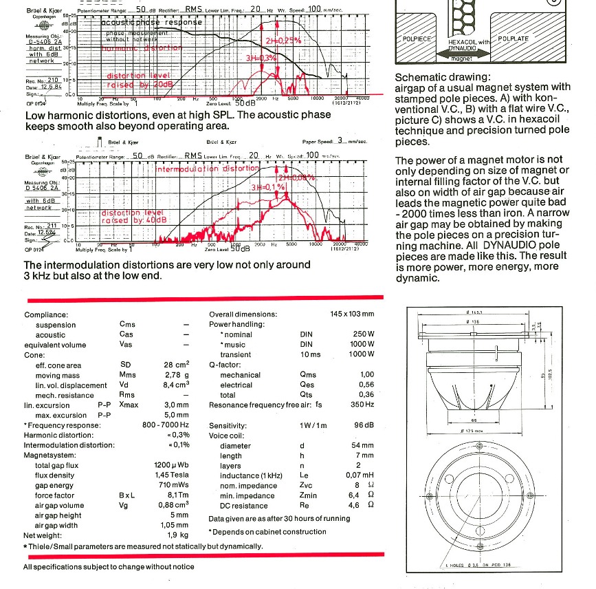

D54 is excellent. I've used them in various designs and they take alot of power with minimal complaint. You can't cross them as low as the specs suggest but it really depends on the filter slopes and how loud you play them. I prefer the D52 to it because of its flat face plate, which is a little more neutral sounding. Not really that big of a difference between them.

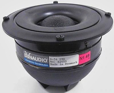

A very important thing to check for with any and all older Dynaudio dome drivers - VC rubbing. Buyer beware when purchasing any used or NOS units, as nice and pretty as they may appear in that pristine box.
To check for VC rubbing or buzzing, simply perform a low level sine sweep in the range starting around the driver resonance frequency up to at least 1k. It will usually sound like a clipped sine wave or kazoo sort of sound. These mid domes (and tweeters) commonly suffer from misaligned or shifted VCs, causing the windings to contact the pole pieces. This is mainly due to the tight VC gaps they run, making the assembly process very critical. When these units are assembled, they're often completed before the adhesives and dome coatings had time to fully set which resulted in the dome / VC to settle in at a slightly skewed alignment in relation to the gap. Sometimes its just a matter of age or mechanical dome sag from the coating deteriorating over time, causing the dome to tilt slightly along with the VC.
This is such a common problem that virtually 1 out of 2 drivers will have a buzzing VC, so make sure you check the seller's refund policy before forking over a large amount of money for that nice shiny NOS driver in its original box. The buzzing can be harder to hear it with music at lower levels, so you'd assume or be told that its not a big deal, but running the driver this way will eventually cause the windings to fail or short, constantly rubbing on the upper pole plate. I've seen some of these older Dynaudio mid domes command crazy amounts of money, including the higher end Esotar and Esotec drivers, so be careful to do your homework before buying them. In all honesty, there are quite a few equal tiered or better mid domes out there which are less expensive ie. Bliesma, Morel, etc. Dynaudio can and usually will repair older units for you but its not cheap and you have to pay for shipping and customs fees in and out of Denmark. I’ve on occasion repaired them myself, but its highly tedious and is only an option if the VC is still in good shape despite buzzing. You're out of luck if the windings have burned and/or opened up.

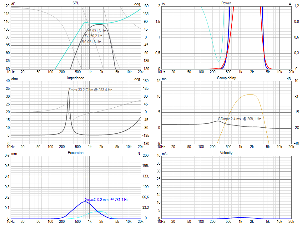

hi,
i've tried to search this thread for an answer but didn't find any direct response to my question.
what do you think about using S-S d7608 as open baffle midrange let's say from 800hZ with Lr4/LR8 XO up to 3-3.5kHz (crossed to t25 with waveguide)?
vituix/basta shows that xmax stays well within limit (0.2mm) and rated power is the limiting factor. not that i need full output -> i will listen to it from let's say ~1-1.5m.
maybe any other dome midrange with detached back chamber would be better option?

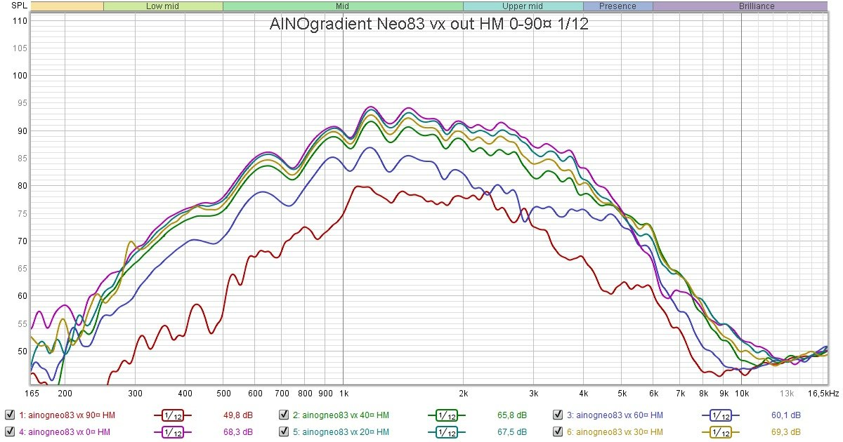

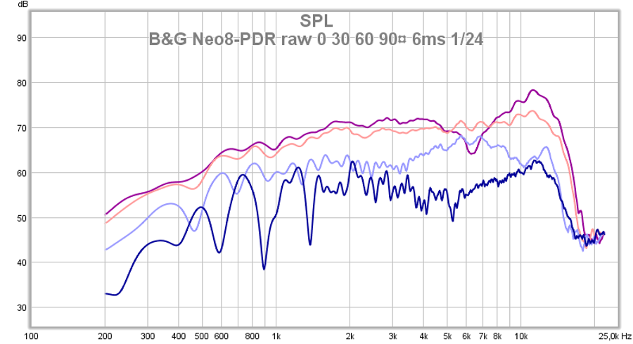

A magnetoplanar open back without baffle is the choice that I and many others have done - B&G Neo8/10 or clones. Exactly similar response at 0-90 and 90-180deg. Distortion below 400Hz is challengingha! this is the answer i was hopping not to read

Why do you combine a tweeter with waveguide to a figure of 8 midrange?
Why crossed so high? Speaker distance will produce vertical lobing.
The back side frequency response will be quite different cause the path and volumes are very different. This will strongly distort your figure of 8 behaviour.
You would need to work with the driver to get the same response on both sides. And then the other questions still remain.
Yeah, I do too. My initial positive response was to the novelty of the idea, but no question the huge problem is the rear response would be very different -- much worse.I see plenty of problems with this idea.
Look at transsection and photos from the backside. Round 3cm deep cavity means strong standing wave mode and sharp diffractions in upper mid-treble transition freq. Compare how different response is above 1kHz, including directivity. https://hificompass.com/en/reviews/bliesma-m142t-6-7-textreme-dome-midrange
Hificompass measurements were done with the speaker installed on an IEC baffle (very wide), thickness around 20mm. So dipole effect (loss and axial nulling) on response is missing. https://hificompass.com/en/speakers/measurements
Actually it is very difficult to create real dipole pattern above 3kHz with any kind of combination of mid and tweeter - except with planars in minimal baffle..

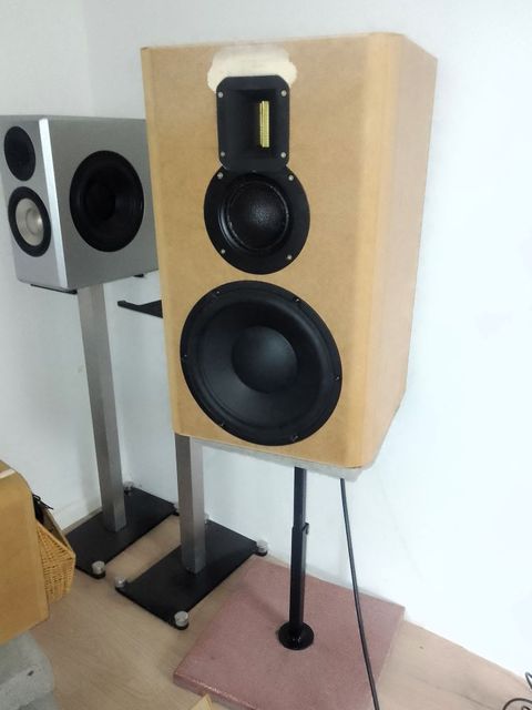

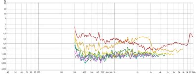

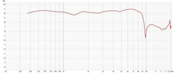

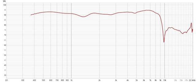

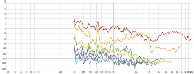

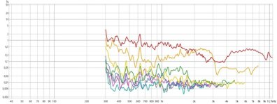

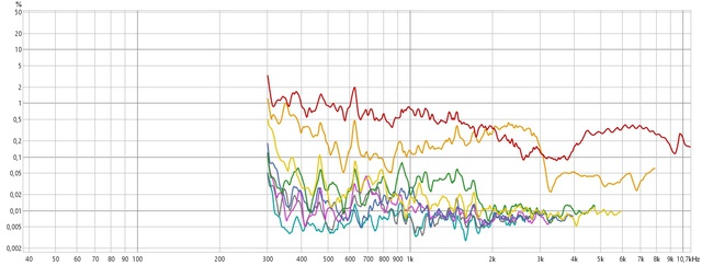

hello,
I came across this forum while looking for more dome midrange drivers.
I thought I would share my experiences with the HiVi DM-7500.
Using it in a three way combo with Fountek NeoCD3.5H and 10″ SB26SFCL38-8 (closed).
Currently still active separated at 400 Hz (12dB) and 4000 Hz (18dB)
The combination of ribbon and dome works brilliantly.
Even if the distortion of the Hivi seems somewhat increased.
If you opt for the HiVi, it makes sense to invest more in the bass than I did. The bass is deep and linear but you get a lot of distortion for free at this low price. Here are a few measurements.
Unfortunately I can't find the original pictures right now but the size is still sufficient.

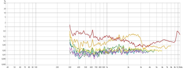

1V
2.8V
5V
The peak in distortion at 630 Hz is only present in this dome; the other dome does not have this.
It is a prototype, but reducing the distance between HF and MF was a good decision for vertical radiation.
