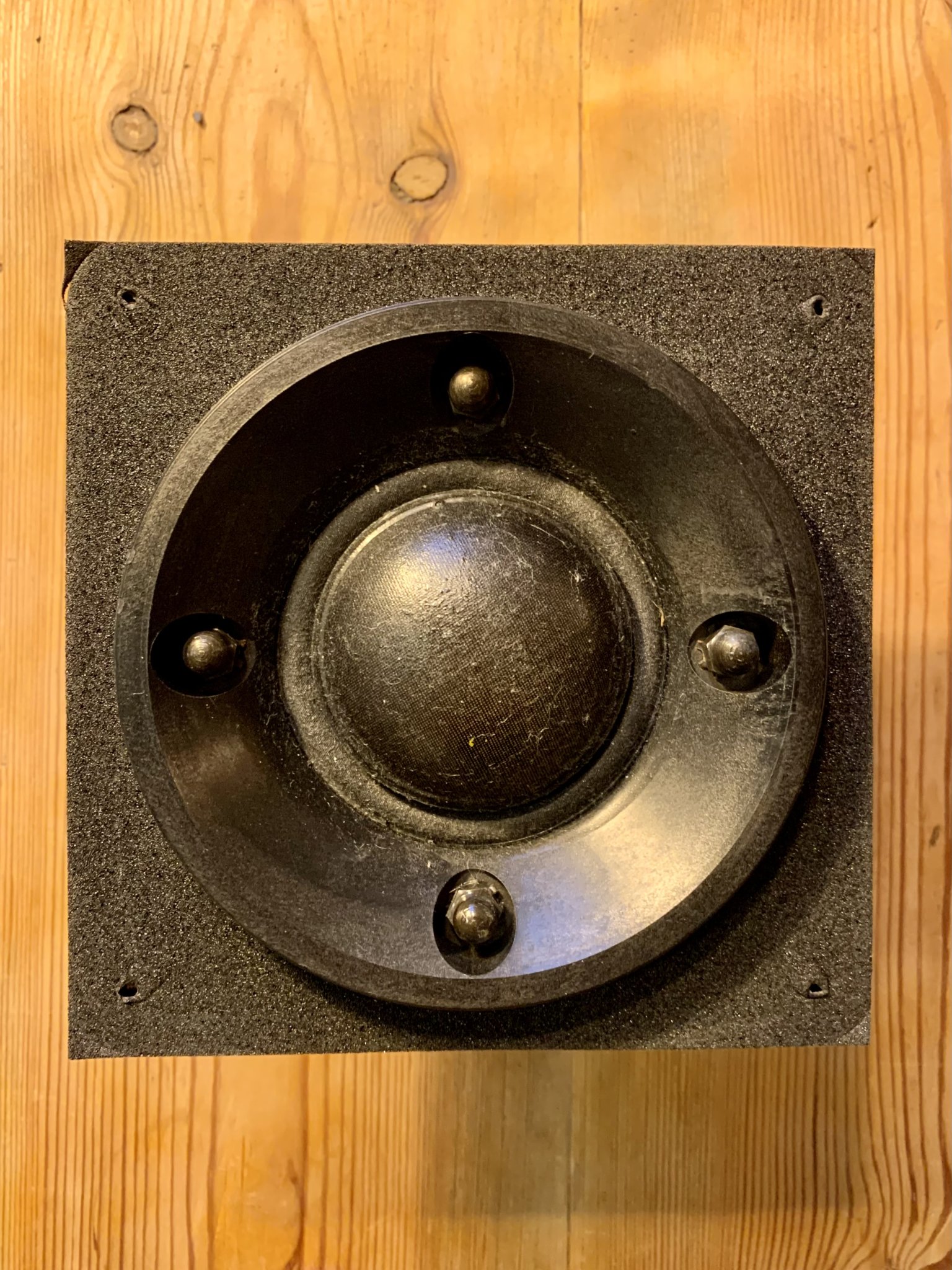

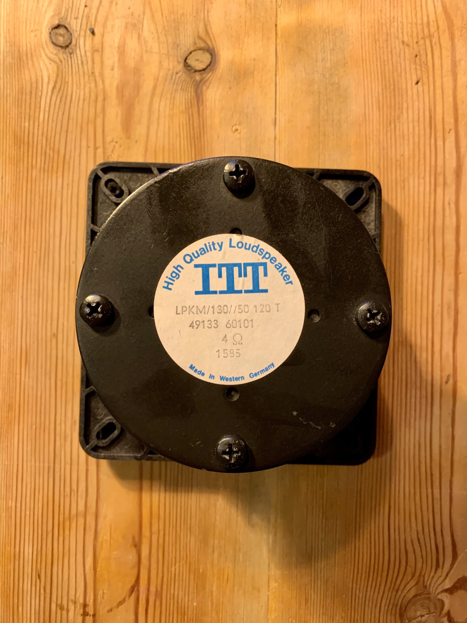

Maybe ITT middome, after 50+ years is still in top 3 of best middome ever made?
A good friend gave me one several years ago. It was in MINT condition. To young I was and didnt realize some day dust would get to it. Well.

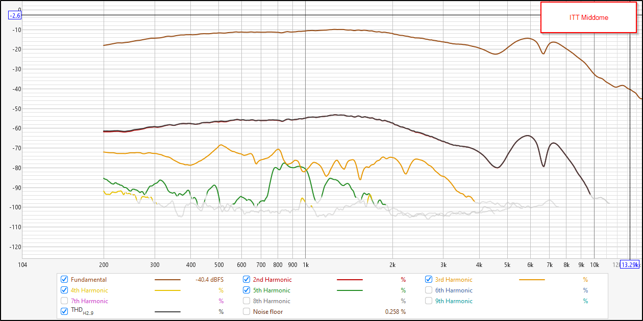

Here some quick nearfield measurements with Umik1, wire held with hand to the posts etc. My setup is not calibrated....
To my ears it sounds VERY good with no filter applied at all! Not light either. Tips the scale at 1.6 kg.
Some photos:
I can confirm it's an excellent driver - still, even after that many years!
That's the problem with vintage drivers, their performance depends strongly on the condition it's in. I don't mind that much about optics but there are tons of drivers in extremely poor condition and the seller still expects you to pay for more than mint condition ones. I'm very, very careful when buying vintage drivers. Not because they are bad but most of them have been handled really badly, stored in catastrophic enviroment or have been abused horribly. It's worth remembering what the average amp back then put out and how modern drivers often do not sound better but are able to cope with much more power and abuse.
