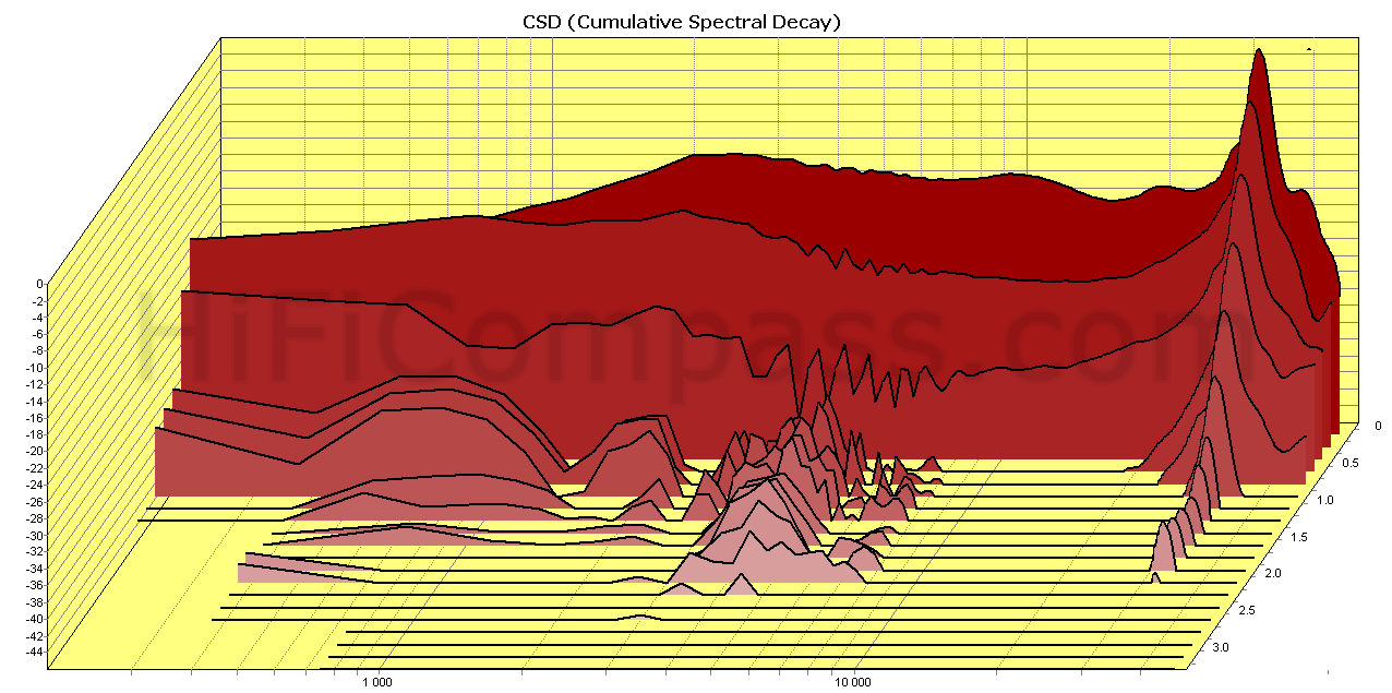

Here is a different - still crude- waterfall of the same driver: uniform/flat SPL= clean waterfull. SPL unevenness (even when very small) : ridges.
A smooth FR can still have long decay in it.... The FR is relatively smooth in the area with ringing trouble. Then again I don't know if this has been smoothed.
FR can be flattened and will look good on paper, but the CSD will still have the same issues. FR can also be measured closer than 1m. There are quite a few drivers which show poor FR and have rather clean CSD

@camplo In that first example, it looks to be a Be dome tweeter based on the breakup frequency. In some cases you can linearize this and it will be neutralized to the point it won't ring (in linear time domain), but when the driver plays this frequency after the EQ notch is applied, there still can be an extended decay time not proportional to the other frequencies. In this situation, it takes longer for the diaphragm to settle down compared to the pistonic diaphragm movement.
In the case of this driver, when playing the specific breakup frequency after EQ has been applied, the diaphragm will now have even FR, but the diaphragm motion will be non uniform, still breaking up and moving around in an out of sync way, just as before EQ was applied. The EQ doesn't fix the diaphragms physical behavior. It just flattens out the level at breakup.
So now, being the diaphragm movement is still out of sync, with breakup taking place, it will measure at a different level off axis, which shows why its important to also check FR off axis. If the response curve has the same shape off axis but at a collectively lower amplitude, that means the cone movement is completely uniform from a pistonic POV and the driver will exhibit the identical FR balance at any listening angle, just at a lower SPL.
It reality, it doesn't however happen this way, as the cone will radiate from a lower percentage of its surface area as the frequency increases. If the cone's internal dampening behavior were progressively linear in rate (ideally lossy), moving from the VC attaching point to the surround termination, the rolloff will increase at a linear, proportional rate as the frequency goes up. Driver output will then decline at a similar dB/oct rate without any breakup resonances taking place. Anytime there is a different shaped, non proportional FR curve on and off axis, there will be cone breakup present as various areas of the cone will move in different phase relationships to each other.
In the case of dome drivers, all this takes place in the opposite direction, from the VC perimeter to the center of the dome. The surround is just directly coupled to the VC and the center of the dome is subject to breakup, out of phase with the VC.
There is also the issue of the speed of sound in the diaphragm allowing the VC driven motion to propagate through the diaphragm material at very high frequencies, causing sharp peaks and dips on and off axis. In this case, there is little you can do to linearize the driver because the breakup isn't stationary in amplitude or frequency to the listening axes (plural of axis). Sometimes using a phase shield (covering specific diaphragm areas, typically the tip of the dome) can minimize the problem. In the case of a higher loss dome material, the problem diminishes, but so does the HF linearity. Drivers with deep cones have this type of issue as well and should therefor be avoided as wide banded sources. Large surrounds can also cause problems related to breakup, specifically low loss types and wider, high compliance surrounds.
All of this is why cone and dome drivers with centralized VCs will always have some amount of breakup. The best way to deal with this is staying out of the breakup area with the drivers dedicated bandwidth. Only much more shallow and gradual breakup modes can be tamed to the point they don't pose an audible degradation of the sound speaker's sound ie. no harsh resonances or peaks.
