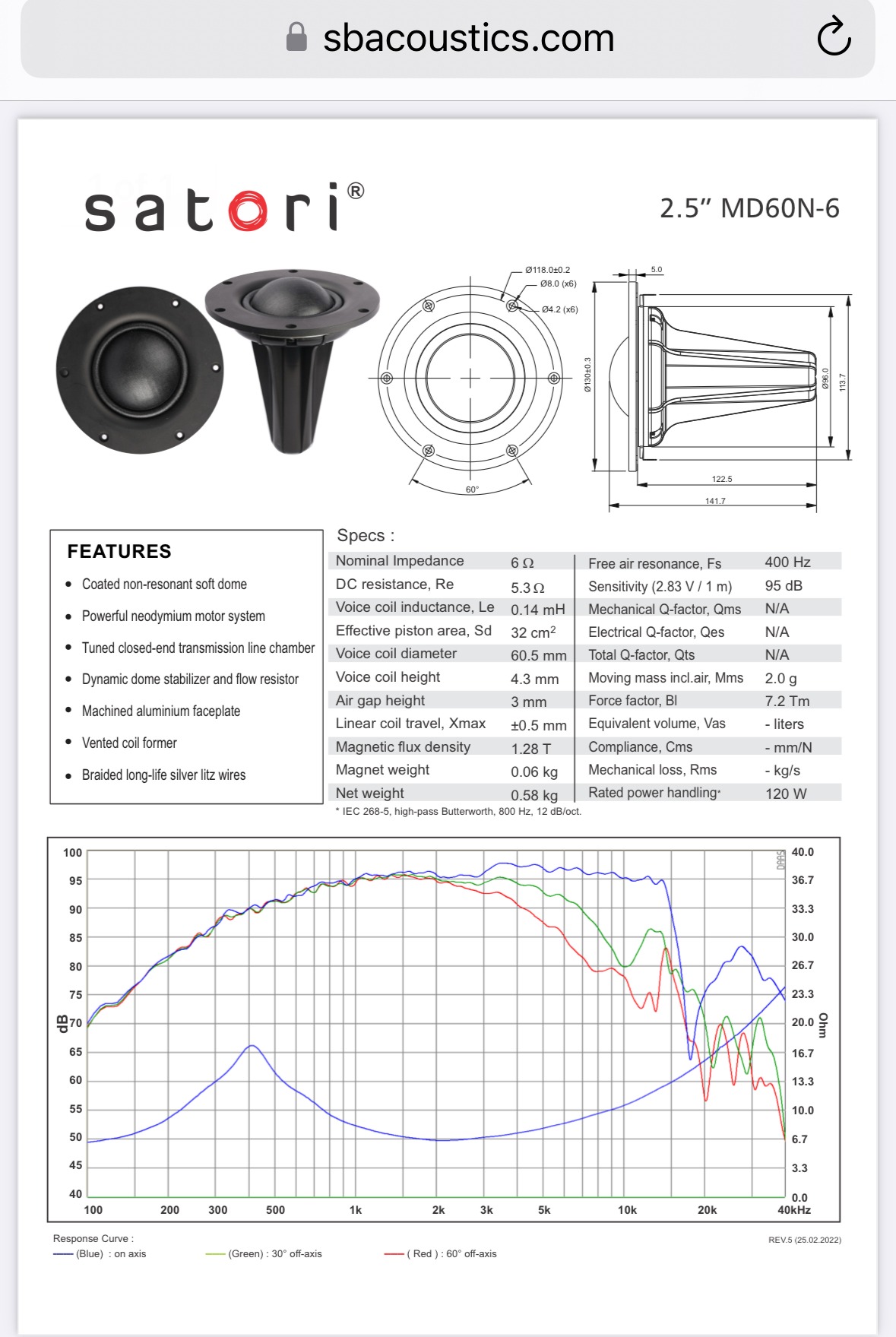

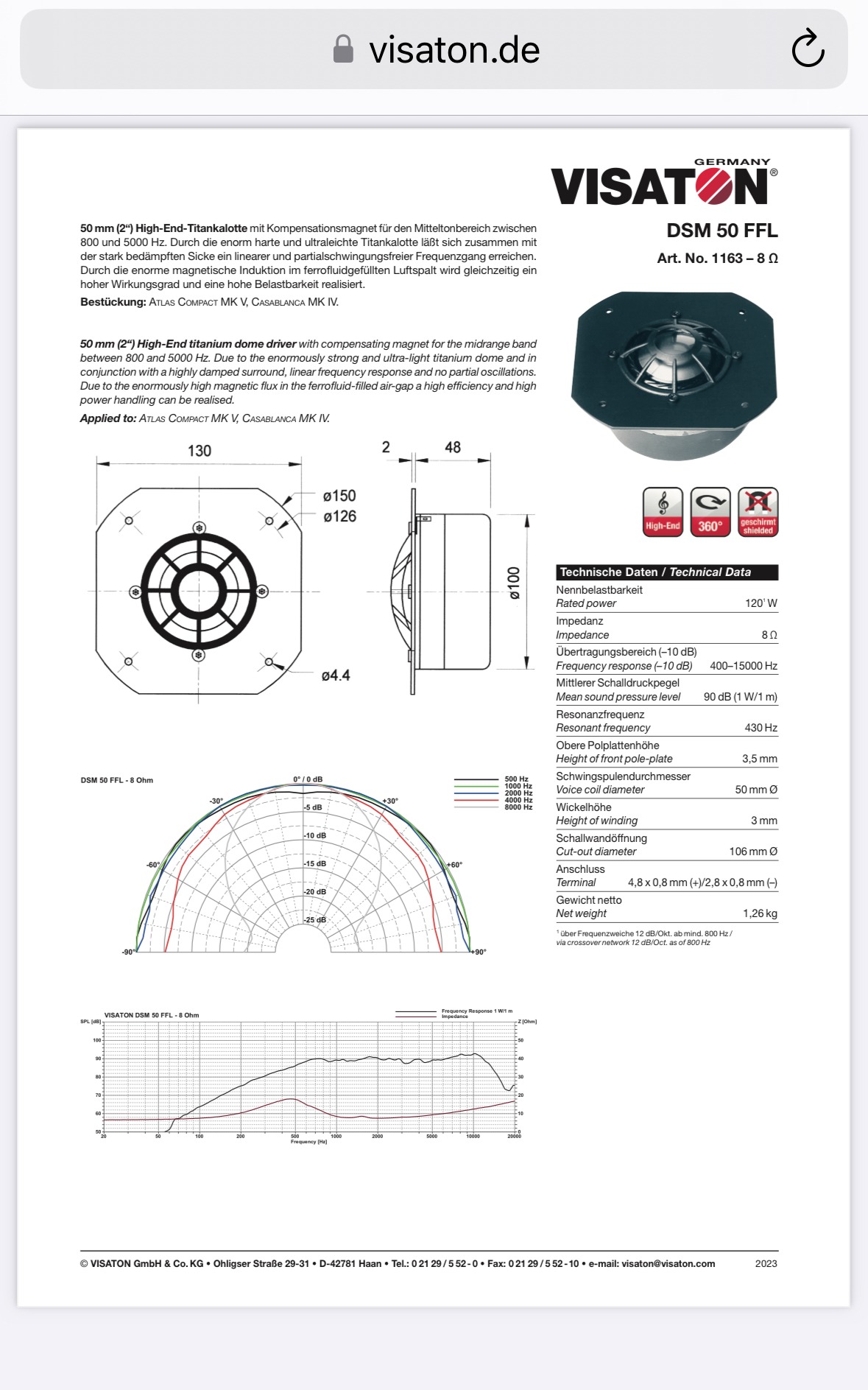

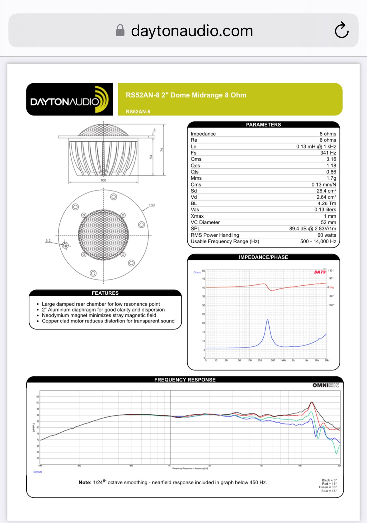

On the diy front l am going to compare a system using horns with dome mids in the upper midrange over the next few months.
This will be implemented using a removable support baffle in a JBL 4343 style enclosure.
The dome will either be a JBL 903Ti, a Visation, a Dayton dome mid or the Sarori mid dome.
An appropriate dome tweeter will also be used.
The crossover from the cone lower mid or the 15 inch woofer will be part of the comparison.
Some new compression drivers and wave guides will also form part of the comparison.
